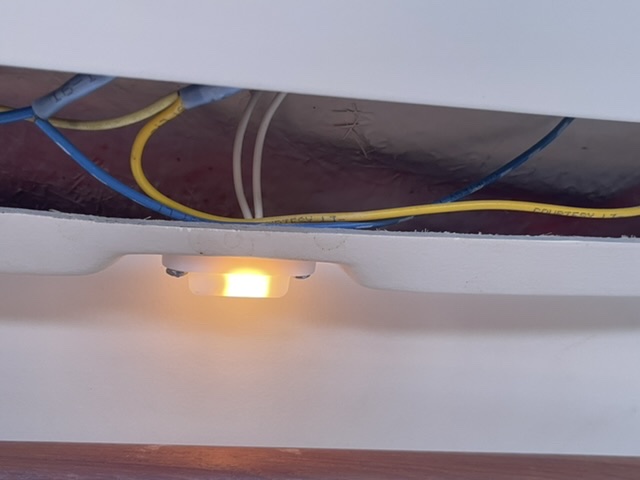

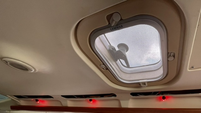

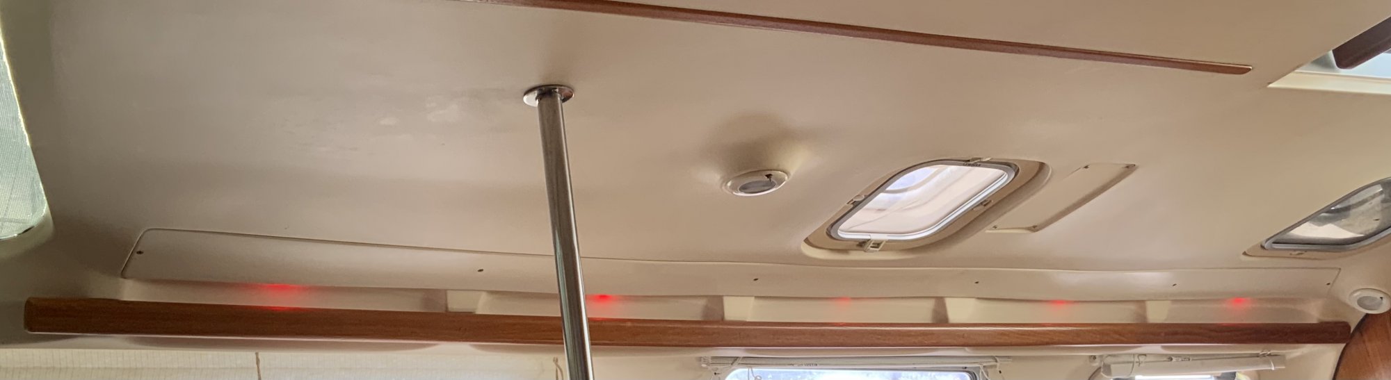

I completed this project over the summer. Turns out there were small white incandescent bulbs with a colored paint reflection casting the red and green hue. These were labeled “courtesy” on the panel.
I replaced all of them with sockets and dim red LEDs from Amazon. Reduced power draw from 50 wats to less that 5 and good dim red night lighting for the main salon.
Pics below of starboard side install over the galley. There is a similar set over the port side nav station. Both are connected to the same “courtesy” breaker.
Original light
Replaced with LED sockets and bulbs
Cover reinstalled.
