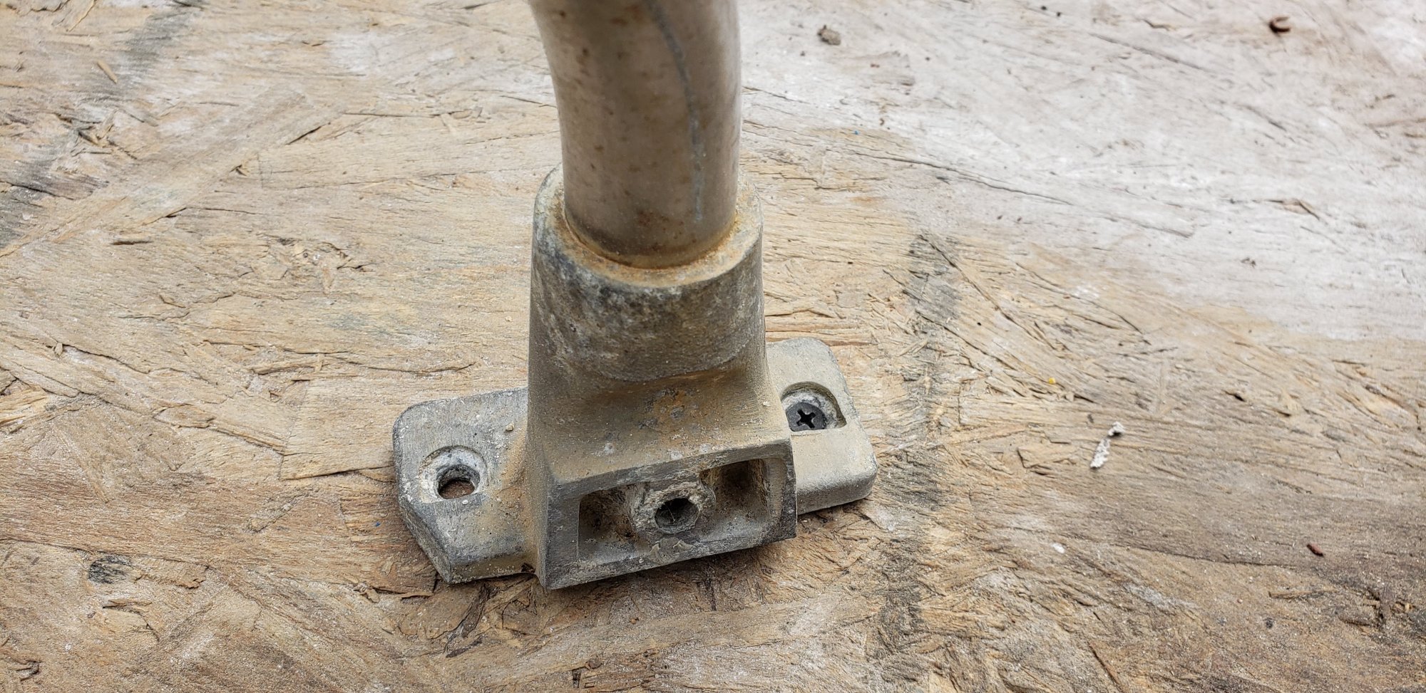

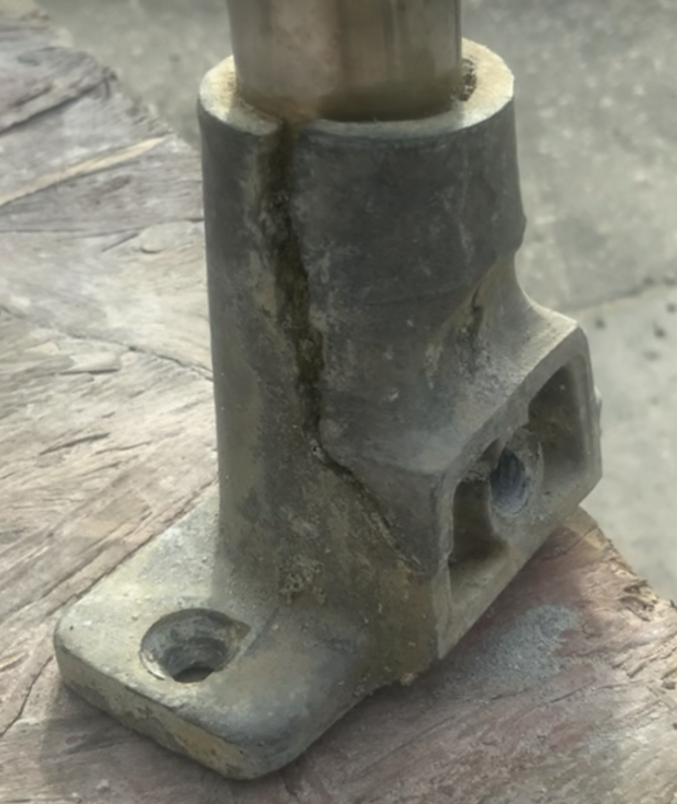

I have about 8 stanchion bases that are cracked or split. I found replacements at rig rite but cant see spending over 1K for 8 of these. Anyone knows another more reasonable solution. Trying to stay with a 2 bolt unit with toe rail screw.

Duh , I guess that would help. SorryView attachment 189085
No wonder they cracked. That's a terrible design! They need the extra bracing that comes with most bases to do the job they are installed for. I wouldn't replace with the same part. That's too much money for a $h!!tty design!

By looking at the picture provided i am guessing that the base has been through a lot more than normal use.
They are aluminum and are on the short end of corrosion
Have them on my boat and with some attention will last

Thank you for bringing these models to my attention. Most of them require 4 holes. I was aware of them but did not want to add 40 more holes to my deck. Wanted to stay with the 2 Deck hole design.
Actually, I thought it is a great design compared to the 4 holes ones that sit on to of the deck with washers for backing that came on my previous hunter.
It uses two existing holes on the toe-rail to secure it to the top of the deck, and in addition is secured to the vertical flat part of the toe rail with a 8mm bolt that goes through the base and stanchion. It becomes part of the toe rail. It will never wobble and compared to the 4 holes ones, will save over 80 holes that will leak. 20 units @4 holes per.
However, a stainless desing would have worked better. Aluminum corrodes too easily. They only lasted 34 years.

Just an update. Downloaded the Beneteau catalog and found the part. It is used in many models.
rigrite quoted 119.00 per unit plus shipping. Beneteau price was 26,00 plus 9.00 shipping.
New ones were anodized black, but who cares. At that price, i am replacing 8 of them. They lasted 30+ years.
