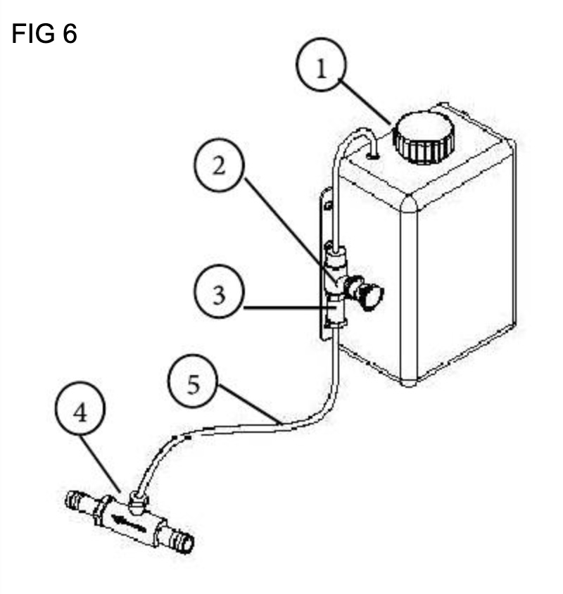

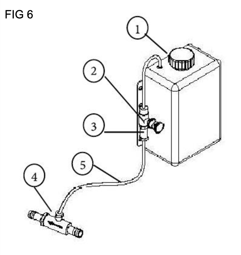

I ended up installing the KO2. I like it a great deal and recommend it.
I had one issue with the install. Item #4 in the pix below is a T check valve that sucks in the CP contained in the KO2 tank (item 1). The fitting where the CP comes in from the tank and the fitting on the downstream end of the T both screw into the body of the check valve and both of them leaked. I unscrewed them and gooped up the threads with thread sealant paste and all was well. I recommend that anyone who installs the KO2 does same before putting everything together.
