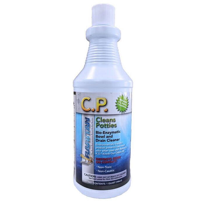

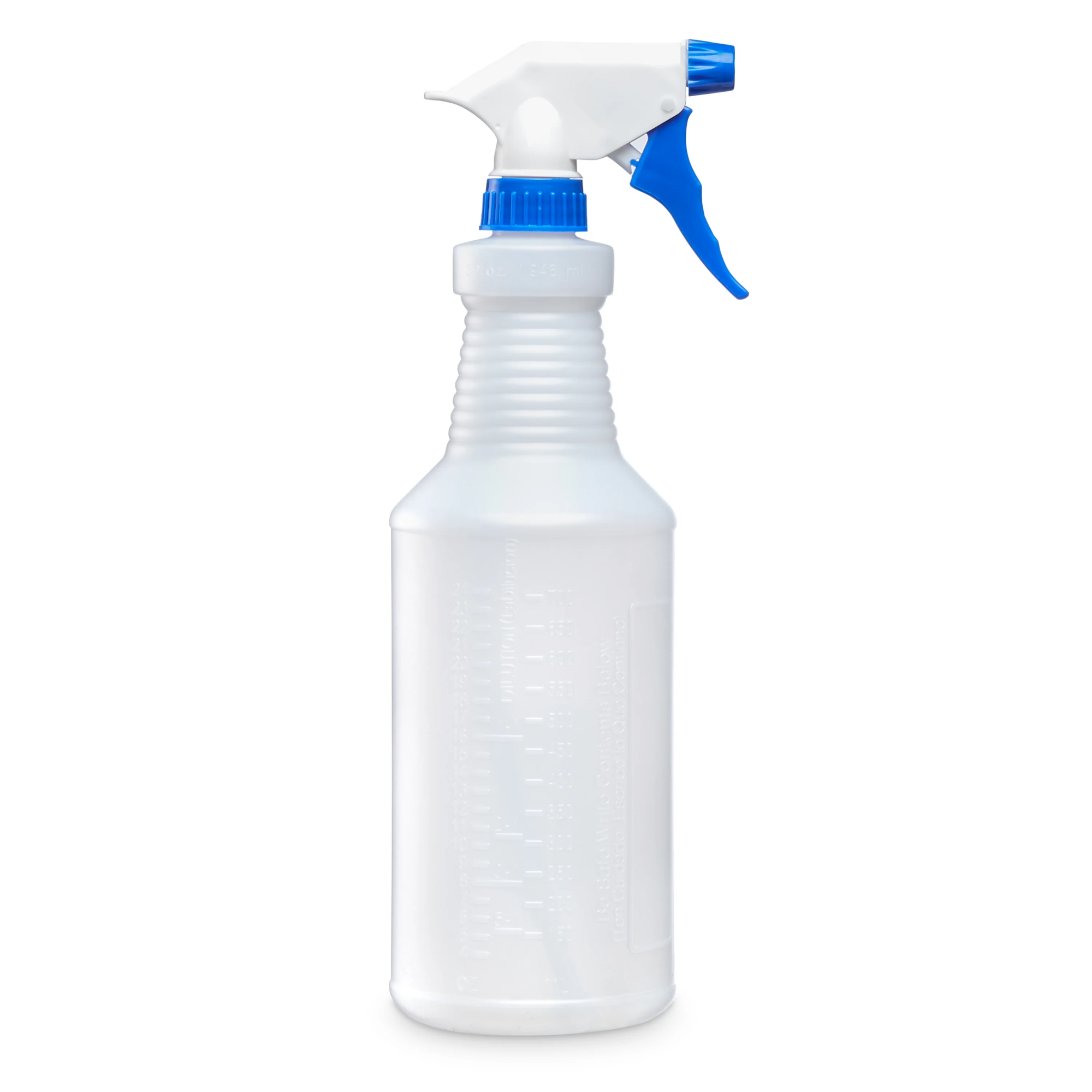

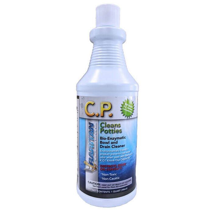

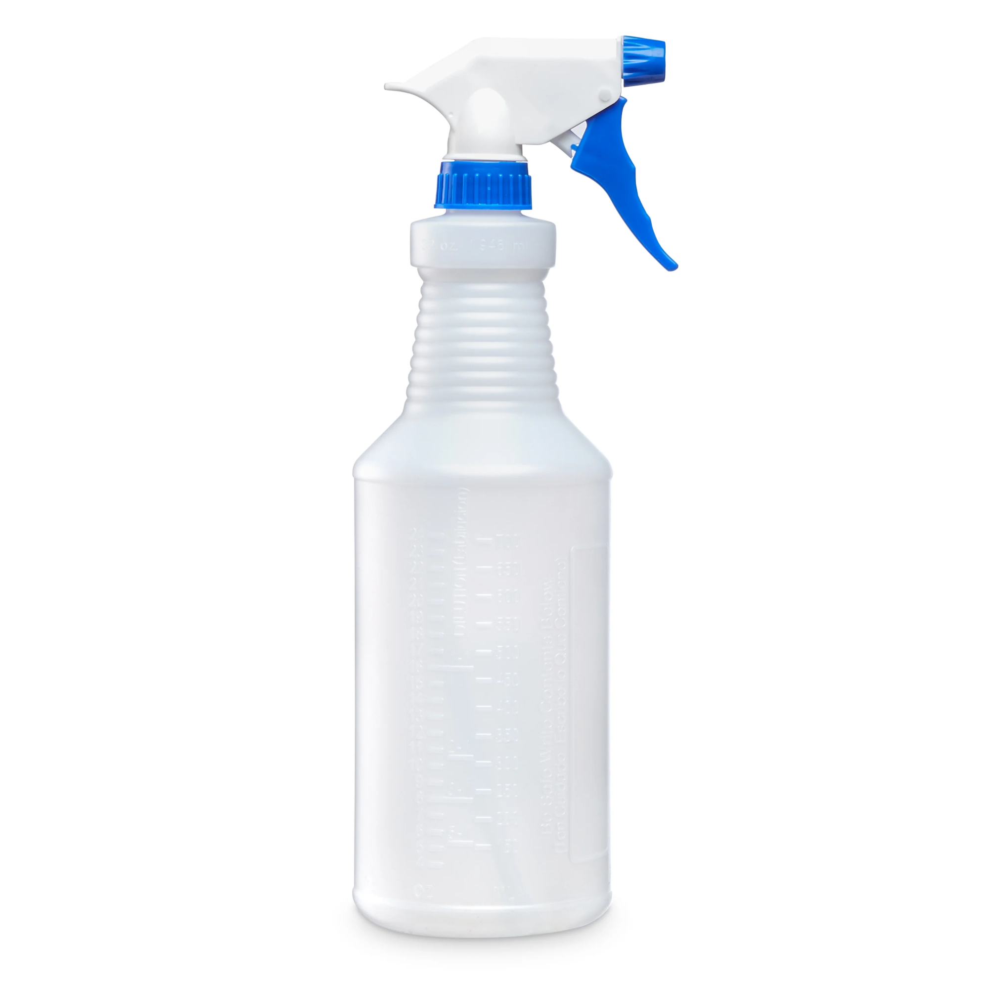

To each his/her own. This is my solution to the problem that the Raritan's kit solves.
View attachment 233753View attachment 233754
Alternative to Raritan Spray Kit
This approach does not get CP into the intake lines or the toilet bowl rim. That is, unless you have modified your system to be able to flush with water through the sink and you spray the CP into the sink before flushing. If I wanted a little CP in every flush that is what I would do. Not buy the expensive Raritan kit.
Totally agree. Depending where our cruising grounds maybe for any particular trip, we will use fresh from the sink in a cup to flush the toilet. The last thing we do is give 5 or 6 squirts of a mixture of Odorlos and water around the bowl before we close the toilet lid. If we are cruising in areas where fresh water is unavailable we still squirt with the odorlos mixture but will flush with sea water. The next time fresh water is available alongside I will flush both the anchor washdown system and the raw water toilet system. Closing the thru hulls when done.

Unfortunately, no matter what the source, anything that's just added to the bowl and flushed just goes through the toilet discharge line...it does NOT re-circulate--and you wouldn't want it to!--through the intake line, pump and channel in the rim of the bowl where it's needed.
To use the sink water as the source, just spraying it into the bowl won't work...you'd need to have the intake line teed into the sink drain line below the waterline to be able to flush using sea water...the sink drain seacock has to be closed to pull water out of the sink.
And fwiw, you don't need that much CP, either. Clean fresh water will accomplish just as much if it's used correctly.
