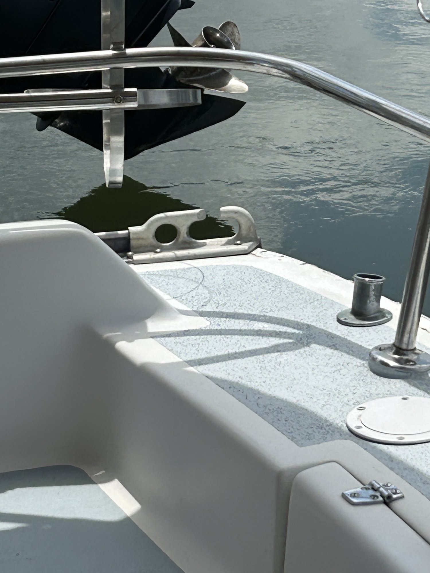

Hello dlochner,
Thanks for the reply. Here is a photo of the starboard side. The stern side is a mirror image.
Thanks again

That looks like a custom piece and will be hard to find.
I agree with Dave. You might find it easier to simply replace both sides with a pair that match. Every chandlery will have plenty to choose from. I searched: "Sailboat mooring chocks" which rewarded me with many results. Companies like rig-rite.com might be another good source. Good luck. but don't stress on matching that piece.. It will certainly not affect your boat's market or insurance value. It's not like a vintage car kinda thing.

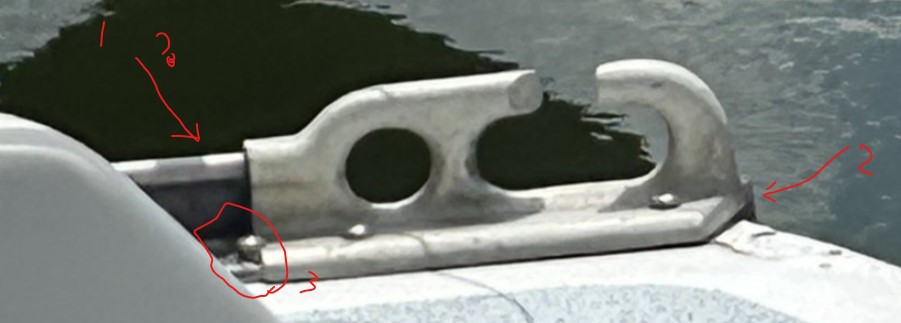

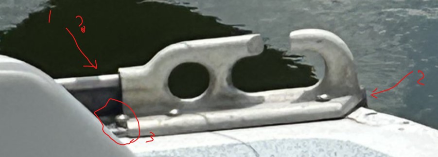

Looking at your fairlead - it is almost certainly a custom made piece. It looks like it may be cast aluminum. Do you know? Looking at your photo, I have 3 questions - indicated on the image.
1) What is this rod coming in from the side? And is it needed for the other side?
2) Looks like there is a flange going down the outside of the hull - does this go all the way around?
3) I'm not sure what I'm seeing here. Is this part of the fairlead? Some kind of alignment piece?
dj
p.s. one more question - what's the condition of the one on the other side? Totally gone? Broken? Got photos of that one?

Three D metal printing might be a way to do it.. There are some companies that will custom generate one... It probably wouldn't be cheap. It could be fabricated from some plate and angle.. again prolly not cheap..

Hello dLj,
The answer to #1 is the toerail.
The answer your 2nd question, that is where the wood starts that goes across the stern. You can still see some of the 5200 they used to glue it down.
No #3 is just part of the mounting hardware where the toerail meets the chock.
So the other side is broken pretty bad. It would not look right being installed.

Thanks for the clarifications.
If the other side has all it's parts, or at least you could reconstruct it well enough, you could use it as a mold to get a new aluminum piece cast. That's what I'd look into doing in any case.
You could try additive manufacturing, but that is a pretty big piece for that technology. I think you'd be better served reconstructing the broken piece and getting a replacement cast.
Or fabricate a replacement.
dj

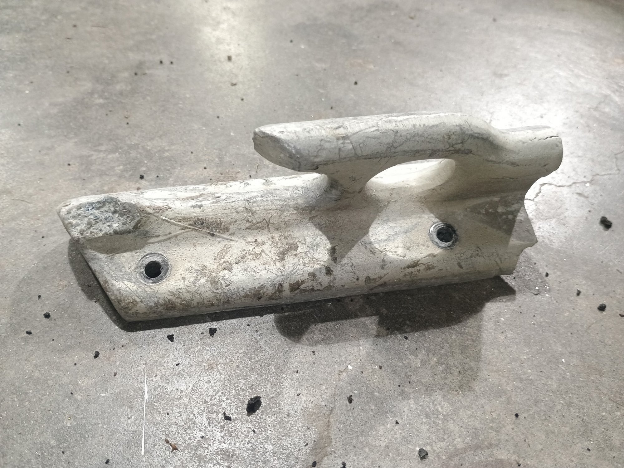

Here is a picture of the damaged original one.
