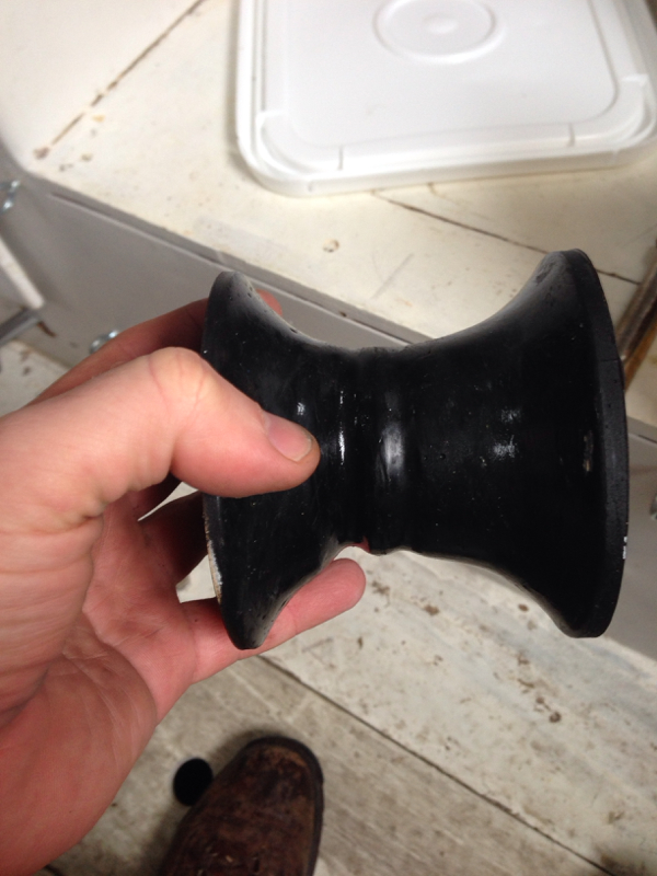

Hi All,
My anchor roller wheel is pretty beat up and doesn't turn well. I'd like to replace it.
The dimensions seem a bit uncommon. I've been looking online for a replacement but no luck.
4" diameter, 3 1'2" wide, 3/4" diameter inner hole.
Any suggestions where I might look? I can't find anything.
The roller itself says "AB Industries ABI". I think they are out of business?

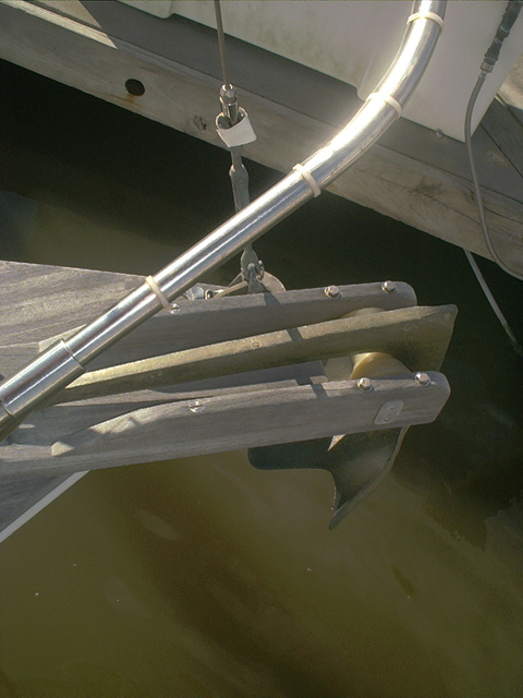

I used one of the yellow plastic rollers from a boat trailer. Had to trim the sides very slightly to fit, but it has held up very well
You can just see it in this picture
