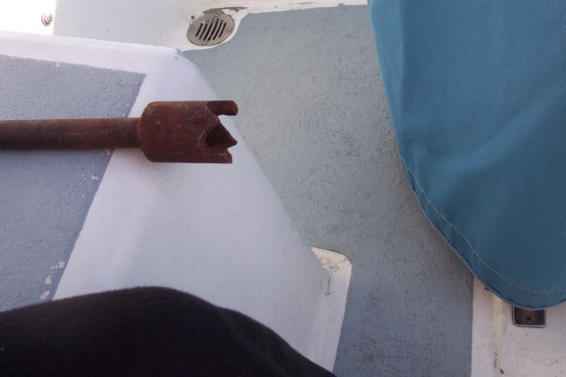

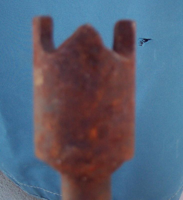

that looks right, but I have only the shaft coming out of the timing gear cover so I can't tell. my manuals and books are on the boat in sunny Louisiana and I am snowed in, in Kentucky, yuck! thank you for the picks

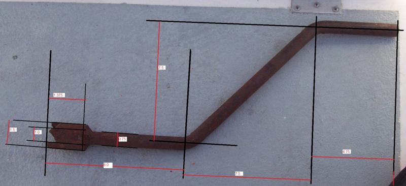

Does anyone have a Yanmar YSM 12 hand crank that the could post pictures of? Making or buying a handle is item 325 on the bug list for my H30.
