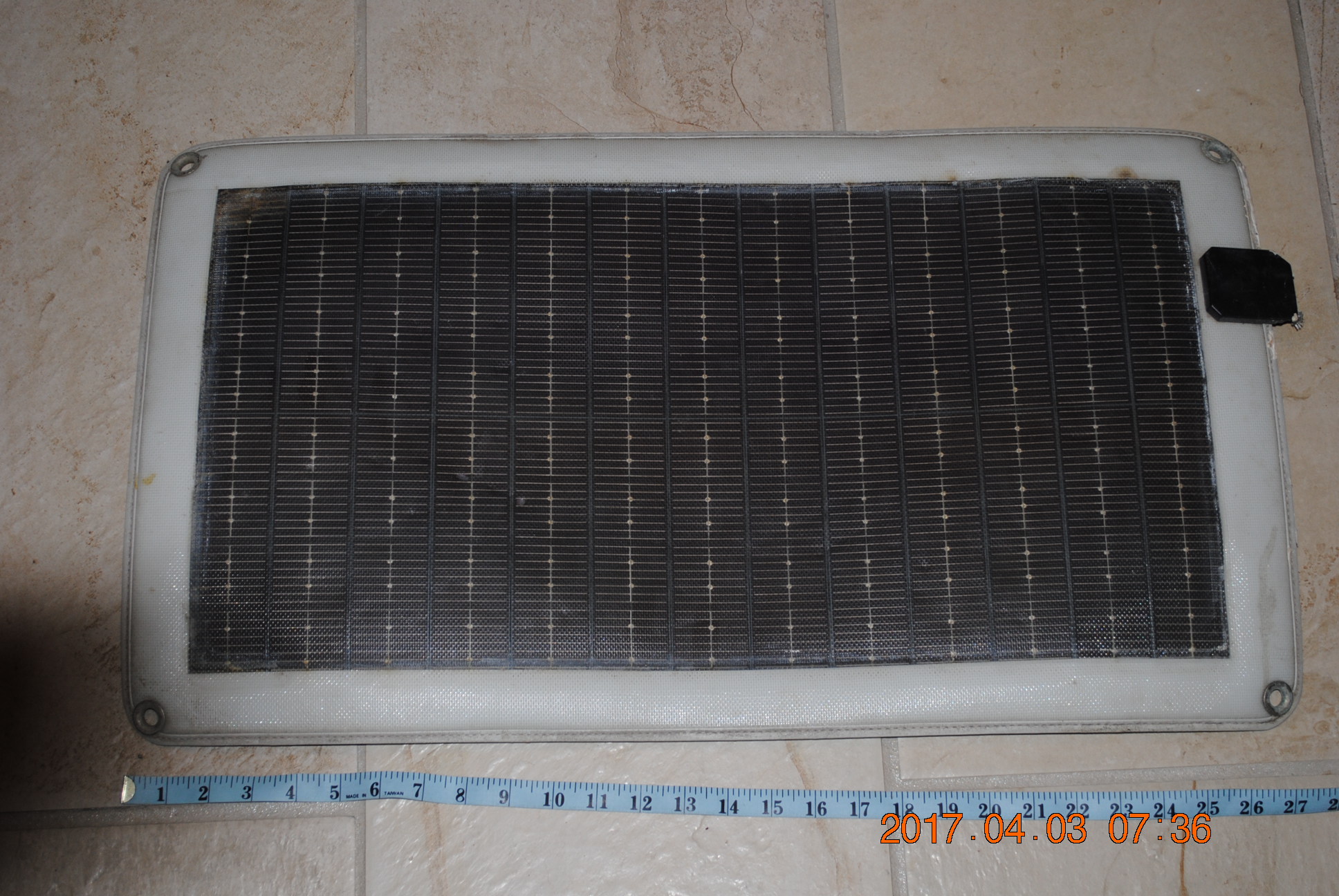

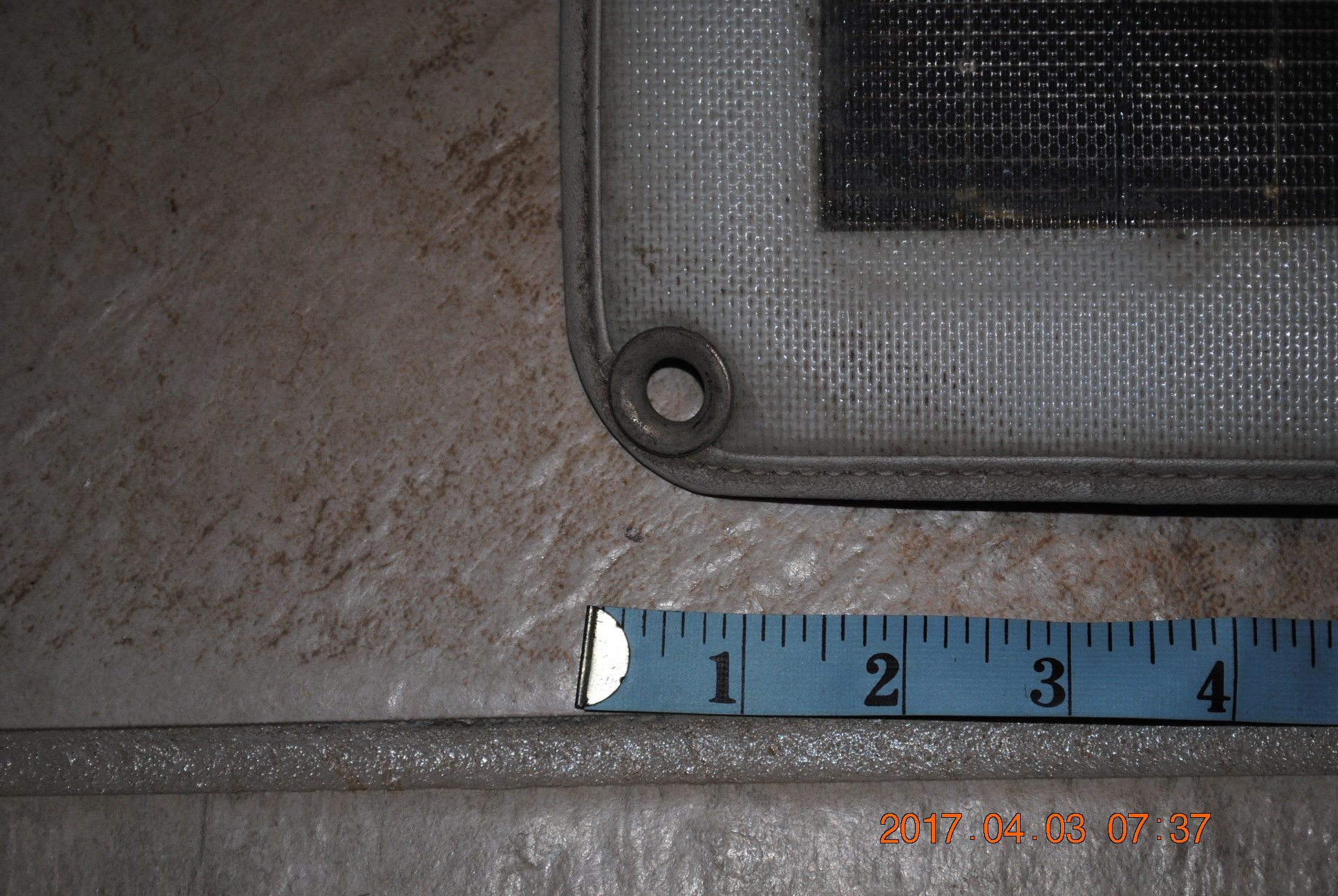

30 amp output?? from that little surface area?? Lets just say I'm skeptical. The old one could hardly put out 2 amps at 14.4 volts.
With that said I measured my panel and it is 15 9/16" X 28". The panel fits in the recess without much extra room. The radius on the cover ring would be approx 1.5 to 2.0"
