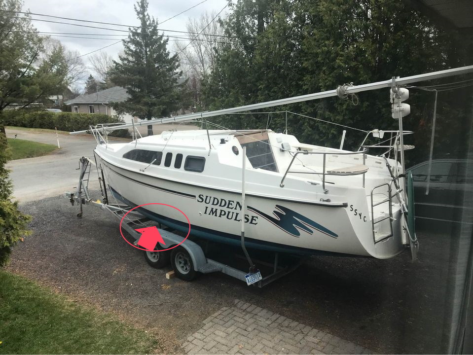

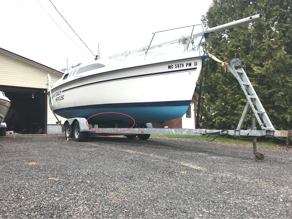

We drove 6 hours this week to look at a 26. The hull had delamination where it sits on the trailer bunks. The hull had 4 inches of deflection.
I contacted George from h260 Dot Com and asked him about it. He advised me to walk. We did.
Looks like the boat sold to some less wise sailor. Hopefully they can get a few more years out of the boat. Not a cheap issue to overlook.

Generally it would have been an issue with bunk board supports not being adjusted correctly. It would have been nice for a photo of that. I introduced every one of those boats

I know, I wish I had snapped one.
I consider it luck as I fell in love with the boat as I pulled up in the truck. The first thing I did when I walked up to her was inspect the hull at the bunk. I haven't been around boats in 20 years but had this nagging that the defection at the bunks was a bad thing.
4 inches deep trailing off to nothing for about 4 feet from the front edge of the bunk to the rear.
The seller said something interesting which I didn't catch at first, "Don't empty the ballast in your driveway, it makes a hell of a mess."
He may have been driving home with it loaded with water or left it for a long period on the trailer ballast full, causing the damage.
Whoever purchased the boat will likely end up here.
Actually, I've found the advert and can offer a photo but it doesn't show the issue as I saw it, when I saw it. The area I have circled was indented 4 inches at the bunk.

The genltman bought a Hunter 260 with heat and air, shore power,, roller furling, etc.. Found out I commissioned and sold that boat originally.
