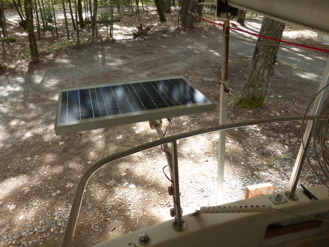

You must have a charge controller with the panel - the Genasun is a great choise (I dont think you need any more than the GV-5).
Any sort of shading - even what seems unimportant - does really bad things for the solar output. The only really good place on the sailboat for the panel is the top of the mast.. LOL.. second best is off the back. If you put the panel on your pop top cover and under the boom.. you just wasted a bunch of cash.
