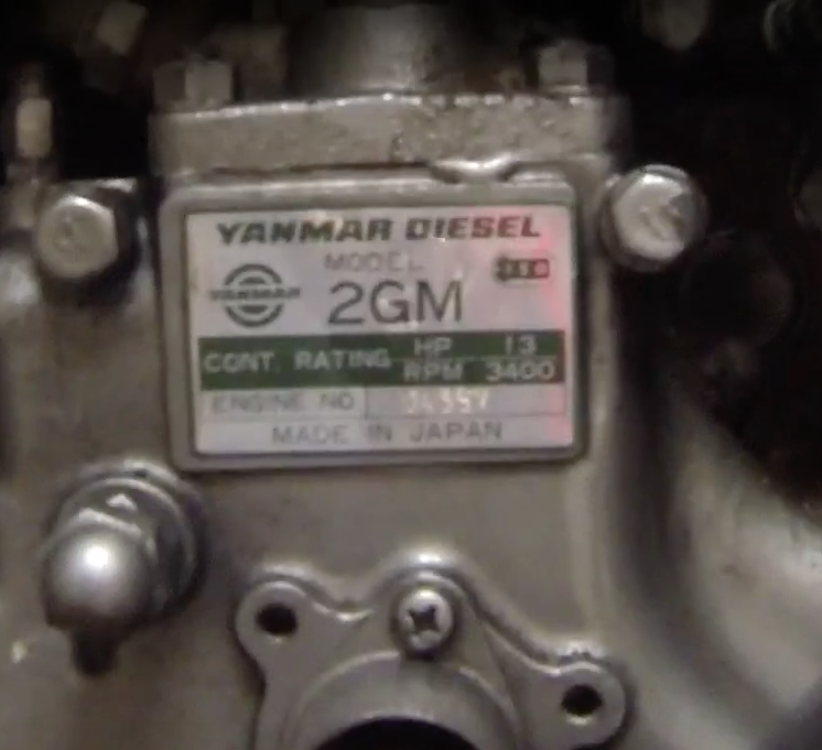

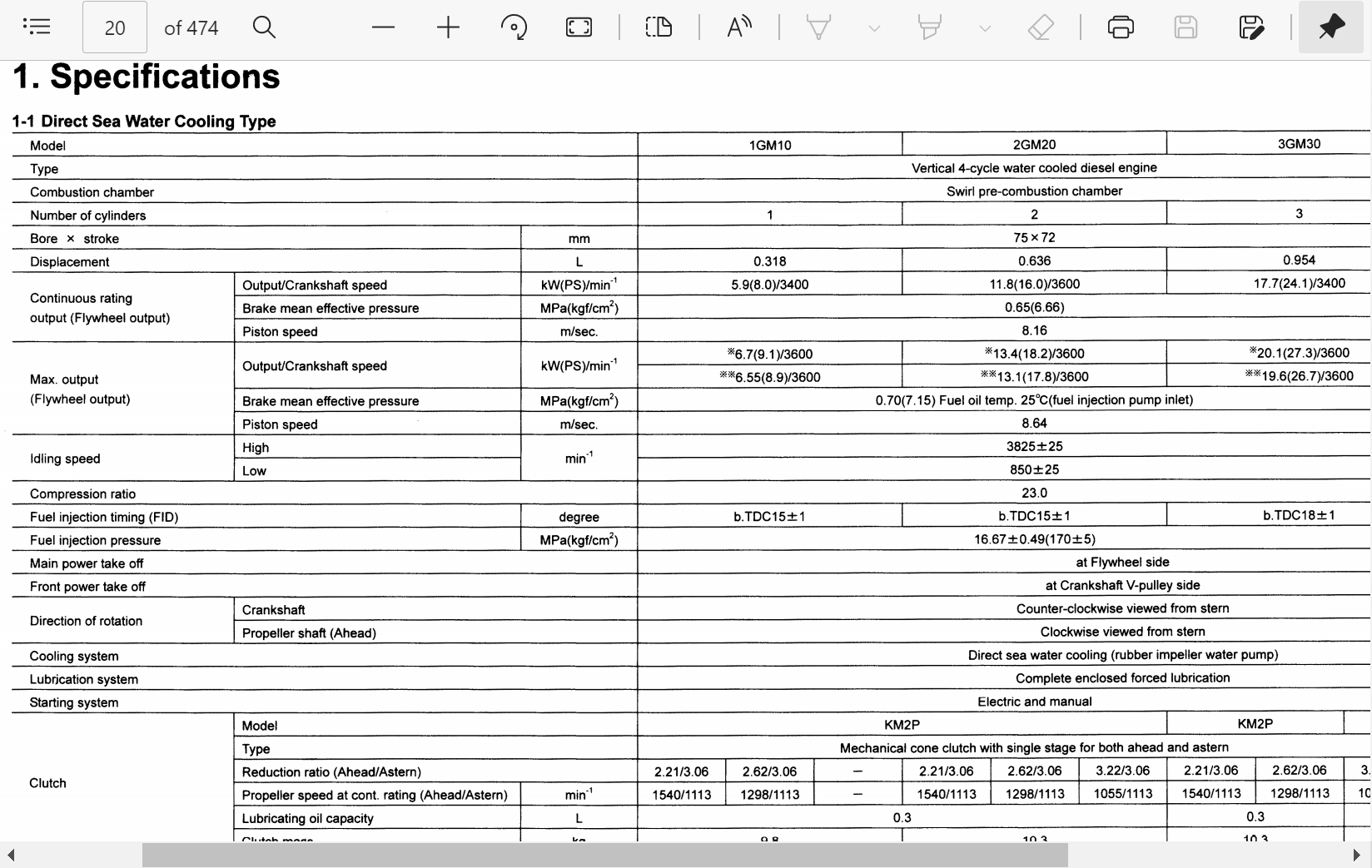

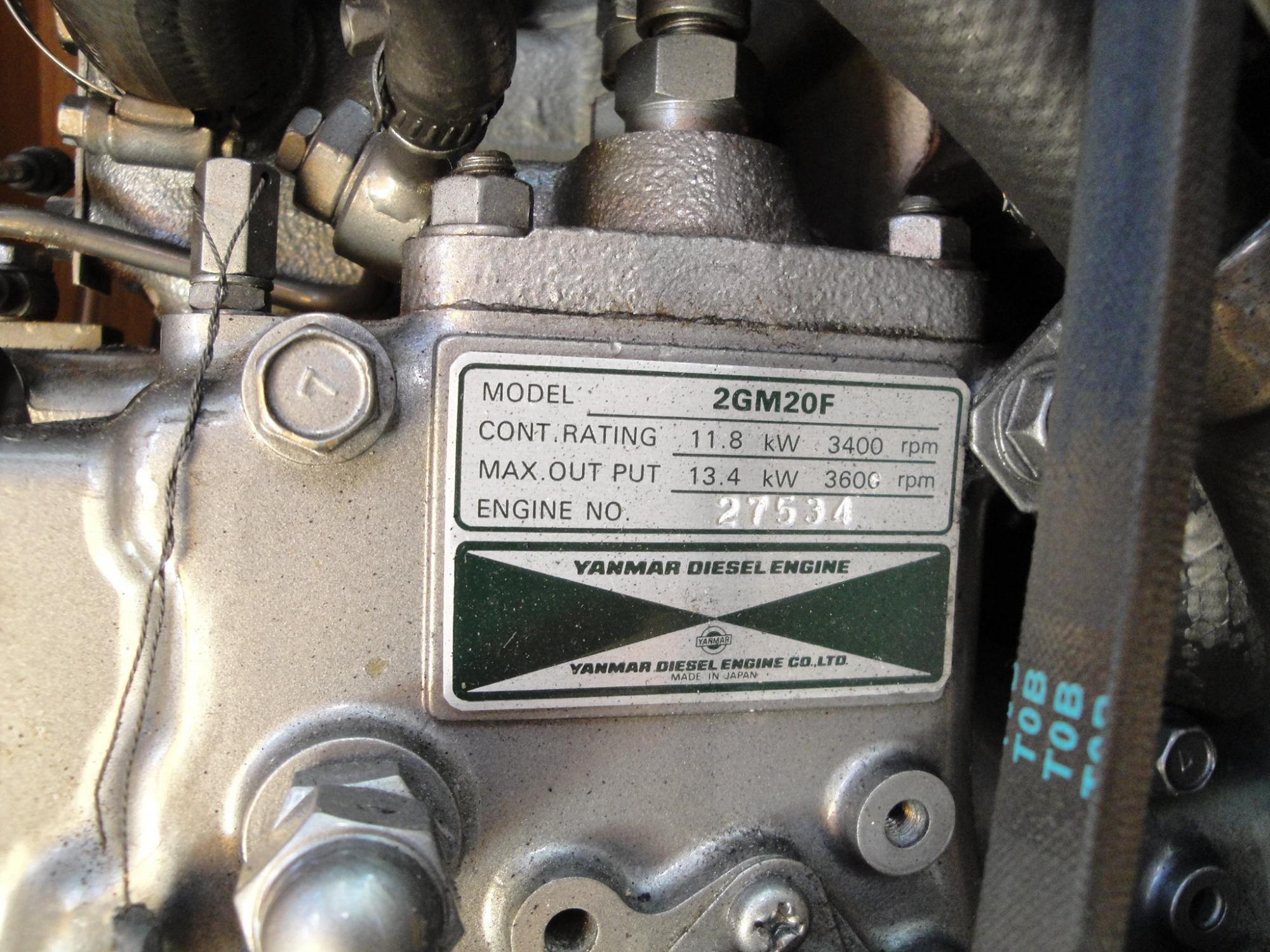

Jan 4, 2006
7,870
Had to do a little digging around as I have a 2GM20F, but, no such thing as a 13 HP Yanmar either at continuous or maximum rating.
The HP doesn't change from sea water cooled to fresh water cooled (antifreeze) as the block (displacement) doesn't change. Engines are always rated by their maximum output.
Check the name plate on the front of the block and number of cylinders to be sure but I've got two nickels and a ball of lint that says it's a 2GM20F. The 1GM isn't made for fresh water (antifreeze) cooling according to my shop manual.

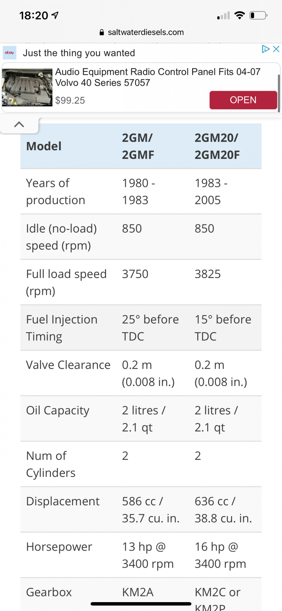

Jan 4, 2006
7,870
Sorry @MikeHoncho , missed your point that the engine is pre-1983 2GM? (13 HP @3400) as opposed to a post-1983 2GM20? (16 HP @3400).
Boat is a 1981 Hunter. Kind of makes sense that the engine would be a pre-1983 engine.
Dec 28, 2015
1,946
There can be confusion with people calling the 2gm20 a 16 or a 18 ho engine . It is the same engine with ho ratings at different rpms
