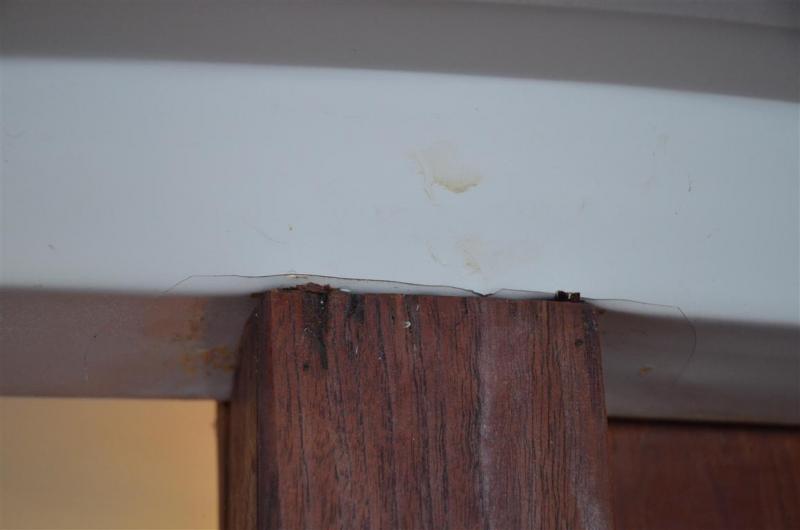

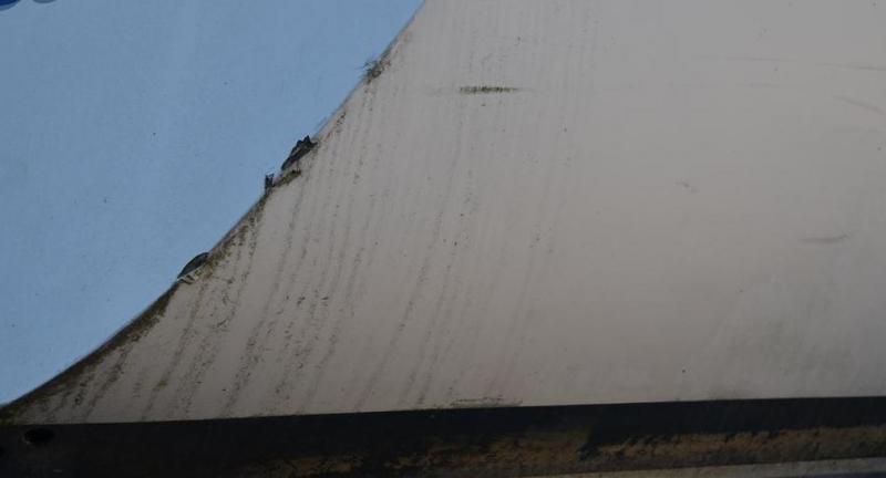

OK I am looking at an 84 Hunter 31. It is not in great shape, but not terrible either. The price looks like it may be had quite cheap as it has been on the hard for 2 years and the winter storage bill will be coming due very soon. There are a couple of issues that have me concerned. I am looking for a bit of a project boat and plan to live aboard. I have been looking for quite a while and have looked at several boats that I may be able to afford in a few years from now, but in the mean time I am thinking this might be a good boat to learn on and live on till I can swing the more expensive boat. It will also help me make a more informed choice on the next boat as I will really know what I want. I owned a 40 foot house boat about 20 years ago, so I understand the maintenance on a boat in general. Here are the 2 issues I am not entirely sure about. first is that the compression post has been replaced but the deck or cabin liner seems to be a bit compressed where the compression post is. I am not sure how big of a repair it might be and how urgently it needs to be addressed. The second is that there are some chips in the chine on the stern. They are not bad, but will be filled before launch. Any suggestions on what else to look for?

The cross member is probably rotten and the compression post is likely to be in the same shape. There may also be some rot in the bulkhead (check for discoloration). I would guess that you are looking at $3000-$4000 for a proper repair with an alum or stainless post and recovered with teak to look original.

Is the second photo the stern with chips?
10,256
The wood inside the cross beam over the compression post is rotting due to a leak in the mast step. This is not a trivial job but requires removal of the compression post and mast to be done properly.. The transom chips are cosmetic due to hitting things like docks.. If you search this forum using "Compression post" I think you'll find a lot of info on the compression post and cross beam job. The one in the H-34 is essentially the same. The anchor points for the chainplates should be inspected. These are the places inside the cabin where the big stainless rods are screwed in at their lower ends. These are a big job to repair if they are very rusted. Another one is the ring on the steering pedestal just below the compass . This is the ring that has the shift and throttle levers in it. If that ring is plastic and cracked, the replacement is expensive and a tedious job.. The old gate valve through hulls should have been replaced with bronze quarter turn ball valves. If there are gate valves, plan on careful inspection for function or replace them.. That can get pretty expensive. Carefully check the propeller and shaft support strut for electrolysis.. If the bronze is getting pinkish, it may be time to replace.. Those are the kind of normal problems that come to mind .. Inspect carefully and adjust price as necessary.. Do get a good professional surveyor to look it over.. Good Luck !!

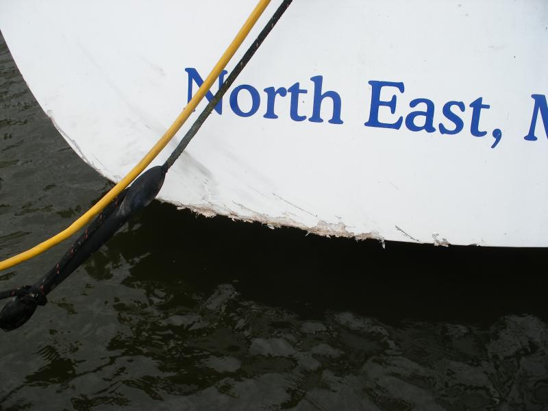

Kloudie addressed your compression post question in detail. Here's an answer to your transom edge issue. Kloudie also covered almost all the other issues to be concerned about. One last one is that the opening and fixed ports need to be checked and rebedded if there is even a slight sign of leakage. All hatch screws need to be pulled and rebedded too.
My H34's transom edge was damaged in a storm earlier in the year by getting blown against a floating dock when a bow line failed. The surveyor who looked at the damage (see pic) said it would take submergence for an extended period to absorb enough water to do damage. He said to use the boat until the repair is authorized and done (full grind-out and reglass). Yours look like typical edge dings that can be addressed with some filler and gel-coat. Not nearly as big an issue as mine.
The H31 is our H34's little sister. You'll find it's a great boat to sail and enjoy!

Dan, ouch... looks like a shark was nibbling on your stern, at least you did not have to say "we are going to need a bigger boat."
