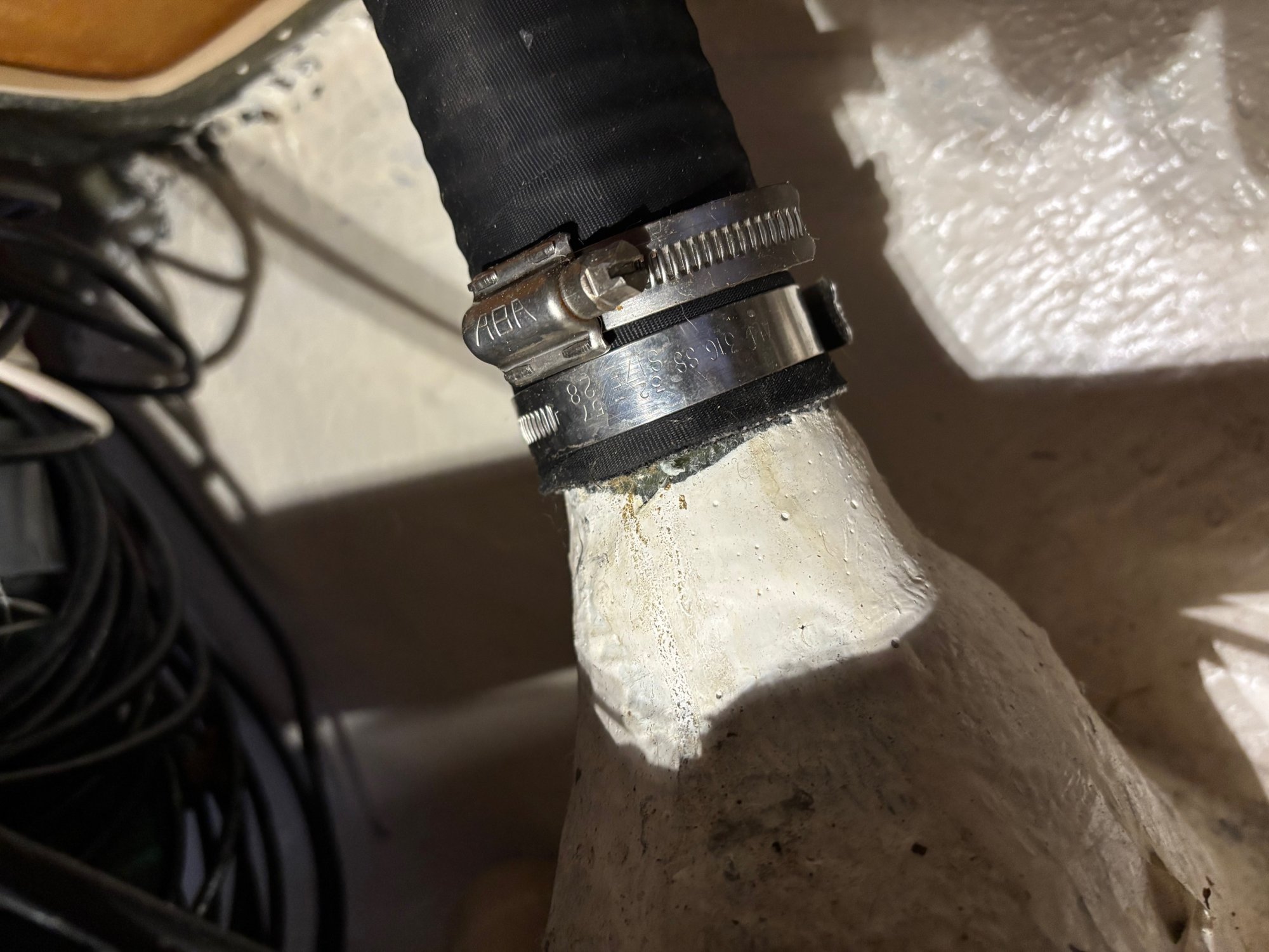

Thank you for input. I bought the 82 Catalina 25 swing keel and yes it will need work but at that age it should. Along with the many other items the keel lifting mechanism is high on the list. Everything looks in really good shape but access to the turning ball is still a mystery (as does finding the teck tip on the subject). It is on the trailer so I can remove the hose from the fiberglass. Is this ball mysteriously hidden under the hose. I would like to know its condition.
Any tips would be helpful

I worked on an 84 C22 once. The ball was under a cap or something where the cable enters the assembly. It was right after the winch and cap.

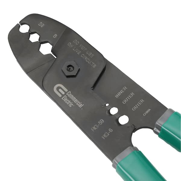

For closed body turnbuckles, I found that the end of these coax crimpers worked ok. Still, open body is much better in nearly every way

Yes, the turn ball is in the hose
