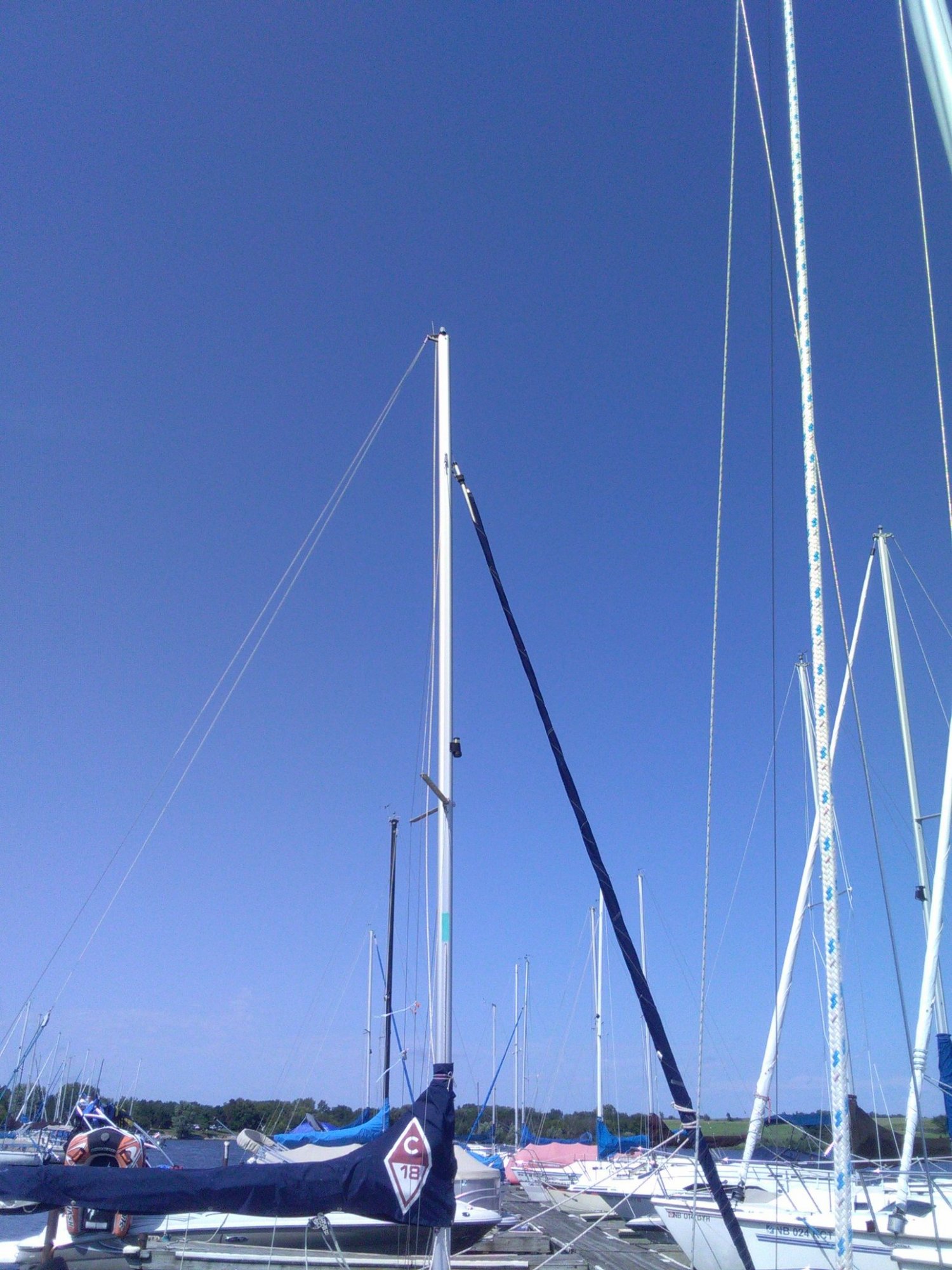

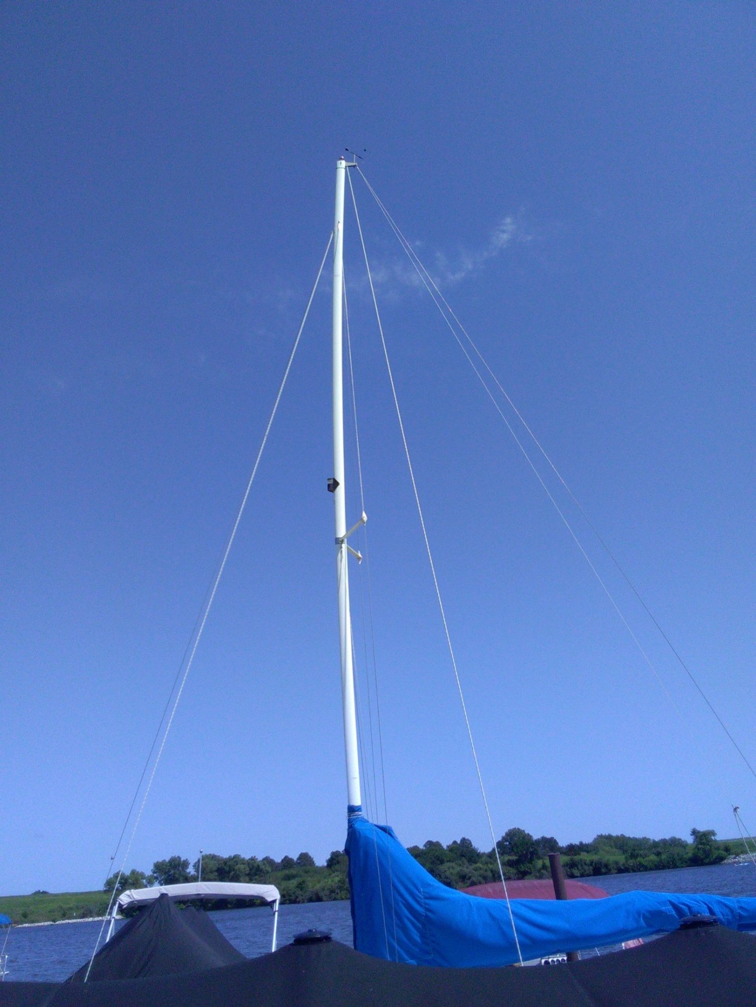

You should probably expect that hull to be capable of significant changes in direction on a moment's notice. Based on your second post, I'd offer that you get out and sail it a whole bunch before you start entertaining changing mechanical things. Check the rig against what the design docs suggest, mast rake and the like, and get some pictures of the setup and share them. This almost sounds like it's maybe more of an operational issue than a design one.

I took a picture of the C 18 mast which shows about an inch rake and I also included a picture of an S 2 in a slip next to mine which has considerable more rake in the mast. Mine was set up with the help of the Catalina dealer . I've owned the boat about 12 years

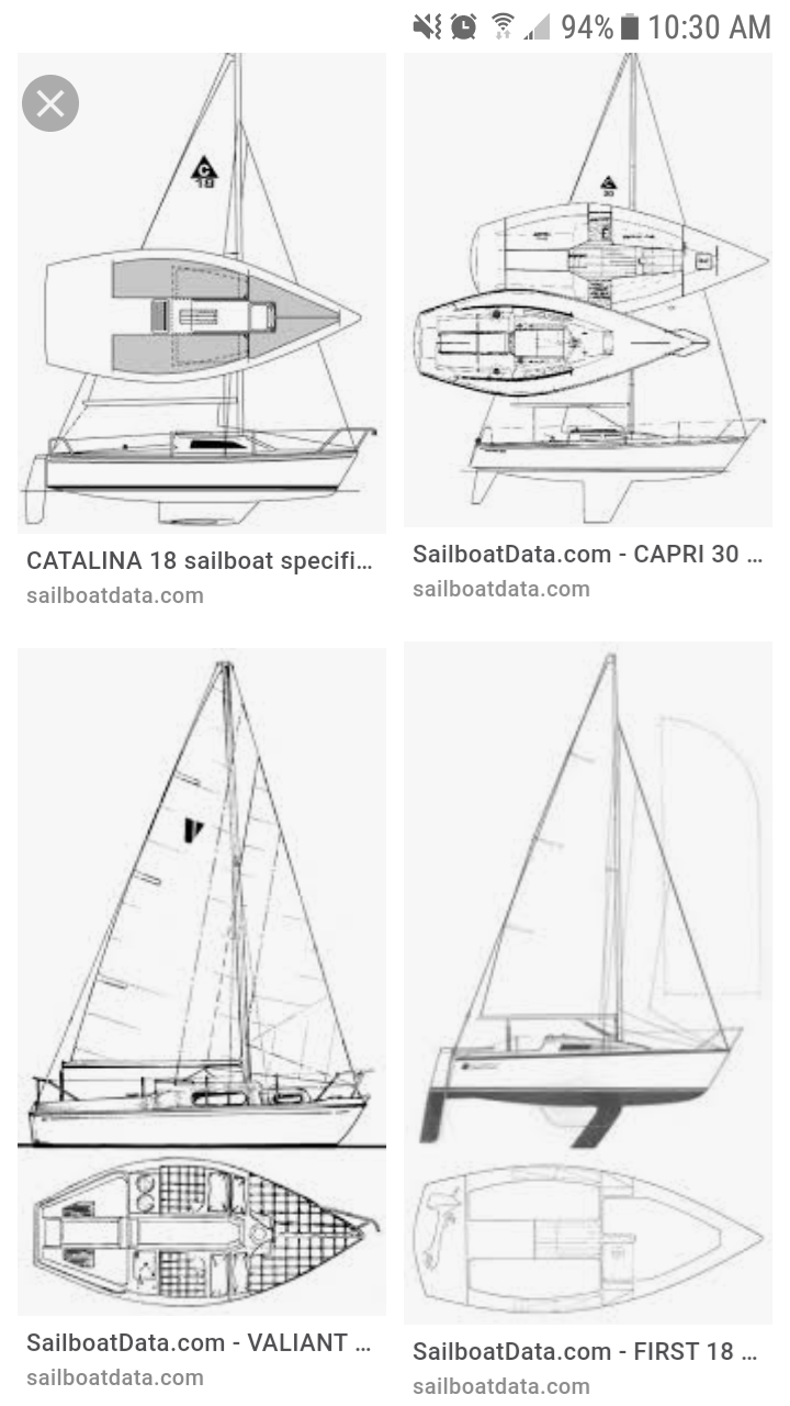

Under what circumstances does the boat round up. I like this boat too and would like to know more. When motoring, at hull speed do you have good control? What kind of keel do you have?
This to me looks like a hull form issue and less to do with sail trim.
Ive attached a picture of the catalina 18 with a First 18. They look similar, but the first has a longer rudder, and a centerboard. The sail plan looks similar, the hull shape is similar. Woulds be helpful to know if anyone on the board had been on both boats or atleast the First 18.
Both boats have fat round hulls. When those heel, the shape pushing through the water goes from a long oval to more egg shape, basically, the forces countering rotation around the keel is less. like standing in a pool, with arms out paddling water it hard to turn, bring arms in and irs easier to turn.
One other issue when heeled (with pressure on sails) is the lenght of that keel on the C18. The flow coming off that is turbulent, more so if stalling sideways, the rudder may not have clean flow to work with. With a higher aspect centerboard or keel there is more lift at speed, less sideways slipping, less turbulence from the keel and hull form.

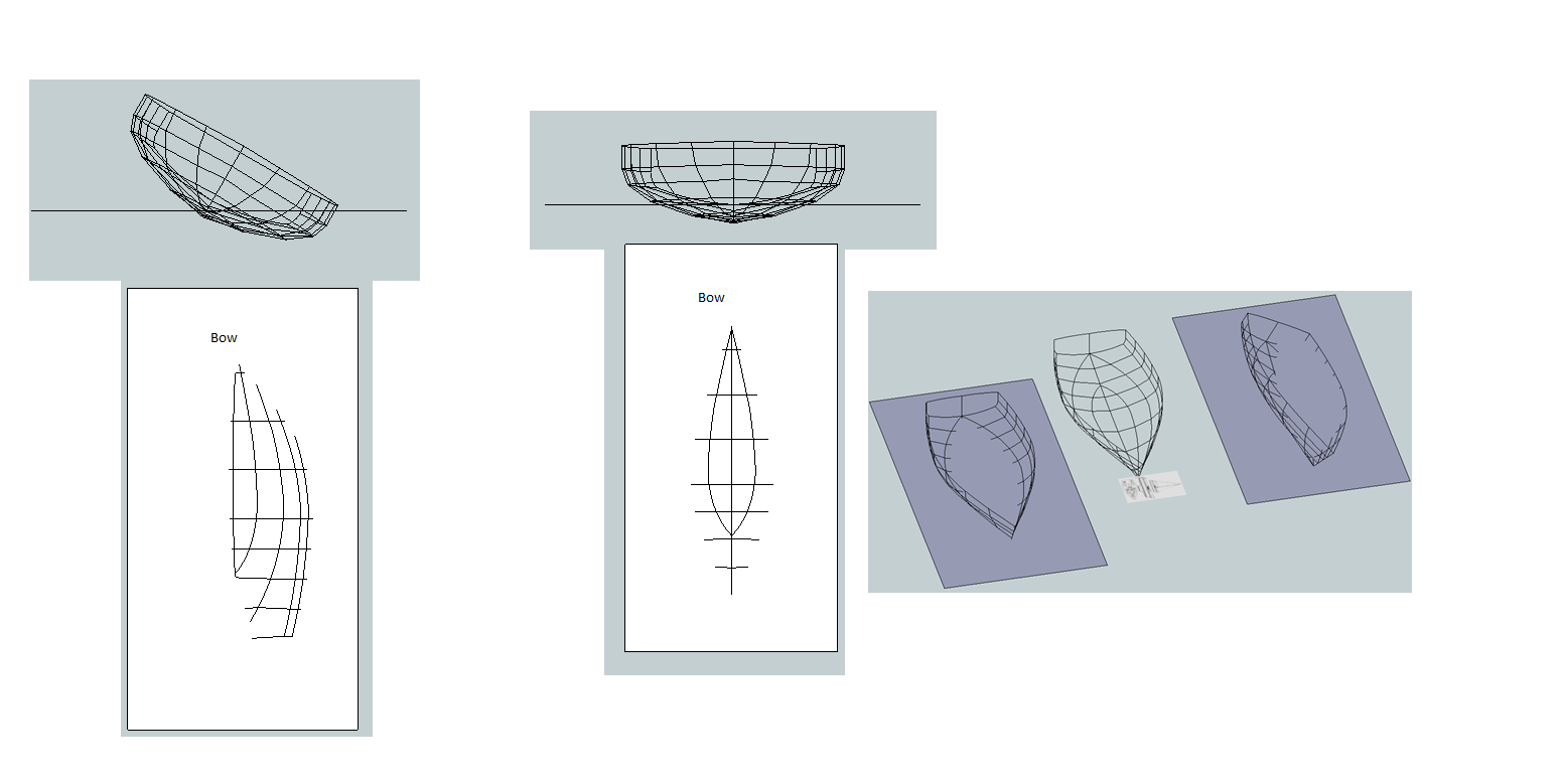

While looking over the specs I see my Hunter 170 shape is very similar to the Catalina 18, just scaled down slightly. Here's a Sketchup of the C18 in both the level sail and the 30 degree heel. Each hull is placed on a plane to simulate the interaction with the water. The views on squares are the wireframe that is under the "water", an outline can be made where the plane intersects the wireframe.
I think I could have angled the nose of the heeled over version a little more to match online pictures and a probably could have sunk the transom slightly, but overall should look pretty close. Most pictures show very little transom under water. The lofting lines were estimated from the top view, side view, transom and pictures online.
The heeled over version has an extreme asymmetrical shape that could contribute to difficult handling, especially as the rudder is also at a 30 degree angle.
If the model should be adjusted I'll make the changes. I look at the drawings and wonder if this boat can actually sail 30 degrees heeled without water going above the rub rail.

This boat can't get the rail in the water without rounding up first
