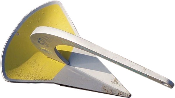

@JimInPB Chain helps to orient the anchor so that the flukes will bite into the bottom.
At one time anchors were just a big weight.
But we boaters got smarter and we figured a way for the big weight to also maybe stick in the rocks or the mud...
Progress to today and we have the plow and the Fluke anchors that are lighter weight but dig in to the bottom.
While they dig in better it only works if the anchor can be dragged along the bottom. If you pull it by a rope it will come right out. So you lay down chain. The Chain when pulled will (because of the weight) pull the anchor along the bottom. The Flukes will get oriented down and the if all works correctly the anchor will set.
Here is a great video link to Steve Goodwin's tests.
Can you set an anchor with just rode no chain? Absolutely.
The chain will just aid in getting the anchor to set more quickly and solid.
