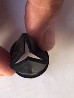

The vent has no filter or obstruction. We took the hose from the toilet to the tank off again and discovered that our "new" macerator joker valve was defective! Surprise, surprise. We inspected it carefully when we installed it two months previously, it looked like it should, no daylight visible, but the backwash issue started immediately. We replaced the defective valve and it has almost completely eliminated the backwash issue. Thanks everyone. We'll see how long this
one lasts.
