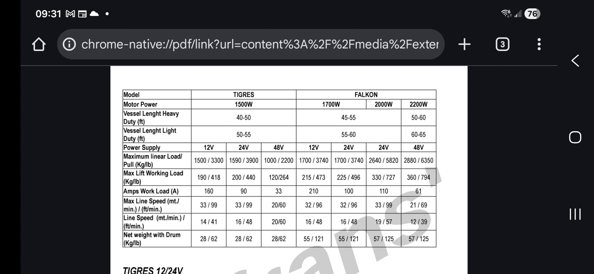

Nothing in the spec sheet either.....
I'm super happy with the quality of my lofrans windlass, but documentation/ packaging QC is lacking. My install manual came with missing pages and the remote shipped with a European wago connector, but no instructions on how to open the clamps...(Wago makes a $0.30 tool).
Actually look more closely in that spec sheet and read where it says working load in amps. The systems they build, as I understand it, are more sensitive to correct current loads which may not be supported by the BMS of the LFP batteries. If you do have LFP batteries with a BMS that supports the required current flow that shouldn't be a problem. But looking at the 12V requirement - that's 160 amps. A lot of BMS may not support that. Even if they don't shut down, they may throttle back to a lower current flow which appears could be the issue.
dj
Ok, but the BMS shutting down won't weld the terminals together inside the OP's motor..... (their original complaint) 100 Amps is nothing for a Lifepo4. My 5 year old 100A (12V) pack can do 170A continuous... and they were cheap / mid range packs.
