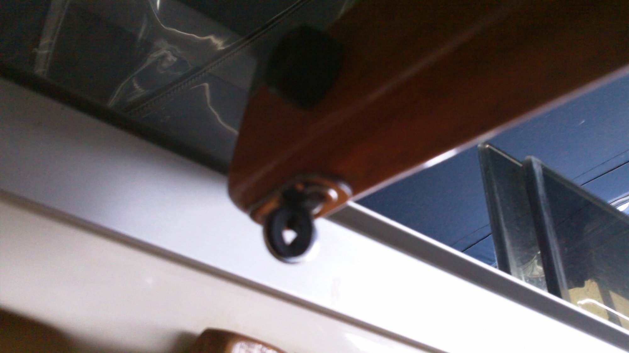

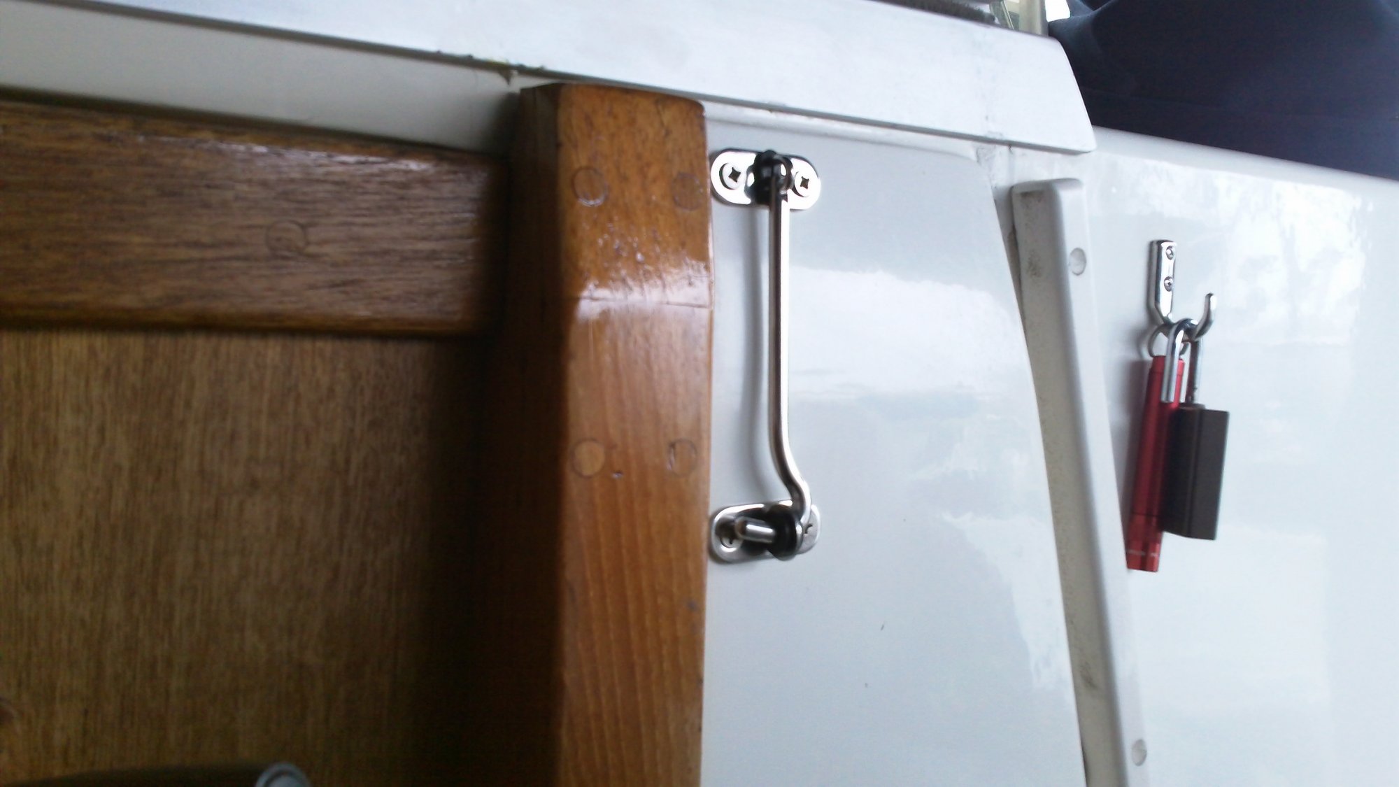

Purchased a standard SS hook latch from our local chandlery and attached with small bolts and nylock nuts. No problem drilling a small hole in the plexiglass.

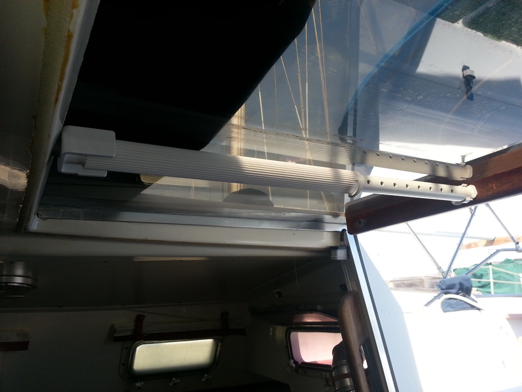

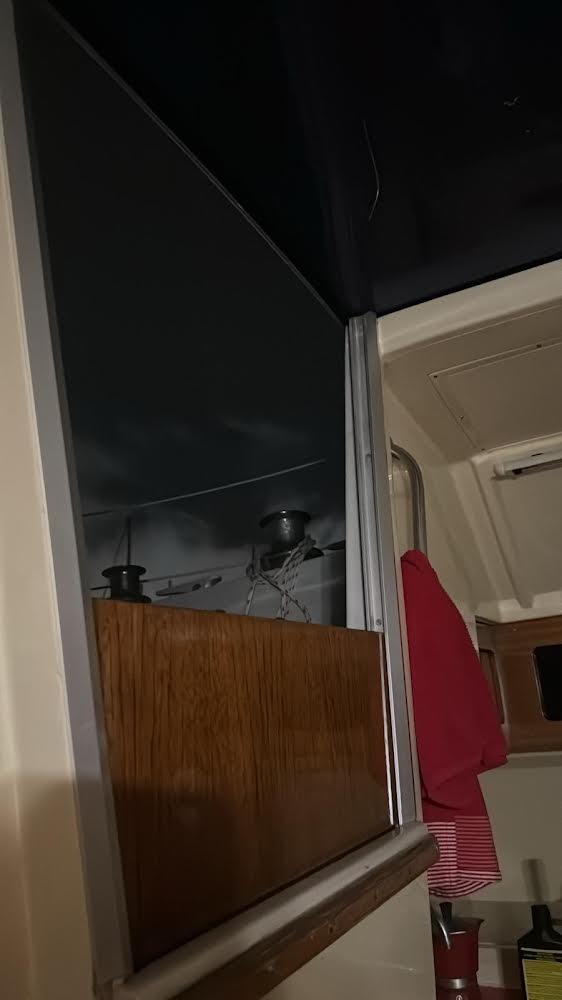

its hard to tell from your picture if you have a lip on the inside of the slider. Here's what we used:
I put a rubber cabinet bumper under the forward side of the hatch opening screwed directly into the fiberglass. I drilled a 5/8" hole in the back of the mount for the Wedgit. The retaining clip is screwed to the wood on the back side of the slider. It slips over the bumper and snaps into place. Easy to pull free in an emergency. Hard for a bad guy to get in. The entire thing except for the clip and little bumper comes right off and is easily stored. The nice thing with Amazon is that you can buy it, look at it and if you don't like it, return it for free.
