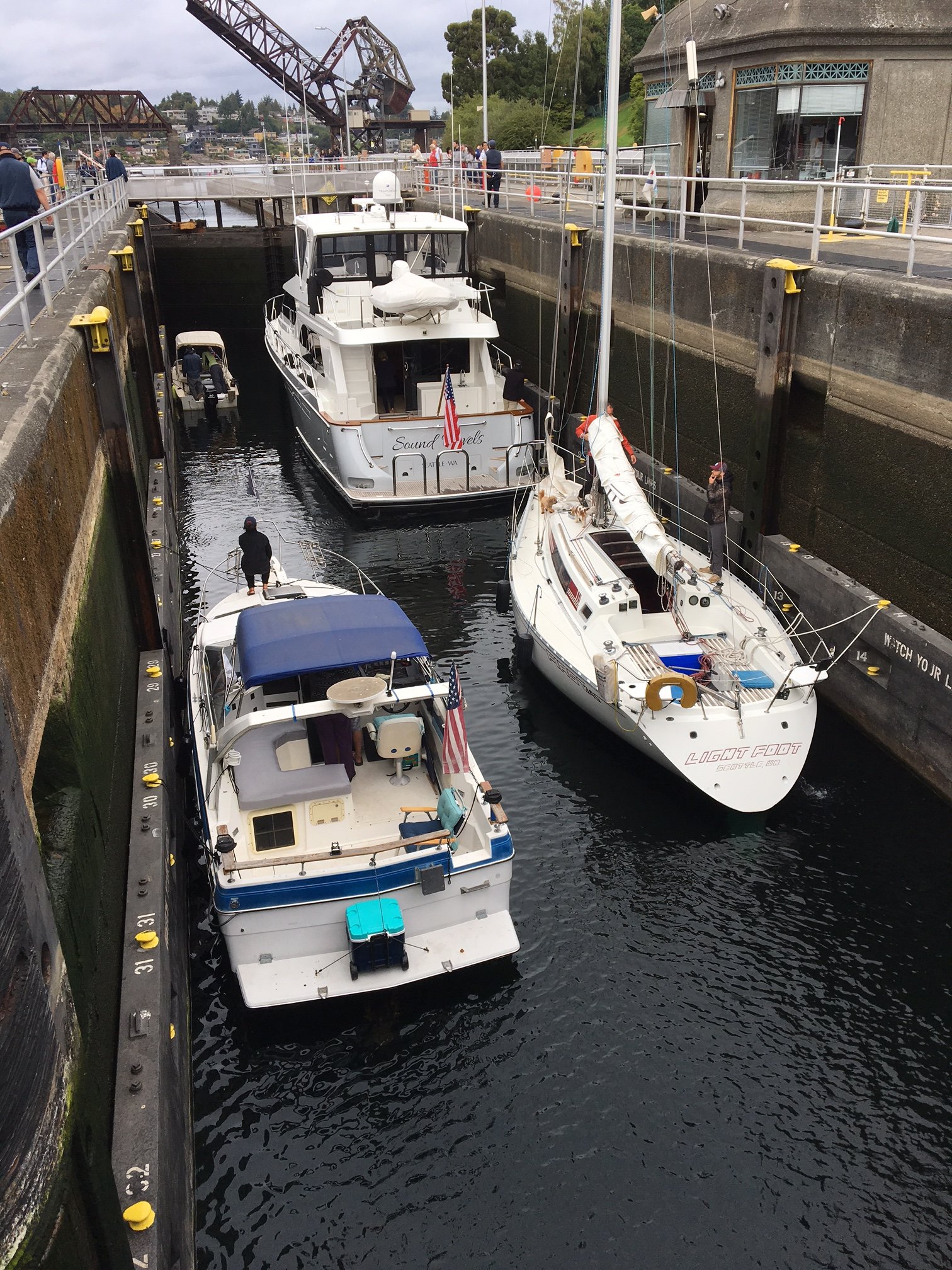

Here is what I used to go through the Ballard Locks
to get from freshwater lake in Seattle to the salt water of the Puget Sound.
Get two of them. Set them against the lock wall on either side of your boats mid beam. They are round and will go up and down the wall as the boat rises or falls.
Run a line around the bollard and back to the boat. At Ballard these are required. Minimum 50 feet. I like 3 strand twisted nylon. I cleat one to the bow and one astern. Toss each to the lock keeper to put around the bollard and return to the boat. You will tend the line drawing in or letting out line as needed. Some lock keepers want a line with a loop spliced in it so they can throw the loop over the the bollard, but that can get messy if they do not get it on the bollard or back on the boat after passage.
In the picture this is the small lock. They have convenient lock slides that rise and fall with the water level. You can see the yellow bollards. You throw your line over the bollard and snug up. The large lock is not so equipped so the large round fenders help to keep the boat away from the wall. Better yet you sometimes get to buddy up with a mega yacht. They have great fenders to ride next to.
