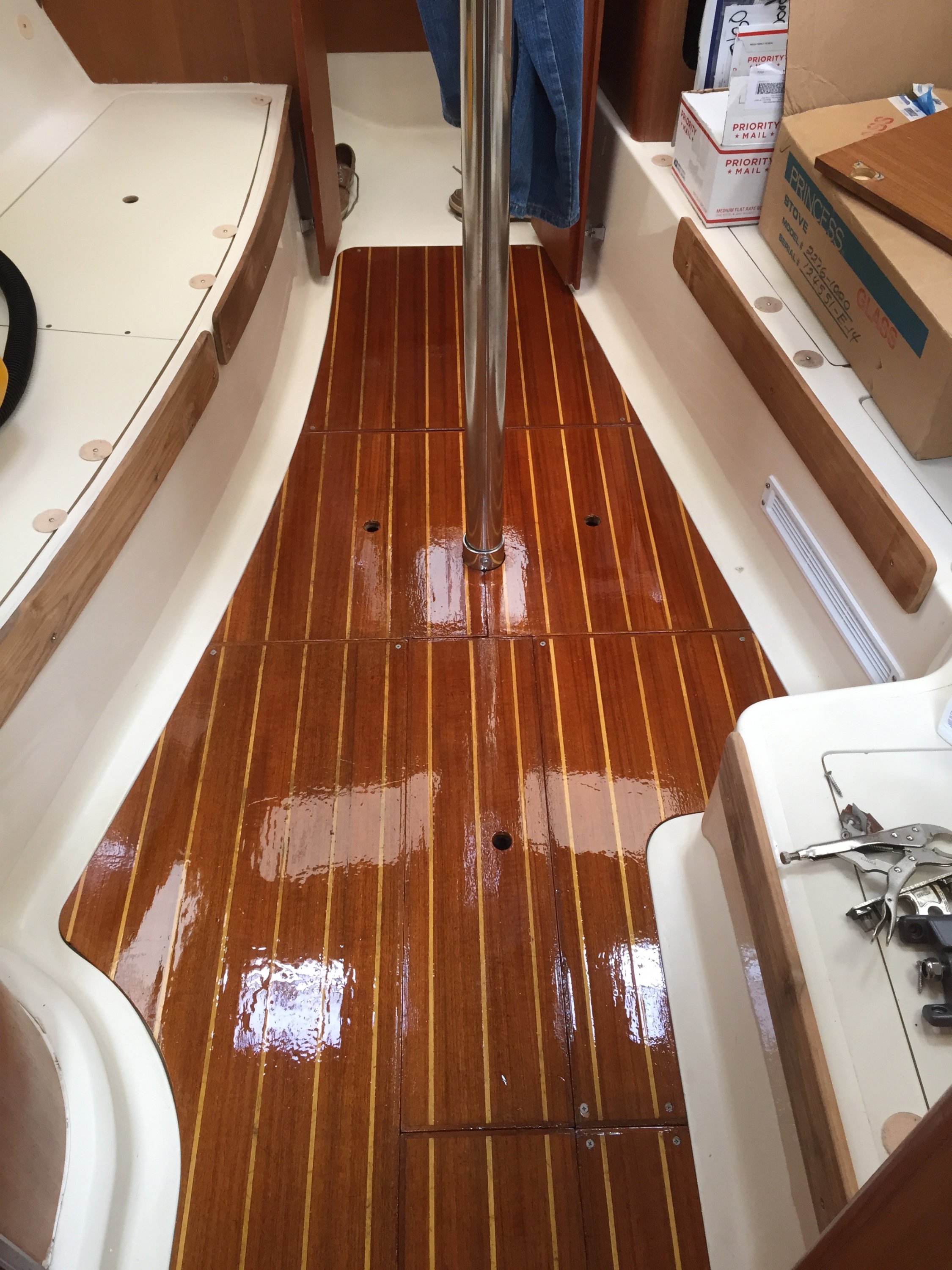

Thanks Tim! I will take a look. I don't remember removable floor sections to the port and starboard of the mast like the bilge access panels to stern of the mast. One would think you would need ready access to the speed transducer for service and cleaning. Are the floor sections attached with screws or just gravity? Also is there a wiring chase diagram available for the Hunter 310? I'm wondering how the transducer wiring runs to the instrument panel over the hatch.

The floor boards are not screwed down and lift out exactly the same as the bilge ones. (See attached photo). The wiring runs in a plastic conduit under the cabin sole, through the port setee and into the cabinet in the head. From there it runs up behind the mirror cabinet and into a conduit that runs just forward of the head compartment and exits at the removable ceiling plate that is just outside the head door. From here it runs up through the deck into the instrument panel through a short plastic tube.
