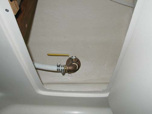

I have a marine head and the raw water inlet for it is pulling from the balast tank. I know that is a bad idea but that is how it was done. The inspection did not notice it or I would have had it changed by the previous owner or got the price reduced to have it done. So my question is for Hunter 26 owners or anyone interested in giving there opinion, much wlecome. Where and what type of sea cock should I have installed? I will cap off the tank fitting which is located in the cabinet in the head but I am interested it were other owners have theres plumbed. A picture would be great. I will have a professional do the installation since it will be below the water line. Should I use a ball or gate type valve? What size is recommended?CarlS/V Wind Shadow
