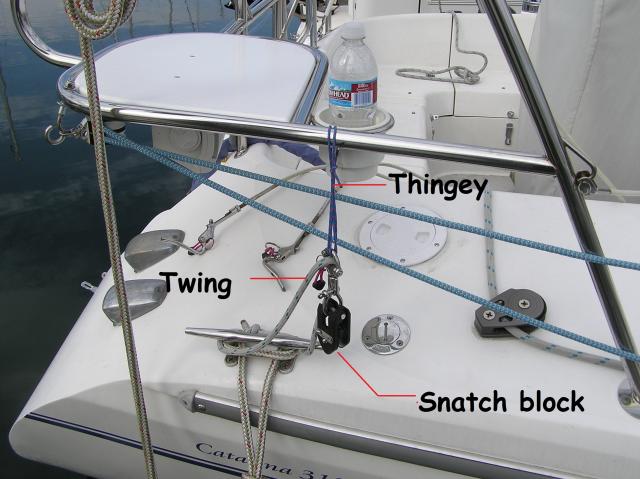

When I run my Asym I run a twing line to the cleat from the snatch block.
The twing line is secured to the cleat just like you would secure the dock line, one on each side.
I use the same snatch block for both sides.

Thank you for the pictures! Last year another kind soul referred to Twing lines. I had a hard time visualizing it. Somehow I was thinking that the twing lines acted more like foot blocks to change slightly the fleet angle of the spinnaker sheets to a block on deck whereupon it would be made up to the primary winch.

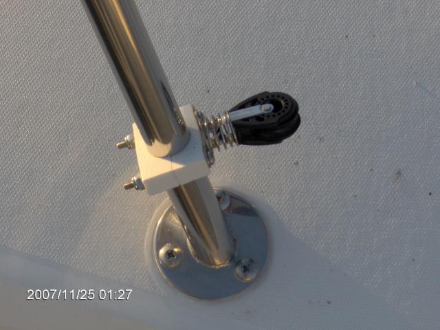

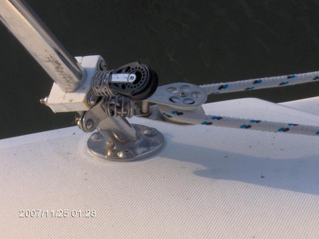

I got a couple of rail clamps from I attached them low to the front swept back rail on the pushpit. With a spring loaded block, it frees the stern cleat and has lots of strength for an asymmetric. I wouldnt try it on a guy on a symmetric however...
http://mt.csjohnson.com/store/index.php?main_page=product_info&cPath=5&products_id=41

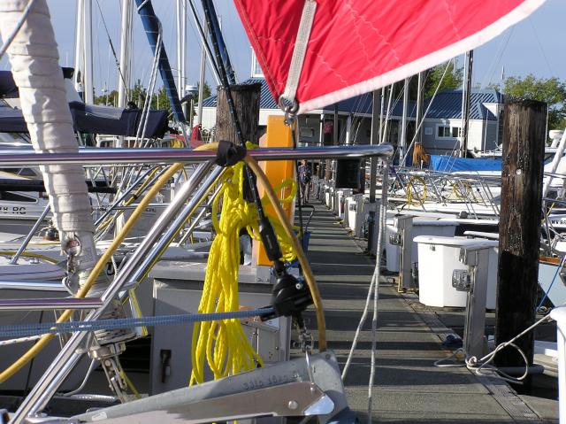

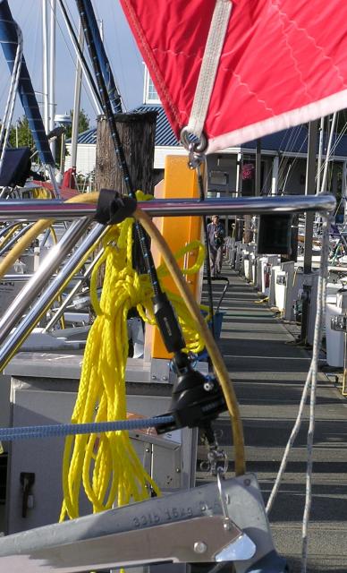

On the bow of the boat there is an anchor roller.
On the port side of the anchor upright flange there is one 3/8" hole.
This hole Catalina designates as a tack bock attachment point for Asy and Sym spinnaker.
Is this what you are looking for?

Not a factory as rail clamps, but they work for me.
Actually, they have worked very well with the drifter. I am looking for a learning spinnaker (prefer Symmetric over Asymmetric), but the block I have should work find. I also have two lines so I can tack the drifter if I need to.
PaulJ, I like your pictures, as I was just not getting what you were saying till I saw them. You just added another item to my to do list.
