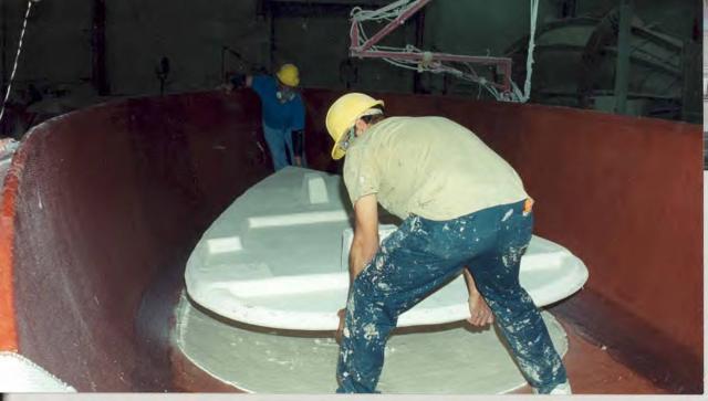

Here's a picture
In this picture you can see the tank and in front of the one man you can see the place under the step for filling the tank. Usually the throuh hole is put under one of the access holes under the stern bed. Mine is in next to the bilge pump.

in This Picture You Can See The Tank And In Front Of The One Man You Can See The Place Under The Step For Filling The Tank. Usually The Throuh Hole Is Put Under One Of The Access Holes Under The Stern Bed. Mine Is In Next To The Bilge Pump.
Thanks For The Photo Any Suggestions Where To In Stall A Thro Hull Depth Finder?
