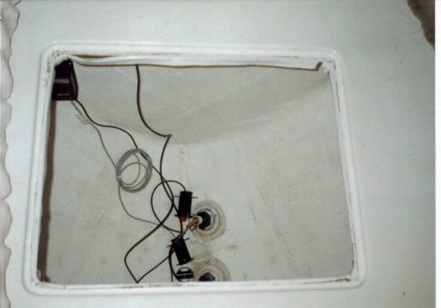

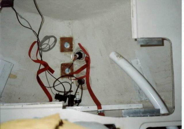

My new location for Depth,Speed, Temp transducer
I posted a write up in the 33_77-83 owners mods forum but there seems to be no moderator to approve it. I have the photos and description for where I moved my thru hull transponder here
Basically I removed the original ones under each of the salon seats and re-fiberglassed the holes.
Then I cut a door and an access hole to the hull in the 2 drawer compartment that is across from the hanging locker.
That was the most forward and center location I could make work.
