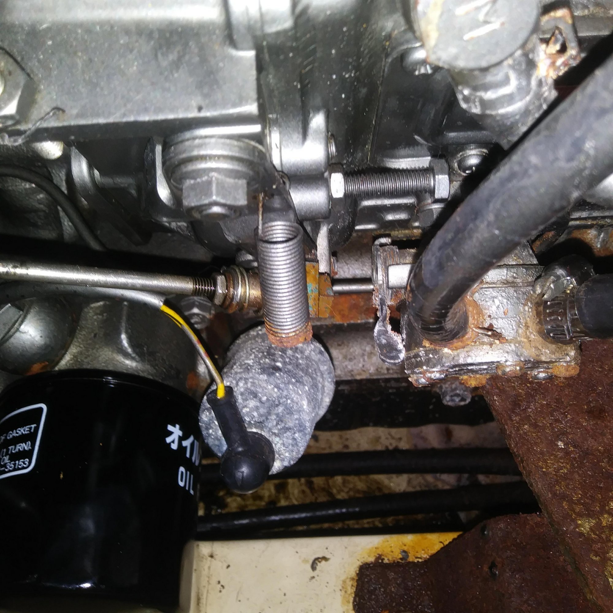

As you can see I have an obvious seawater leak somewhere on the starboard side of my Yanmar 4JH2E. It appears to be a drip of some sort. I'm away from the boat but will investigate when I get back. I found this when I was changing the oil this fall. Is anyone aware of the possilbe location of the leak on this side of the engine? I"m thinking it might be the "vent" tube from my PSS dripless shaft seal? Do most people have a bottle of some sort at the end of the vent tube?

On my 3JH2E I found similar corrosion. It is right below the vent for the PSS shaft seal. When the boat is pushed hard astern water can back up through the vent and into the engine compartment.

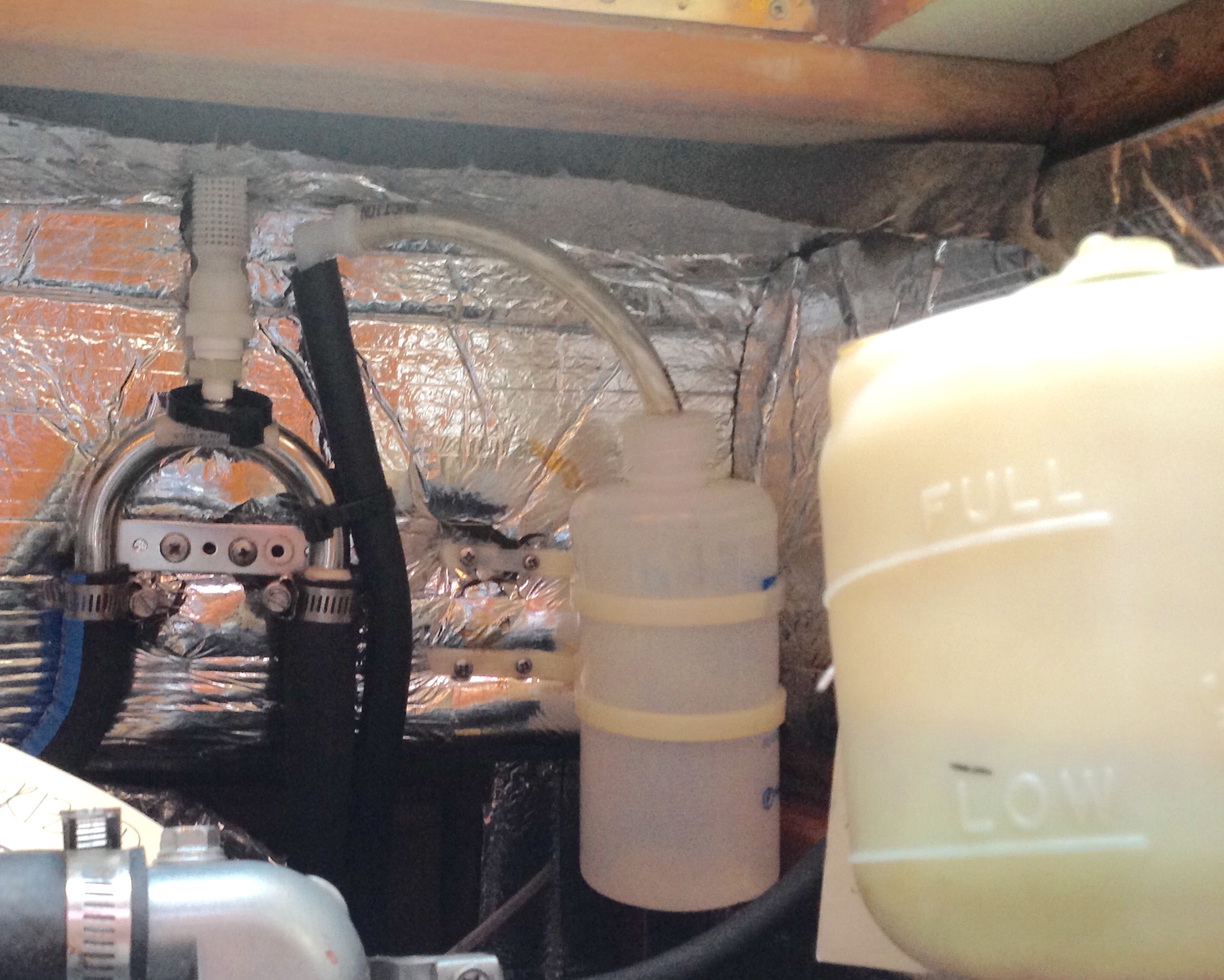

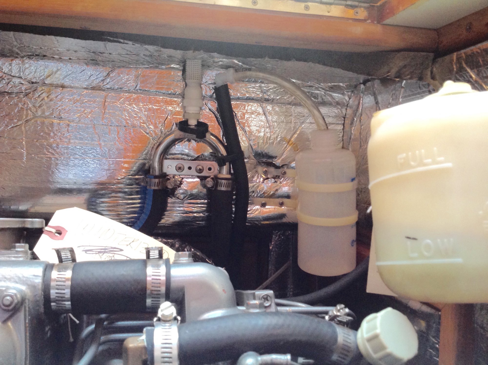

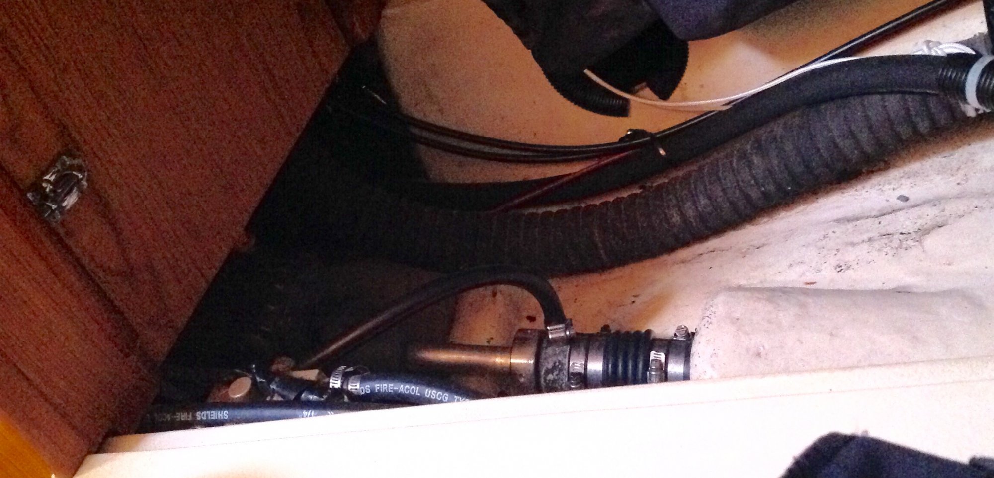

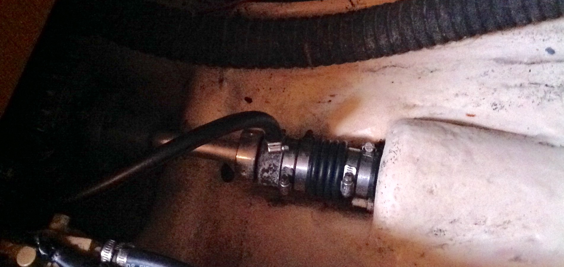

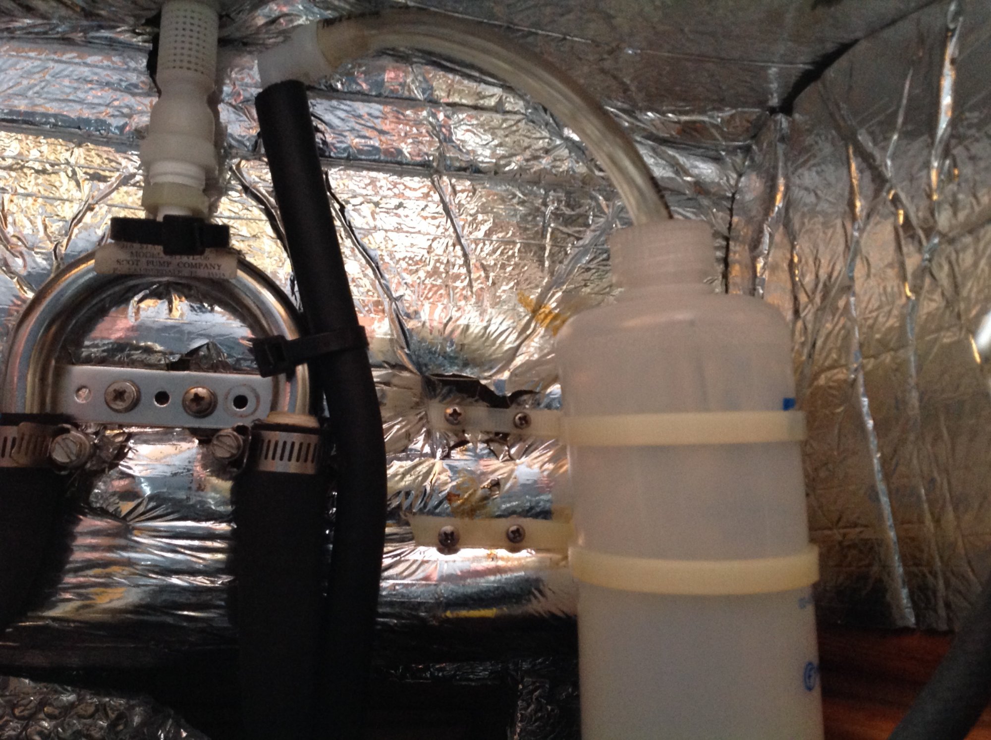

smokey73,
Here are some pictures of my PSS Vent line and overflow bottle. The pictures are a little dark at the PSS itself but you can see how the vent line follows the Fuel Line into the engine compartment. I held the bottle on with 2 zip ties screwed into the back firewall, then pull them very tight.
I drilled the cap a little smaller than the hose, to securely hold the hose in the bottle. So any vibration wouldn't let it come loose. The bottle never fills so weight isn't really an issue. It's a pretty simple setup, avoids a major rust problem down the road and works well.
Hope this helps you design one for yourself.
