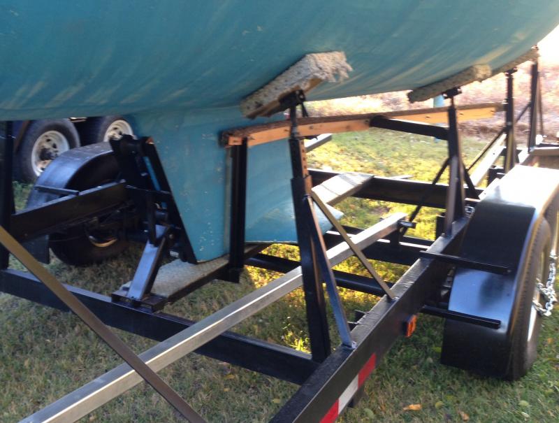

Chief, The keel guides need to be complimented by a keel stop, which needs to be able to do three things,
stop the forward movement
adjust to the angle of the keel as the trailer moves forward
help the boat settle into the proper position, fore/aft, and side/side
Most people think (and I'm not being accusational at all here) that the winch is the best stop. It's not. The point of rotation between the boat and the trailer is at the lowest, most forward point of the keel.
The Mac guys (and I was one, once) know that the position of the boat on the trailer can easily be adjusted forward into the proper position after the water drains, with a slight tap of the brakes. I wouldn't even consider that with 7000 lbs of Catalina back there.
Here's a shot of the assembly on the trailer. The keel stop has a bolt (pin) that allows it to rotate, such that it matches the angle of the keel as it floats onto the trailer. The thing can swivel 50 degrees, far in excess of what the angle of the trailer would be. The guides prevent the keel from moving side to side, and are high enough that there is always clearance for the fins. The winch strap is marked, so that it is not cranked in too far as is the case when the trailer is at an angle.
The boat could drag the trailer sideways in a blow, but it will still maintain it's relative position to the boat, since the boat is being held in 4 planes (fore/aft, side/side)
The keel guide rotates as the trailer comes out of the water, effectively following the pivot point, and forcing the keel (and thus the boat) into the right spot.
This was all theory until this fall, when the boat was floated onto the trailer (in a pretty good wind I might add) and with the exception of the guides being too far apart, the boat settled within an inch of where it should be.
It can be done, done safely, and more importantly, reliably. That opens a door to easy access to far away places.
Cheers
Gary
