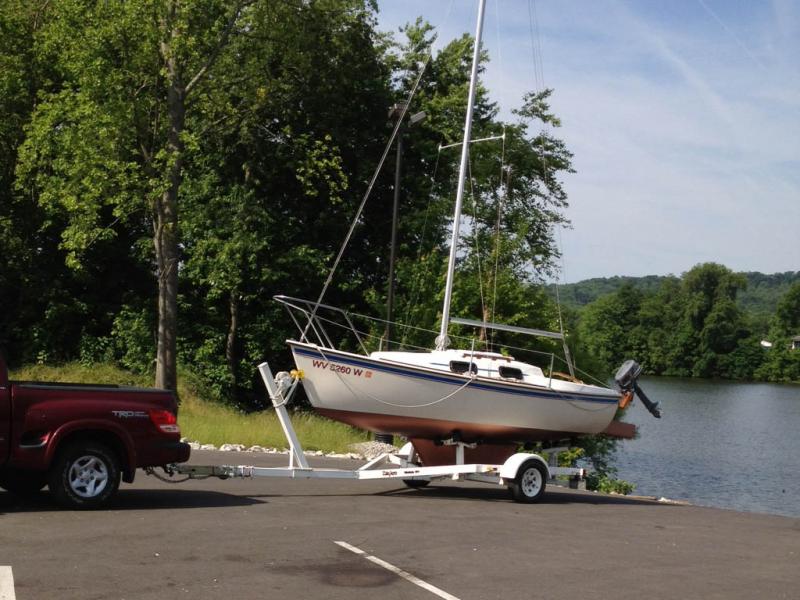

To make a long story short, it took three of us to manhandle my boat onto its trailer Tuesday with 25 knot gusts blowing across the ramp. It probably would have gone better if we'd all resigned ourselves to getting wet from the start, but that's one of those live and learn things, I reckon. We ended up with my wife operating the winch, my son holding the bow centered, and me along side keeping the stern from swinging out over the trailer. Short of waiting for better conditions, is there something else I should have done? Anybody got any tips on this sort of thing?

There's a dock, but it's perpendicular to the ramp and too far away to be of much use in launching and retrieving. They build 'em that way around here so the bass boaters have a place to park the boat while they move their trucks and trailers.
My normal routine is to attach a ski-rope to my bow eye and then push my boat out away from the dock backwards. Then I walk the rope over to my trailer and pull the boat in. Works great when the wind, current, and wakes are minimal.
I have a roller trailer which is kind of self-centering, but first I have to get the boat between the roller trucks and pointed in the right direction.
