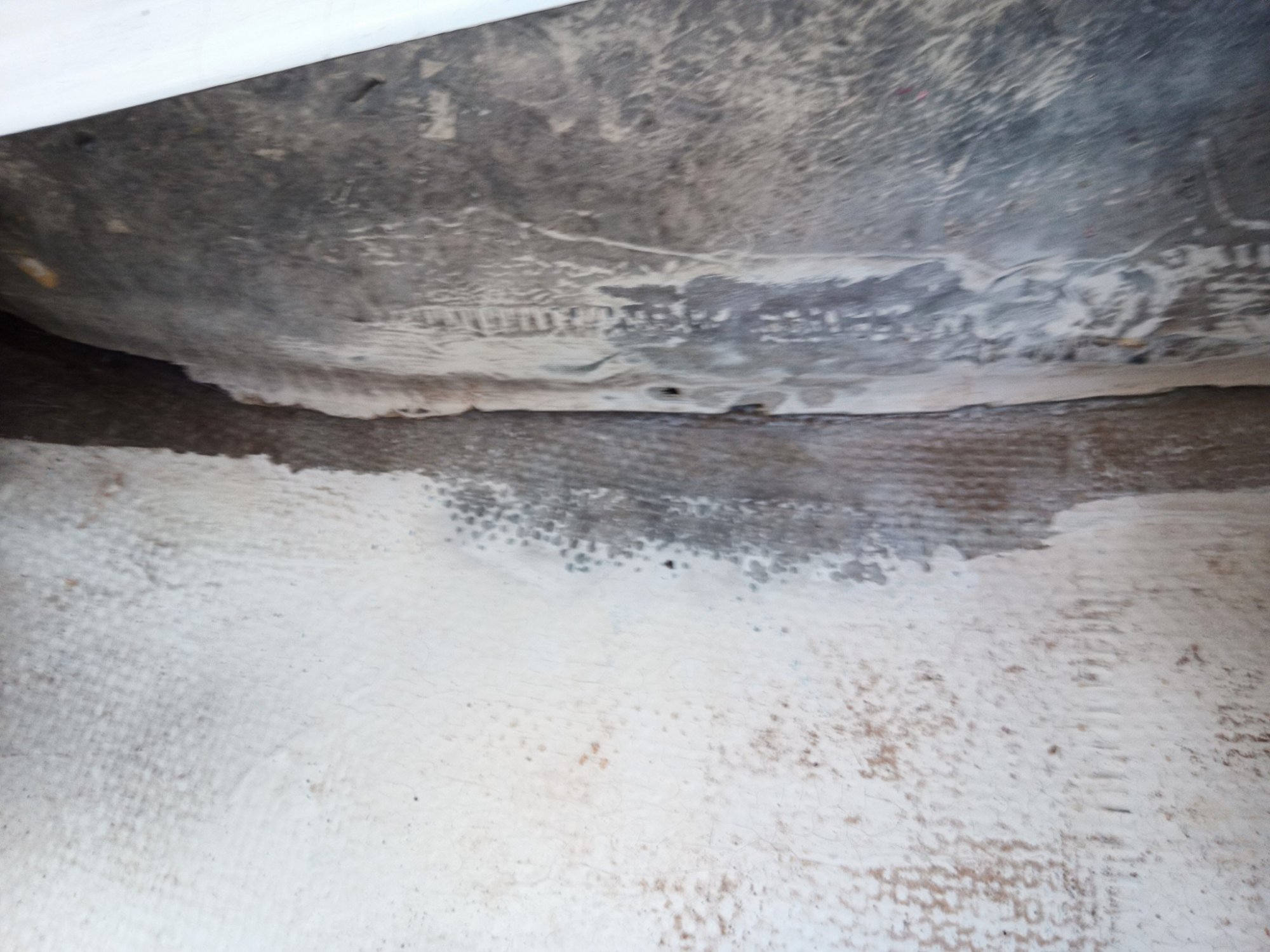

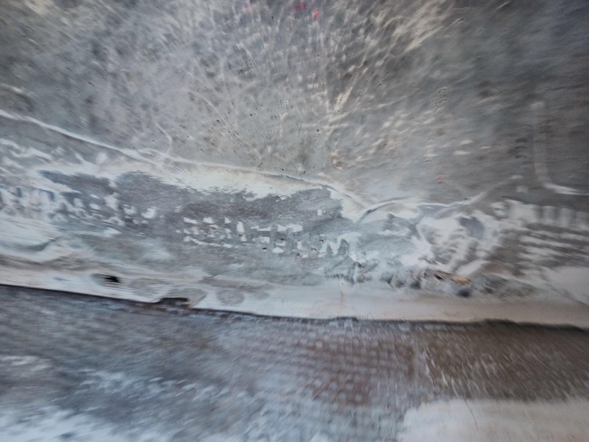

But I'm not sure how far I need to go with grinding/sanding here. Do I NEED to have it all totally smooth (no little gaps or grooves..?) in the fiberglass?
Instead of grinding like crazy to get it all flat... could I "fill" in the holes and crevices with something instead of makign a huge mess grinding forever? Just not sure about a lot of this stuff.
I plan to do maybe 2 layers of the biaxial. I will do a fillet with the colloidal silica to prepare the 90 degree angle to something nice and smooth. Then maybe lay down a 4" wide strip biaxiel first...then a 6" strip to finish. ?? I'm fairly confident in using the biaxiel adn the epoxy after tons of research and a few tests. It's mor the PREP that I'm not sure about.
On the photos, the middle section is where I really sanded/grinded to down to almost all fiberglass. The grooves here and there still have a tiny bit of (paint i guess) in them.
Any help would be appreciated!!

It is hard to see what is catching your eye wrt flat vs non flat areas. From the pictures, it looks like you are almost there, in that you just need to grind off the gelcoat and expose a roughed surface of glass underneath. Looks like you have pretty much done most of this.
If you are concerned about the indentations caused by the weave of the glass, then that isn't too much of a concern, but a grinder should even that out pretty quickly. If your concern is the pinholes and little gaps in one of the pics, then those are no concern at all.
You have the right materials, and congratulations on getting 6" biax tape instead of trying to cut strips yourself. That tape role with edge binding is going to make your job much easier, and even more strong.
Instead of using 4" and 6" wide tapes (you didn't mention having 4"), I'd just use two layers of 6". Put the first layer on with 4" on one side of the joint and 2" on the other, and the second layer the opposite of that. This way you end up with 4" and 8" staggered tabbing
Before glassing on the tape, brush or spread on the area you are going to install tabbing a layer of epoxy thickened with colloidal silica to a thin gruel consistency. This will prep the surface and fill any small gaps or dips. Then wet out the tape you need and stick it on. Use a brush or roller or spreader to remove any bubbles and smooth down the tape. My favorite way is to use a cheap 2" chip brush and quickly and repeatedly poke at the tabbing with the bristles (stippling). This pushes out bubbles and doesn't cause the tabbing to move around like a spreader or roller. Also makes it easy to get the tape to sit down into the joint.
