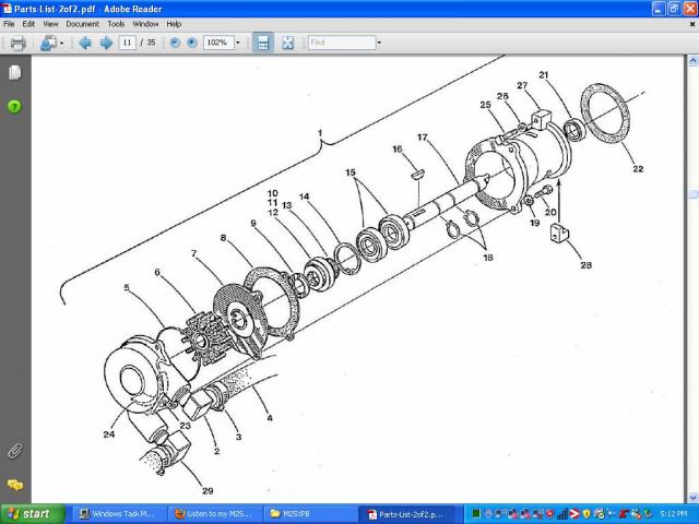

Good question RAD, I know on my Sherwood, there is a shaft that is gear driven, not sure how I get into where i can inspect the gears to see if they are getting lubrication without major breakdown. I can see on the exploded view that there are 2 sealed ball bearing assemblies (#15 for all you gamers) they could be the source of the noise. I remember though, reading somewhere that if you pull the shaft out accidentally when changing the impeller that it's a bear to get back in.

What is the gasket # 22 for? water,oil cause thats what might keep you from running the engine without the pump attached,but by the looks of all those parts inside I'd take a large bet thats the problem maybe try the long screwdriver to the ear and that pump and see what happens
That's not true anymore. The really older engines, before my 1986, had a female inboard end to the pump shaft. It took me two years of getting up my nerve to take it out. Once I did I found out it had a MALE end which slid easily in and out.
Check your blow up diagram for your engine and your pump, and you'll most likely find you will not have this issue. Part #17 clearly has a MALE end. You do not have this problem. NOT.

So if the seal were to fail, then raw water would enter the bearing and mess it up.
It would appear that the shaft will only pull out once you remove the plate #9 and then the seal #10,11,12, then maybe the entire assembly with the bearing will pull out, but it is hard to tell. There is certainly some clip rings holding the bearings onto the shaft.
Stu, did the bearings come out when you pulled yours?
23,530
Nope, the bearings stay in, the impeller and shaft slide out. Whenever I have a "raw water pump event" (like overheating or a clogged raw water inlet), I simply take the cover plate off the pump and pull out the impeller and the shaft. I have a new impeller and shaft (backup) always ready to go, along with a new face plate cover gasket. Your Sherwood pump has that bassackwards cover plate, but once the plate is off the impeller & shaft should easily be removed. I have an Oberdorfer. Pretty much the same guts, take a look at the Oberdorfer pump online at marinedieseldirect, same concept. http://www.marinedieseldirect.com/c...ervice=200151&printoperators=200157&comment1=
The pump body should hold the seals and bearings in.
Ya know, since we have the same engines, why not ask this question over on our C34 message board, we have lots of skippers who could help on this one, too, as well as the great guys here. http://c34.org/bbs/index.php/board,11.0.html
Try that, 'cuz I don't have a Sherwood pump, but I find it hard to believe that a pump's guts would fall out if it's just the impeller you're trying to change..
