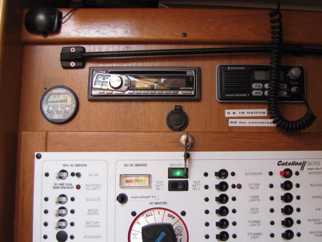

Installed a battery monitor this week so now I don't have to write down times and amps.
The house battery bank is the two 4Ds and the alternate is the start battery.
I was amazed with the accuracy.
Ran tests with the Fluke in line and compared readings with the LinkLITE.
Numbers are accumulative
Standby...................................... 4ma
Nav switch.................................. .40A
Inverter...................................... .65A
Computer................................... 3.40A
Monitor...................................... 4.5A to 5.0A
VHF............................................ 4.8A to 5.5A
So this my sailing load.
