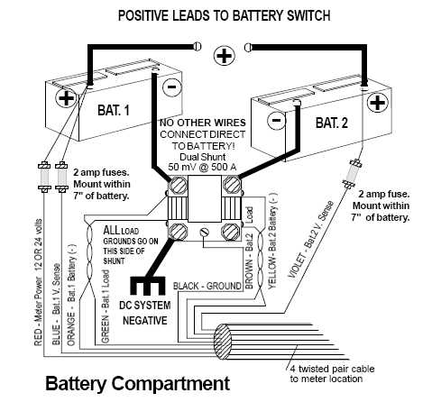

Actually my Link 20 (which is just a dual-battery version of your Link 10) doesn't show a charger or the alternator connection either. however it states that all loads must connect to the 12V system ground side and that NO other wires except the shunt are to be connected to the battery negative.
See the wiring from my Link 20 attached.
Now I know that there is lots of controversy about alternator connections directly to the battery, and lots of owners like to have the bilge pump directly connected to the battery so that it can't be inadvertently disconnected.
If you connect your Link 10 exclusively and directly to the battery as shown and then connect all A-B switches, bilge pumps, chargers, alternators, etc. to the load side of the shunt, you can then follow the best practice that you believe in and still have a Link system that wil accurately measure and report on your battery system.
Now at this point you may not wish to rewire your batteries and eliminate all of the direct battery connections. Just be aware of what connections are not "seen" by the Link and understand those consequences.
