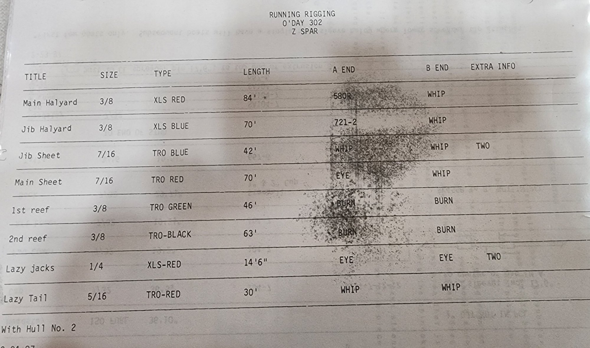

Can someone please explain what the XLS, or TRO means when describing the
type of lines? I have attached a picture of what I am asking. Thank you in advance.

XLS is a Samson cordage used for halyards. It is low stretch and has a shinier finish. TRO is short for Trophy Braid, which is also a Samson product used for sheets. It has a fuzzier or rougher feel, which aids in a better grip in your hands for trimming sails and wrapping around winches. XLS can be used for sheets too, but not so Trophy for halyards. Samson is a great product, BTW.

Thank you so much. This is the answer I was hoping to get to expand my knowledge. Thank you again.

... And double or triple check the O’Day manual length specifications against your own real life equipment and set up - measure what you have in place currently and add or subtract length for your replacement line to suit your comfort and sailing style. I used the manual specified lengths to replace some lines and they were significantly off - either too long or too short. And my 302 hasn’t been significantly modified from original equipment.
Barnacle Bill’s answer is spot on. You don’t need to use Sampson XLS or Trophy, but a decent low stretch halyard of the correct length and diameter are important. And the rigging chart helps you figure out what you need.

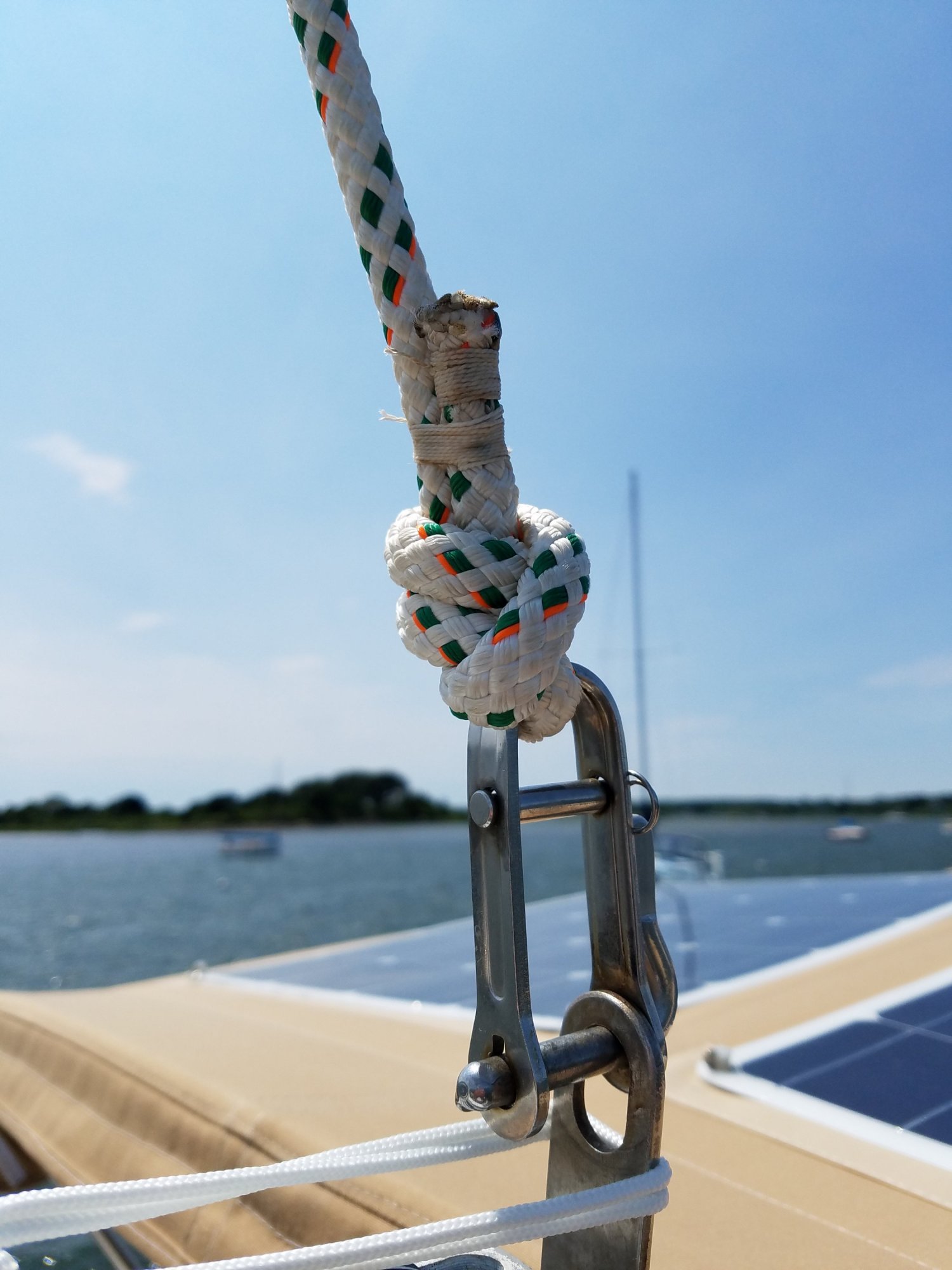

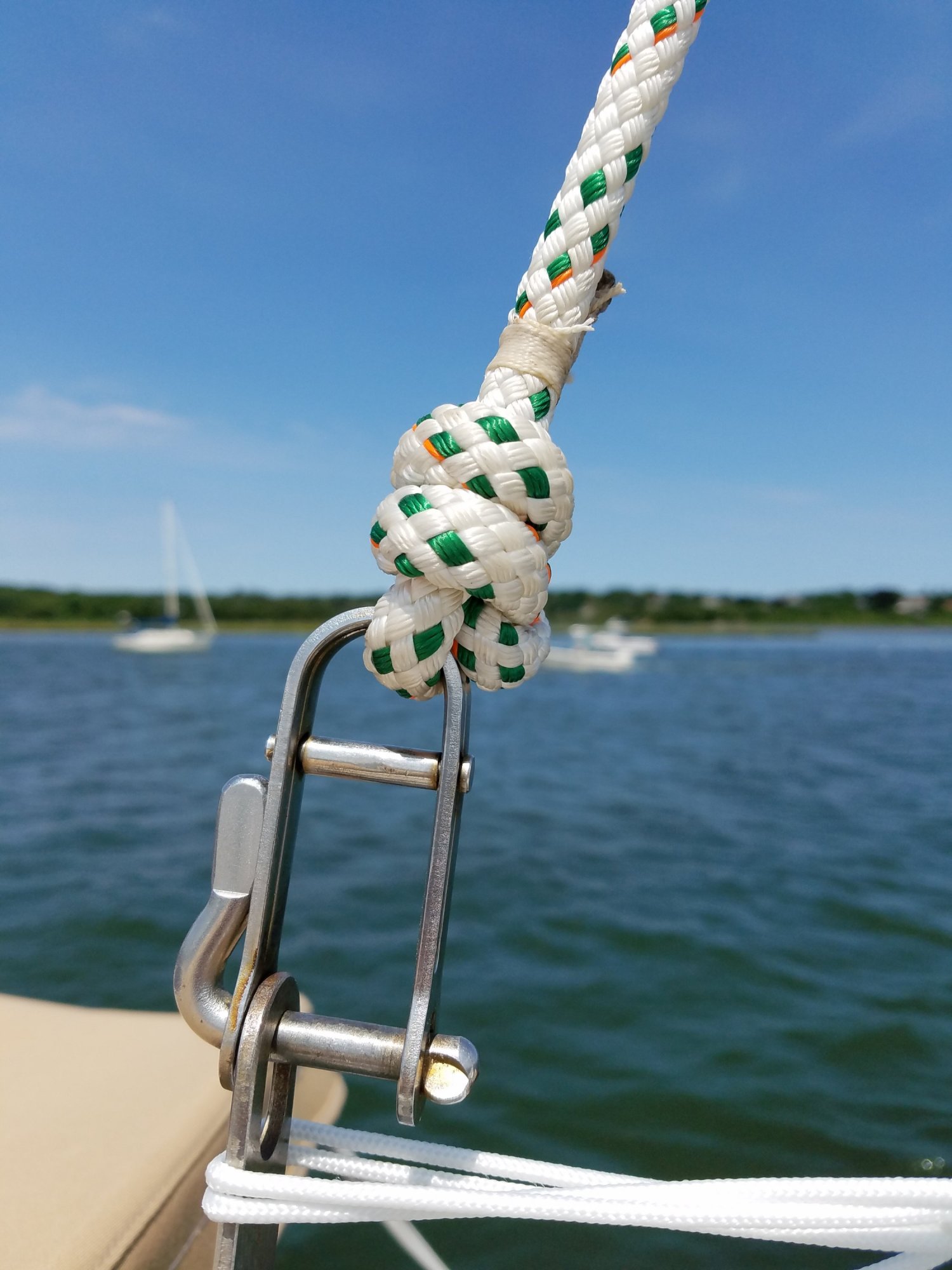

You can save a few $$ on halyards if you learn to splice your own on, or use a halyard knot. I just replaced my spinnaker halyard, and had to cut off the eye splice and shackle (don’t ask me why)…. So, instead, I just used a halyard knot to secure the shackle. Works great. and I will be able to swap the ends around at some point in the future (the part in the mast stays pretty pristine while the parts outside the mast get pretty crusty, worn and ugly).
