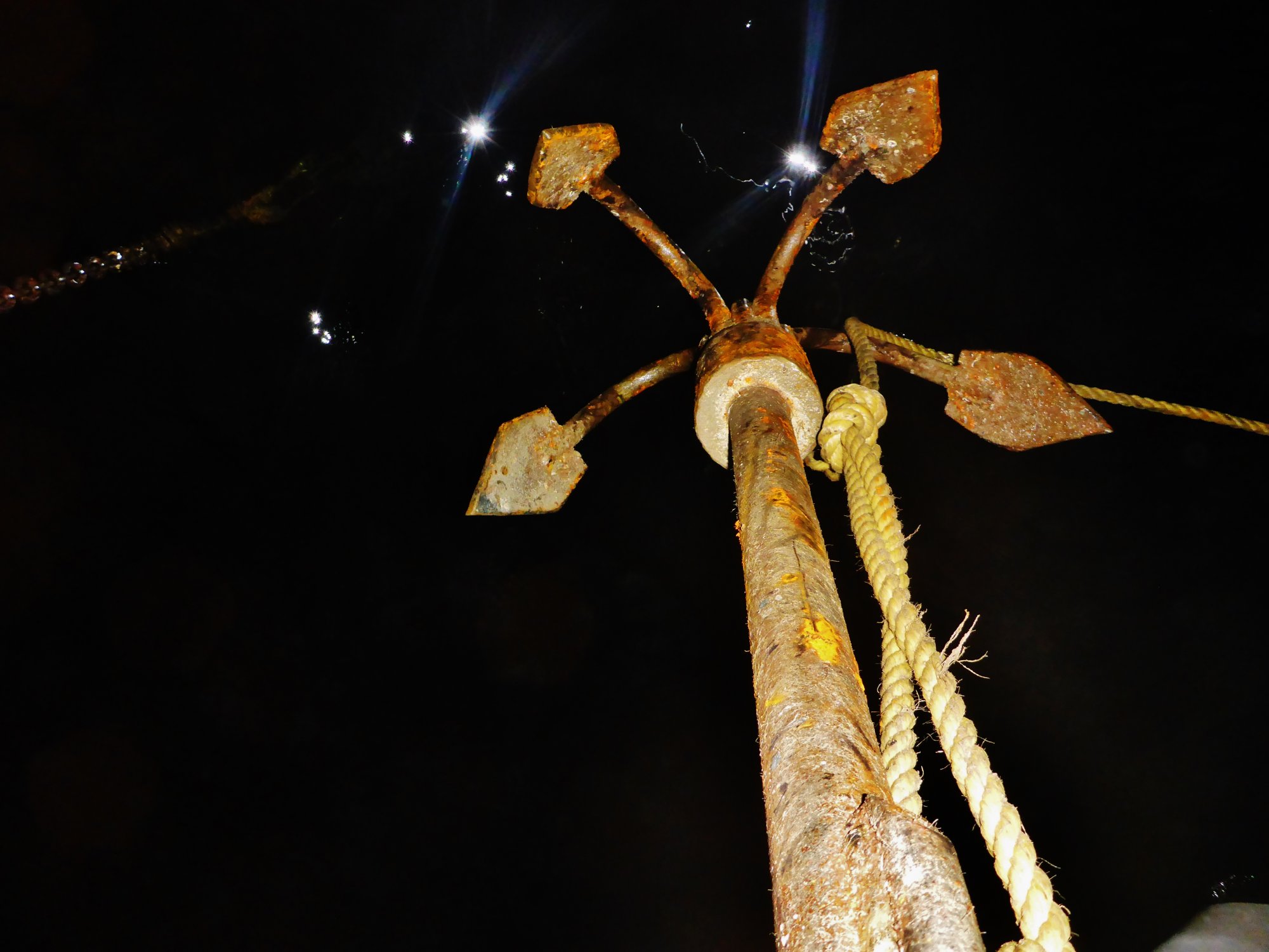

They say a picture is worth a thousand words. The grapnel below was hooked into our chain half way between the anchor and the bow. We were only anchored for a few hours.
Now imagine being anchored on line, picking up that grapnel half way between the bow and the anchor, but you were expecting to stay a few days. Line or chain?
While we are imagining some things, how about a tiny bit farther afield? Watching someone bringing up their anchor from the helm, pushing a little button, with no one forward, and that grapnel, it's 8' long by the way, is coming up in the middle of his rode. Oh my, that's gonna hurt.
Anyway, 200 feet has pretty much worked out for me as a cruiser. That means I can anchor in around 65' of water and sleep comfortably on 3:1 scope. If you don't expect to need that much where you sail, then taylor it to your needs. Just be careful, the forums are full of tales of woe from those who bought the wrong chain because someone said they could use HT chain in a BBB gypsy or vice versa.
