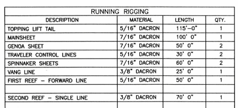

Does anyone have the length of the line needed for the traveler? I’m hull 198 / circa 2002 with a Garhauer model. I noticed it was starting to fray but forgot to measure before I left. I didn’t see this on any of the spec sheets. And while this seems easy to replace, any insight from the community is greatly appreciated.

Did you check Catalina Direct? They say two lengths of 5/16, each 33 ft long

Actually, you should be able to make an educated estimate based on your own familiarity with the boat. Is it a cabin top span?.... 5 ft maybe? Each side has to be long enough to reach across the span, times the number of legs... then how far back from the end to wherever you want it to stop... on each side... So... if 4:1 is the purchase, that's four 5 ft legs and add 10 or 12 feet for handling and cleating... approx 32 ft for each side.... pretty much what KZW said. 5/16 is good because it'll minimize friction through multi purchase blocks. It's always better to order too much than not enough.

Joe - I hit the easy button last night - bought from the link that KZW provided. And oddly enough your rough math was nearly spot on for length. Thanks.
