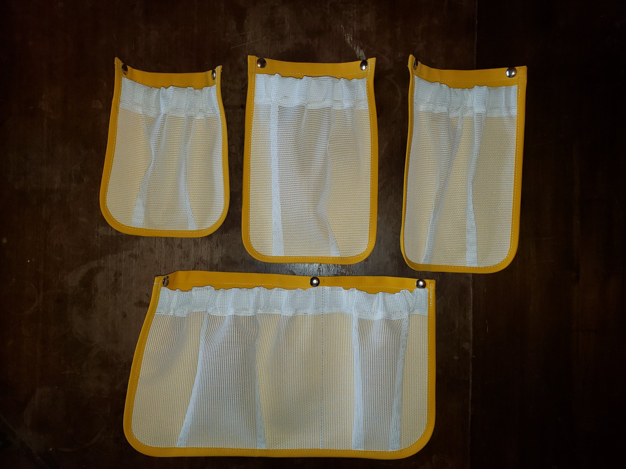

I made bags for all my lines using trampoline fabric. The fabric let’s almost no light through, ventilates well and is stiff enabling quick in and out. I first mounted them with 3m adhesive pad snaps and switched over to Pull Dot fasteners.

@MikeHoncho Curious as to the need to switch from the 3M adhesive pad snaps to the Pull Dot fasteners. Did you use the YKK SNAD pad snaps and did they fail?

They were and failed after about 2 years. They didn’t have enough shear strength for the weight

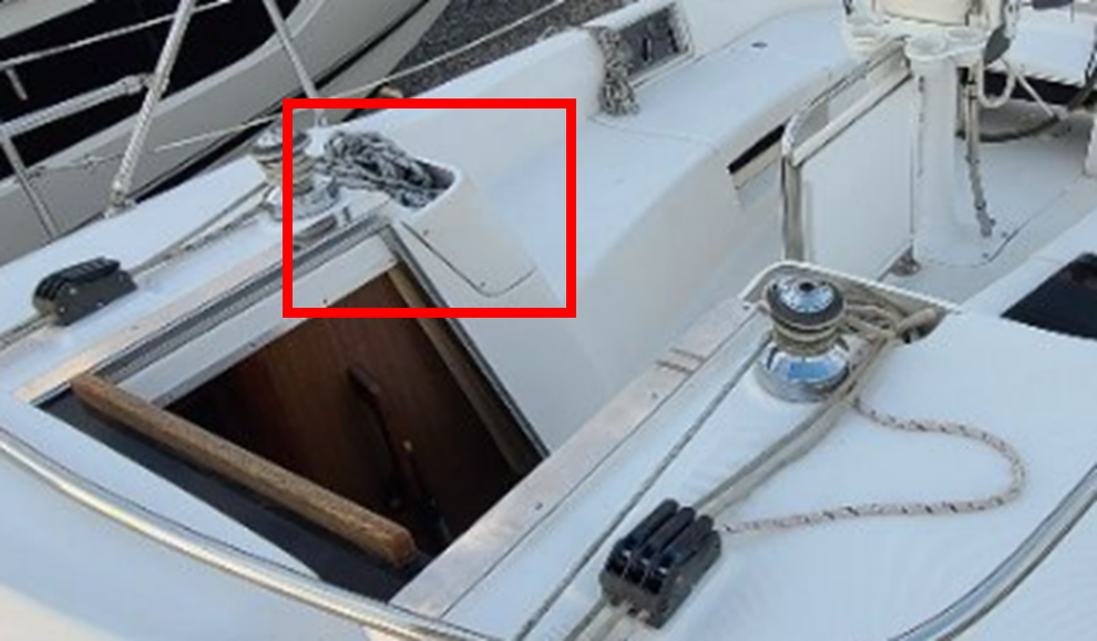

In fact, line boxes seem to be a coming thing. Some are on top of the deck. (Annapolis Sailboat Show today).
They've been around for awhile. My 2008 Hunter 36 has them, as I think a lot of Hunters do (can't speak for other boats). I LOVE THEM. They drain out the bottom, and will hold three substantial lines in them if you put them in carefully. Admittedly I mostly use them for storage when not actively sailing, but for that purpose they are awesome, and really clean up the cockpit. Plus the fact that they're under a dodger means the lines aren't really put away wet anyway, or the most part. Have never seen any mold or signs of holding moisture for any length of time, and the lines are always stored there (photo is not mine - grabbed it off of Yachtworld). They're easy to clean out too - not that they really need it.
