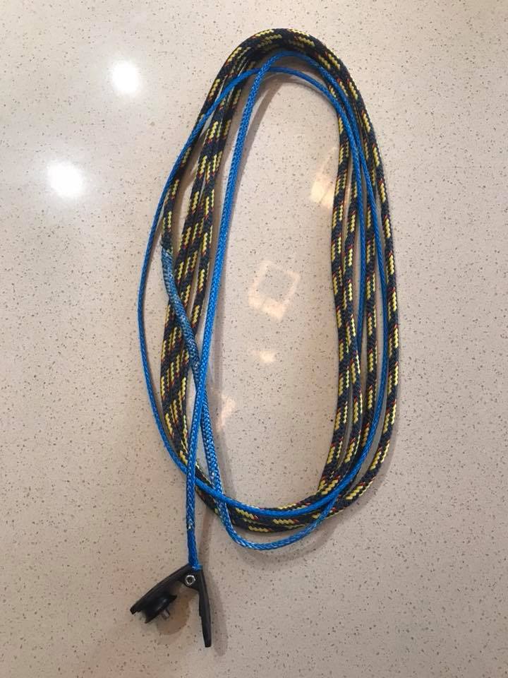

After a month of procrastinating, I finally hardened up and built my new twings for BlueJ. Easy splices but a PITA milking them through. Made from de-covered FlightLine, they are as light as possible so to not weigh down the spin sheets in light airs. Only the core dyneema and the opening shackles are suspended. I think they look pretty cool. Who else has made functional art from rope??

Very nice. The background, too. :)
