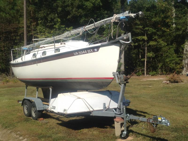

We are trying a Porta-Bote. Not real hard and not real soft. People seem to like them. I have had an inflatable and its a pain to store and I had a fiberglass, which was nicely built but really heavy for it's size. Now if someone just built a dink for all seasons....

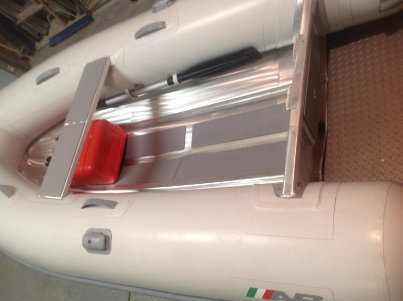

The secret of happiness is well designed davits. If I had to tow or roll, I would stick with kayaks. Therefore an inflatable or roll-up floor has no value to me.
That said, I've had a Hypalon rigid floor inflatable for 10 years and find it to work very well.
* Lighter than RIB, which means smaller people have an easier time launching.
* If the floor is rigid (not roll-up, with aluminum rails to hold the floor fully rigid) the footing is very good and it takes internal abuse just fine.
* Will plane with 6hp with one person aboard. Neither inflatable floor nor RIB will do that.
Yes, you need to be mindfull on the beach, but remember that the floor is NOT inflated and any tears easy to fix (a small tube down the middle, inside the outer cover gives shape and is VERY hard to puncture). But I've never had a tear.
Yes, they are a little tougher to store on davits when the air leaks, but tricing lines suffice to give good support. And there is less weight.
I will replace it in a few years with the same type.
