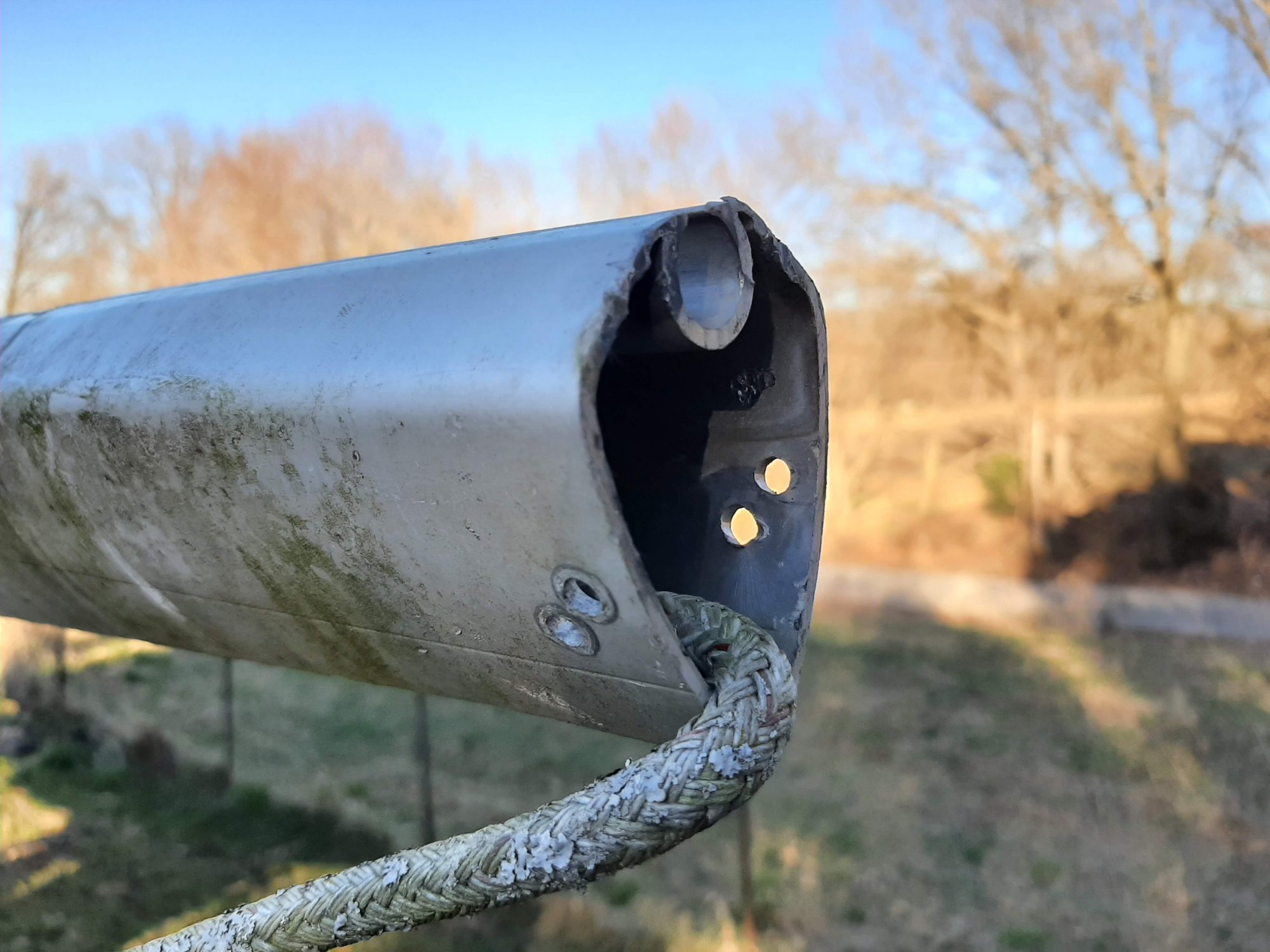

I am looking for some advice on what to expect as my wife and I start repairing the mast on our Hunter 26.5 sailboat. It was struck by lightning in the marina and we took it out of the water and are just now starting to make the repairs in preparation for this summer. Does anyone have any good advice or links to resources that can help explain how to fix the masthead and sheave assembly. Yes I know the halyards need to be replaced so please don't judge. I'm doing research myself but I know alot of you have plenty of experience to provide. We are willing and able to do the work I just want to ensure I'm doing it correctly.

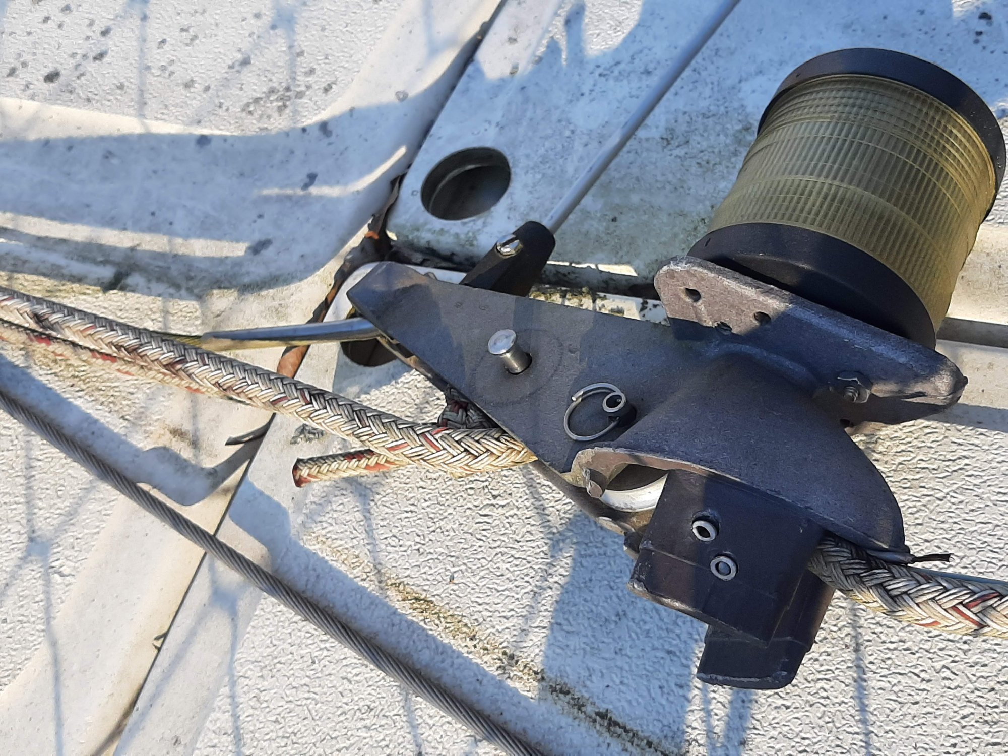

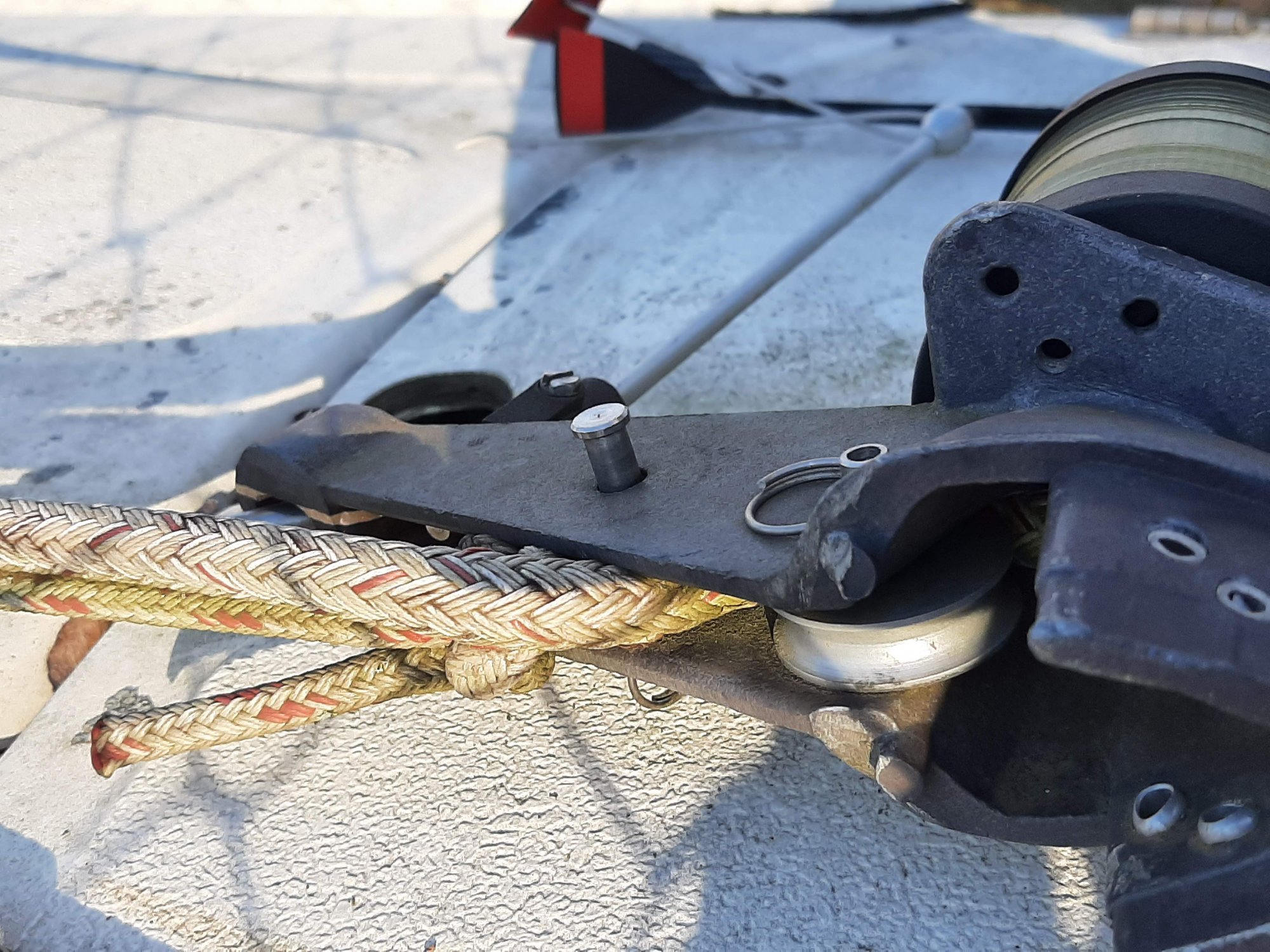

What exactly did the lightening strike do to the mast head and sheave assembly?
I doo nt see any gross melting of the aluminum. It looks like someone took a crowbar to get the mast head off. If so then smoothing out the rough areas and seeking if the masthead will again fit would be in order.
  • With the mast head off what happened to the electrical wires. Are they the black balled up bundle inside the mast? I would be inclined to remove the wires. Being sure to tie a messenger line to the wire so that you can pull new wire into the mast without having toe fish the wire done the mast.
  • The aanchor light looks like the lens has faded due to UV. I would replace the anchor light.
  • The antenna wire for your VHF also may be in that black glob. Pulling a new coax cable is in order. If the antenna fittings are still ok, then you should be able to attache the coax to the antenna.
  • With the mast head down, now would be the time to replace the sheaves.
  • You said you are going to replace the halyards. Were the sails a bit difficult to raise and lower at times? The halyard line diameter is too big for the sheaves you have in the masthead. Reducing the halyard line size and new sheaves should make raising or lowering the sails a lot more pleasant.

So my question here is this. For the mast head it appears that it was just rivetted on. Is this correct? If so do I need to go back with stainless rivetts or will normal pop rivetts do the job?
Is there also a "best" sheave that I should consider as I put this thing back together?
Thanks for the advice.
Jun 21, 2004
3,214
Beneteau 343 Slidell, LA
Check out the remnants of the existing rivets and use same material & size.
Call the folks at SBO store and order a replacement sheave. They should have the resources to determine the "best" size & type sheave
