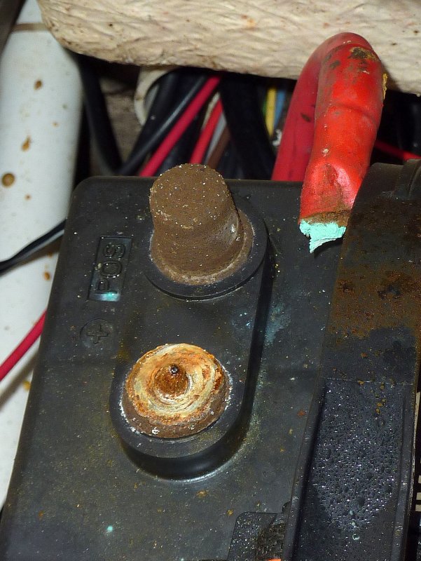

On another note my brothers boat almost sunk Wed night and we suspect it to was hit too. Both battery positive wires were blown clean off the posts and the studs reduced to thread-less tooth picks. The worst part is that we have the battery fuses but had not yet installed them. We have not even been able to get a new battery in there to see what damage his boat sustained as the lugs were melted..

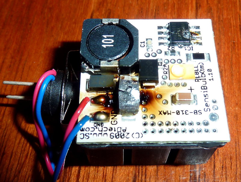

This brand new Sensibulb was literally installed on Tuesday over the galley sink..
My brothers battery, once the post was melted we suspect the bilge filled with the rain water cause the pump stopped working and the water level drove the batteries under water, thus the green corrosion from the "hot" water.. I had just been in there on Sunday and the posts and terminals were in perfect clean shape and nice and silver. I question whether a fuse would have even been fast enough...
