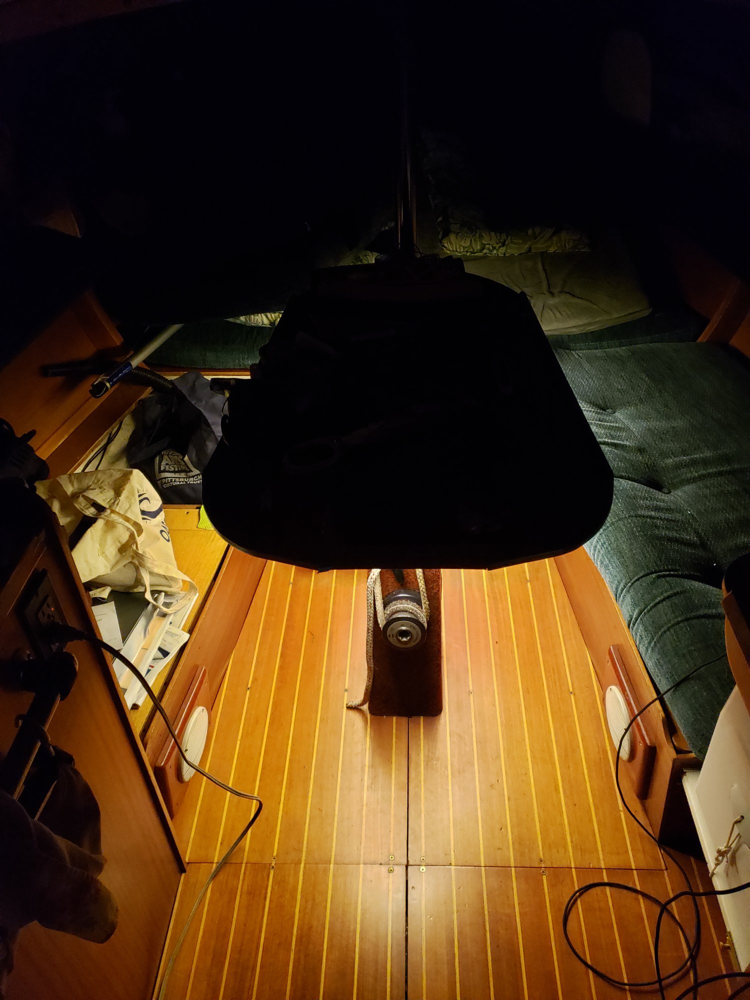

For winter work, I was running a bunch of household LED lights. It was OK but lots of messy cabling and spotty lighting. This year I bought a 4ft 5500 lumen shop light from Harbor Freight. It was a total game changer. It lights up the whole cabin and I only need a secondary light for cabinets and compartments.

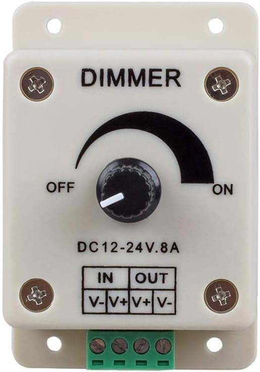

I'm planning on putting in a master dimmer for the cabin lights. It can be installed before or after a relay/switch going to the lights. There are many out there that are more elegant than the example below
Alternatively, you can use some sort of lighting filter inside a fixture to dim the output. Some can alter the color or perceived temperature while reducing output. Straight grays or window tinting can dim the output without altering anything else. Frosted gels or possibly frosted contact paper for windows can create more even lighting while making it easier on the eyes when looking directly at the light. Frosted filters will reduce output a little bit. Every time light passes through something, the output will be reduced due to impurities in the medium or reflections back towards the light source.
