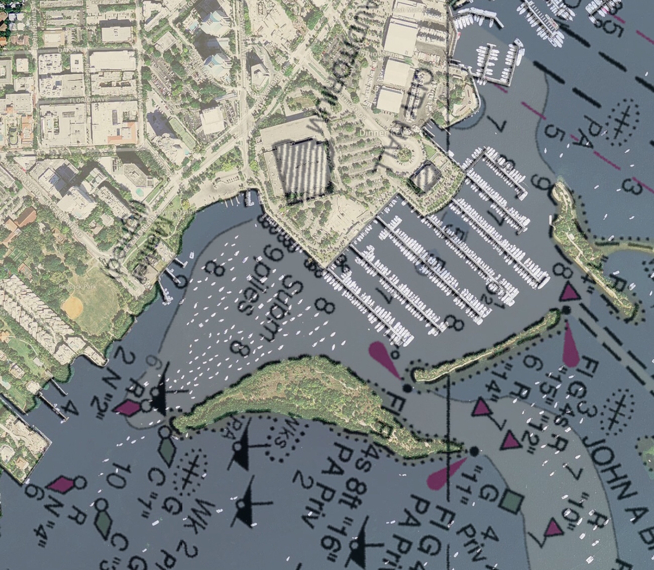

Yep, but even this can be wierd. Here is the huge mooring field just off the Coconut Grove YC in Miami. Note there is no designation on the NOAA chart, but for sure these boats sit with lights off.
Jackdaw - how do the "little white dots" get placed on the chart? It looks like some of the boats there (outside the cluster of boats together, may in fact be anchored not on mooring balls. Should they be displaying an all around white light?
@smokey73 , sorry just saw this. A nav app (Skipper) I have on the iPad does that; superimposes imagery over charts. Only in on-line mode but its cool for reviewing new areas and the like.
