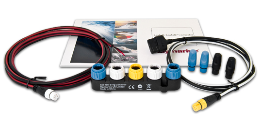

The Ray GPS is a white wire, a "spur" in Rayspeak. It could plug into any white connector in the network. At some point in the network there is a splitter of some description, either a "t", with two blue (backbone) and one white; a junction box, with two blue and 3 white; an "itc5" which is an input spot for older instrument devices. If you're not confused enough yet, there's also a power feed to the brains of the AP if there is one, and some, but not all AP controllers will feed the network. (My SPX5 requires power but won't feed the network, while the SPX10 will) The gps transducer does not have more than one plug, so don't bother looking there. The bet would be that there's a splitter someplace within a meter of the AP controller, (again based on cable lengths) and since the controller requires power it would make sense to power the network from there too.
Bottom line here, there is a white plug someplace that has a red and black wire coming off it,
ST1_to_STNG_Converter_Kit[1].1.jpg like the cable on the left,
and given the cost of the backbone cables, that may or may not be within 20 feet of the electrical panel.
