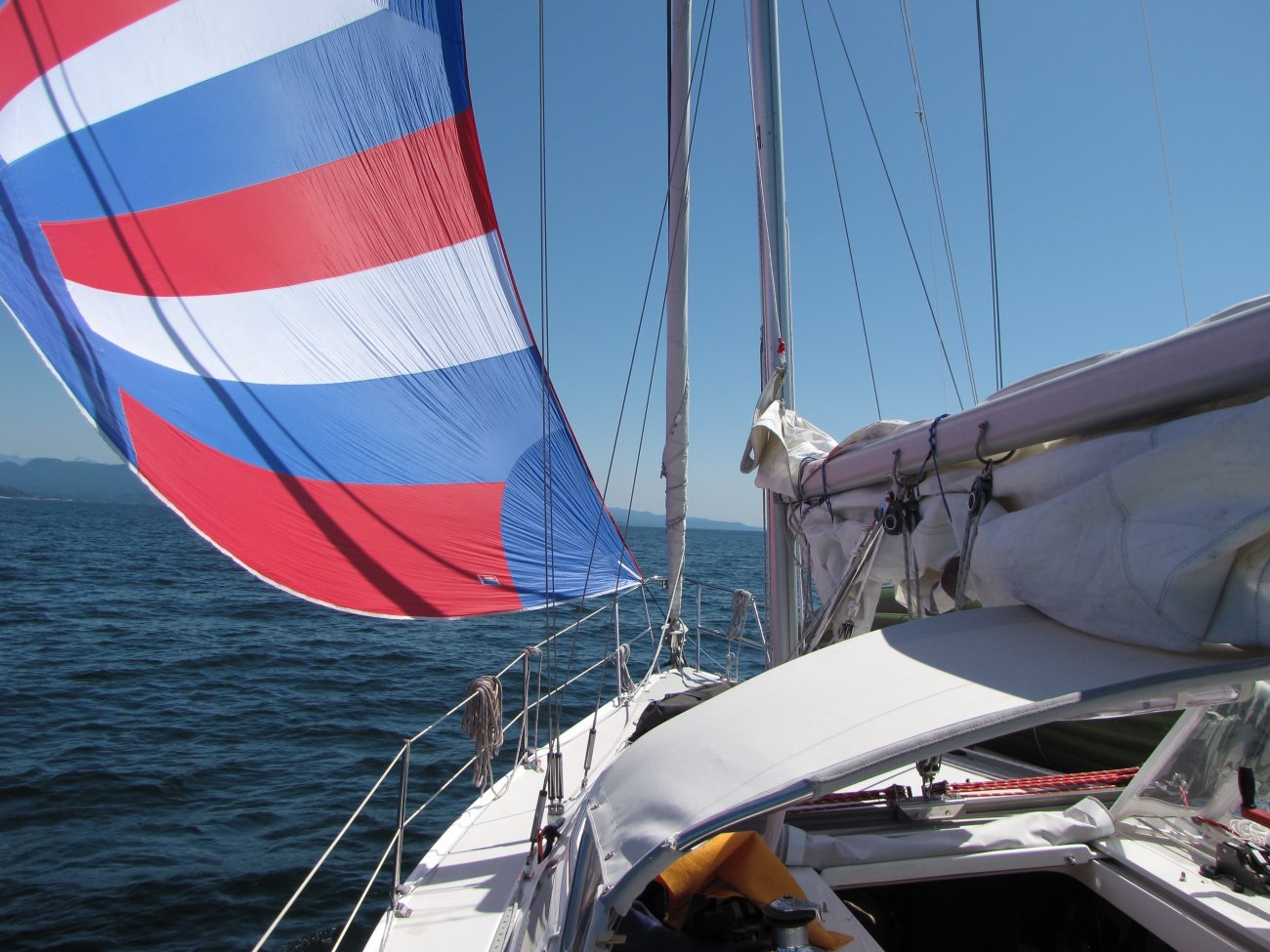

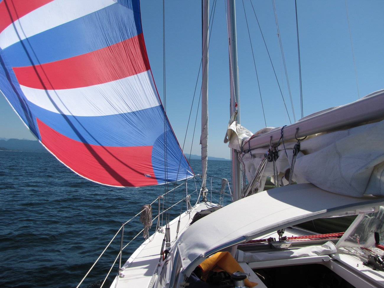

Love it @paulj but not exactly light wind day to me! I see in the video you have something rigged in front of the Geny, what is it?
paulj
Mar 16, 2007
1,361
Catalina 310 Anacortes,Wa
A asym on a RollGen. One picture shows it unfurled.
I use the asym only on winds 12 knots or less.

oh, that link only showed me a video of a crossing on the jib only, I see an attached picture now:) Looks cool, why is your main under the boom?
