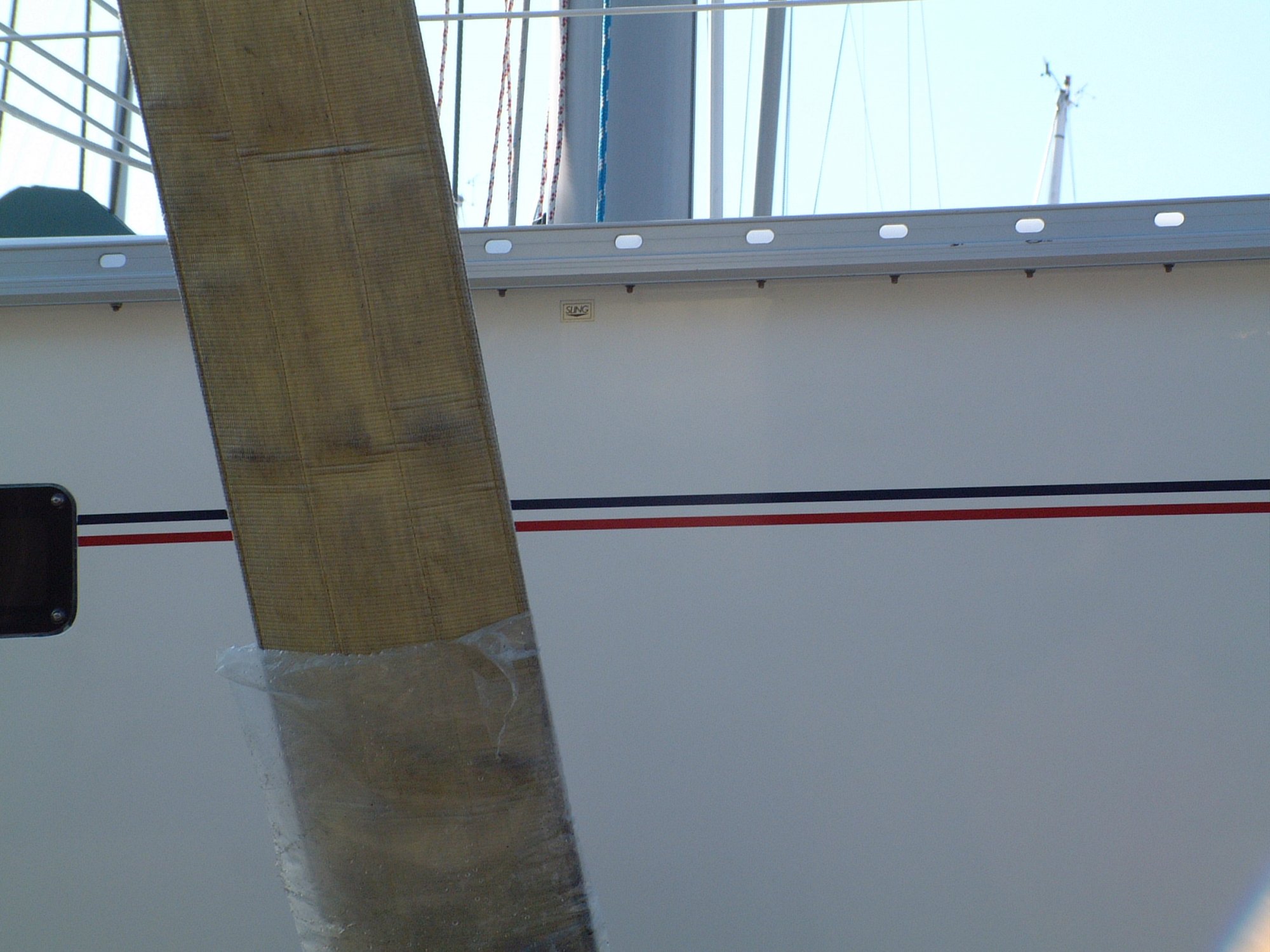

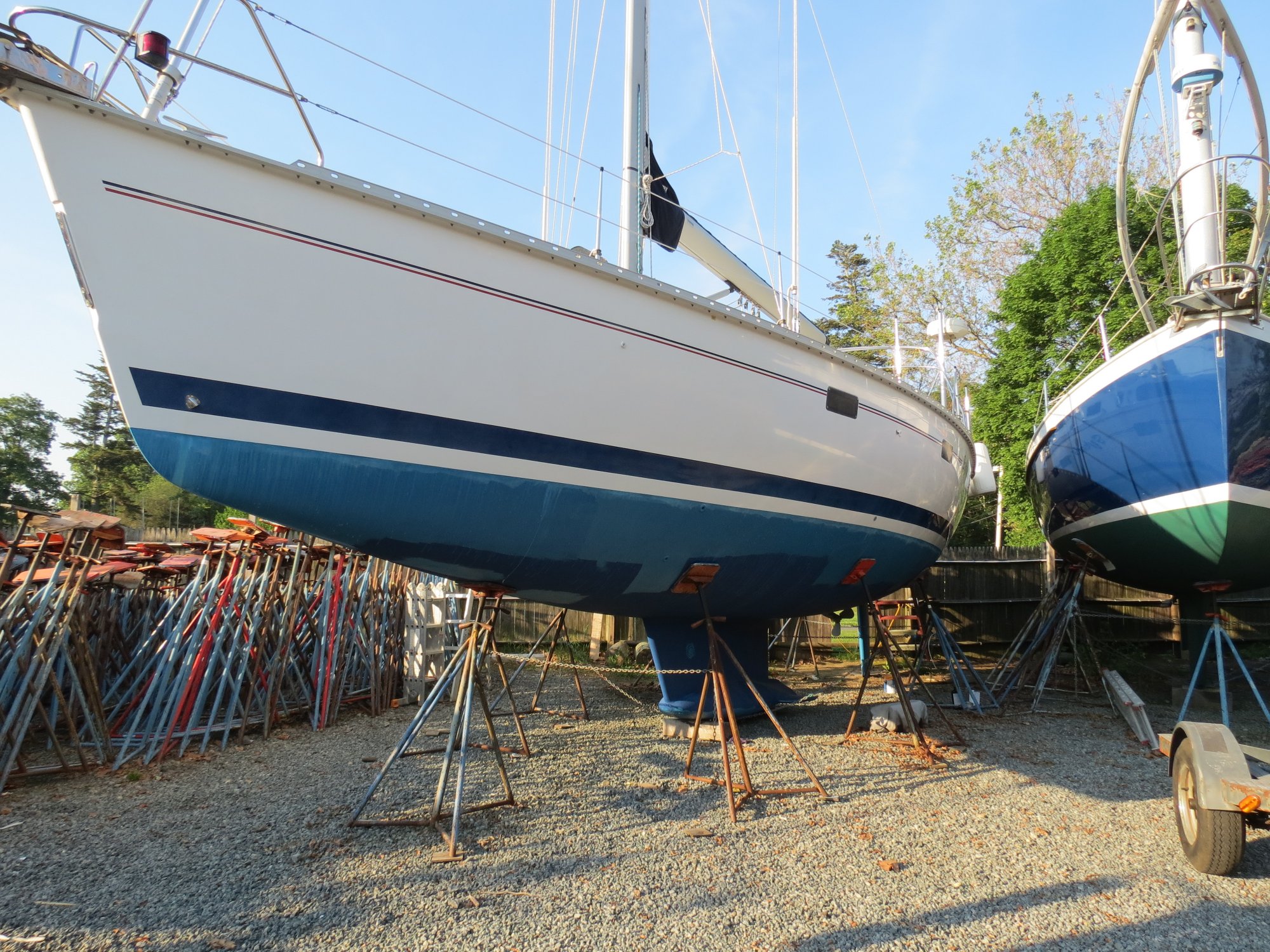

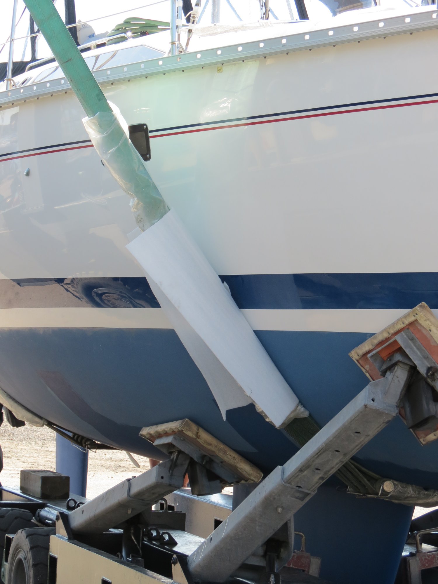

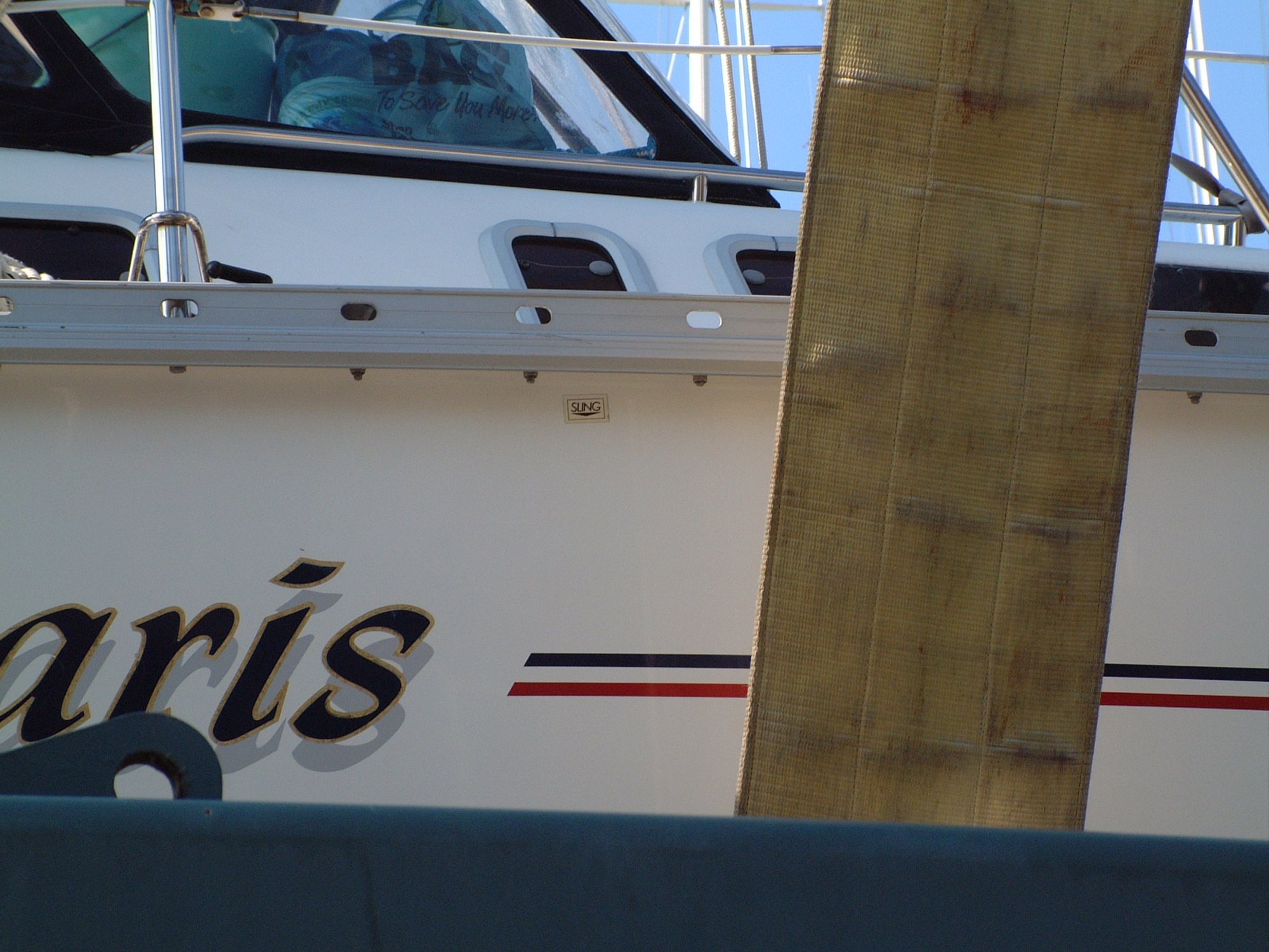

My hull was repainted and the sling points are no longer marked on the hull. I"ll be going into the yard in January.
Does anyone have the locations for the sling available. If you could give me a reference like X Ft Y Inches aft of the miship cleat centerline or some such other easily identified point I'd appreciate it very much. A picture would be fine too.

Here are a couple pictures. You can count the toerail holes from the stantions to locate the correct points. The important location for the stern sling is that it DOES NOT go under the keel. It must go around the hull.
