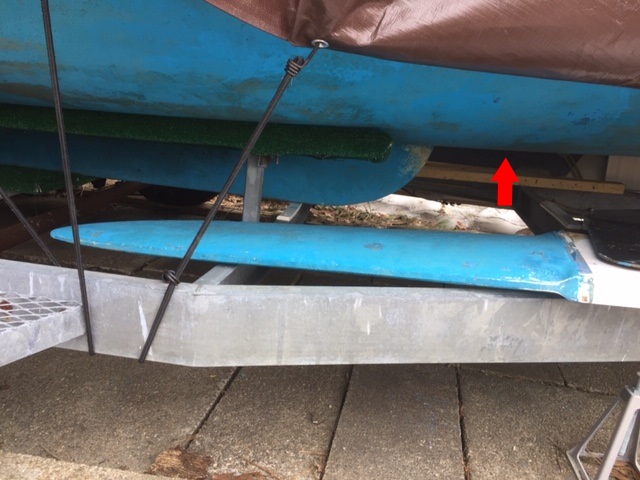

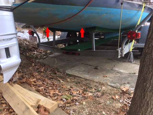

Hello,
I was wondering if someone may be able to lend me some guidance to lifting my Hunter 26? I need to lift the boat to drop the centerboard, and to paint the bottom... But I am concerned about the ballast tank, and don't want to lift it in the wrong spot creating more problems...
My thought was to raise the boat with 4 boat stands. I can fit the stands both fore and aft of the trailer bunks. I have attached 2 pictures of where I'd like to position them.
Could someone please let me know their thoughts on this matter, and whether I might be compromising the ballast tank or hull?

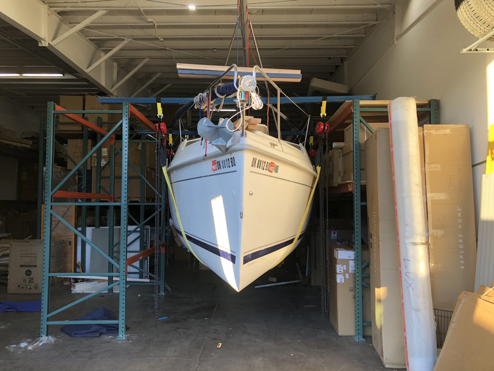

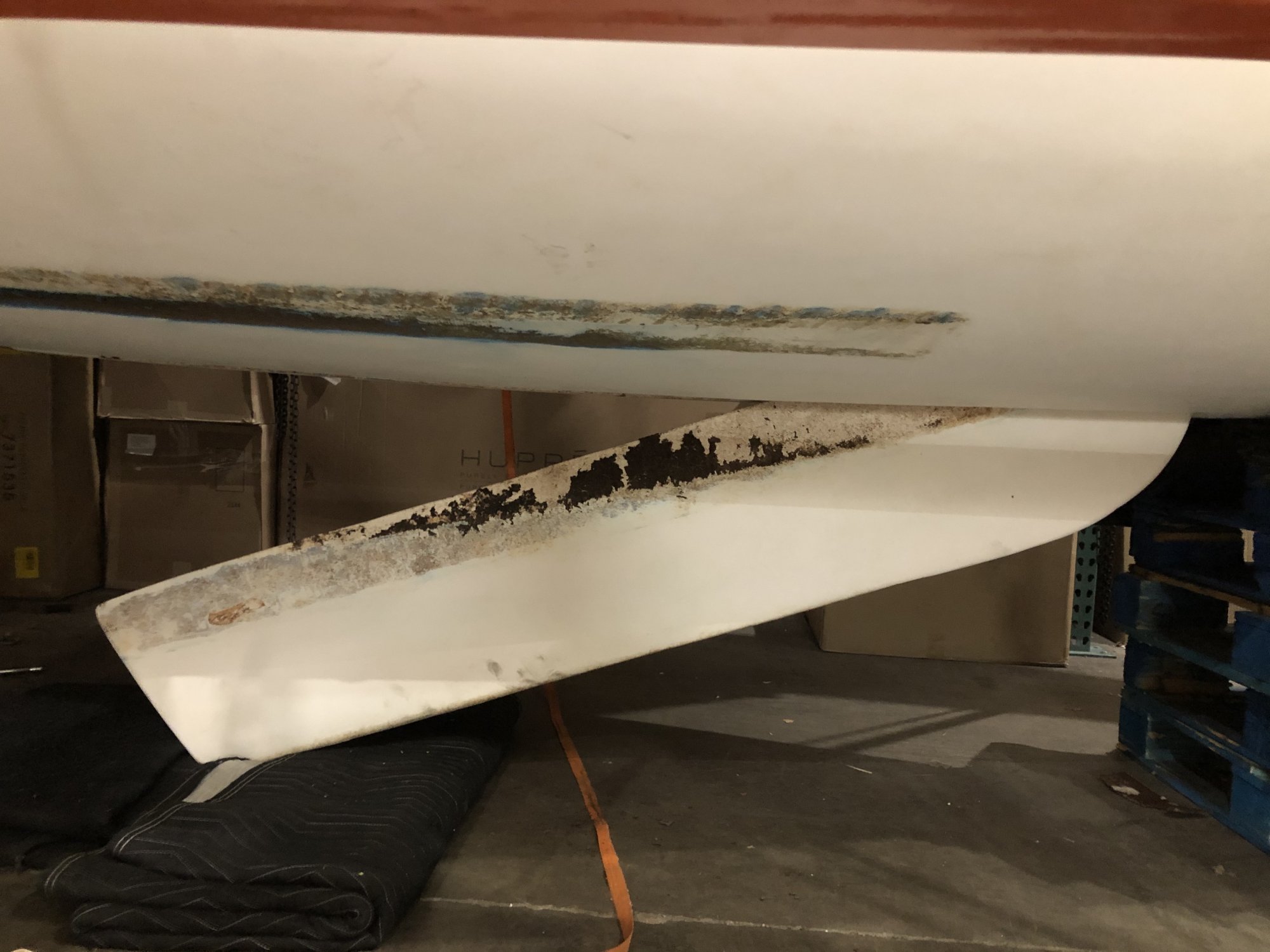

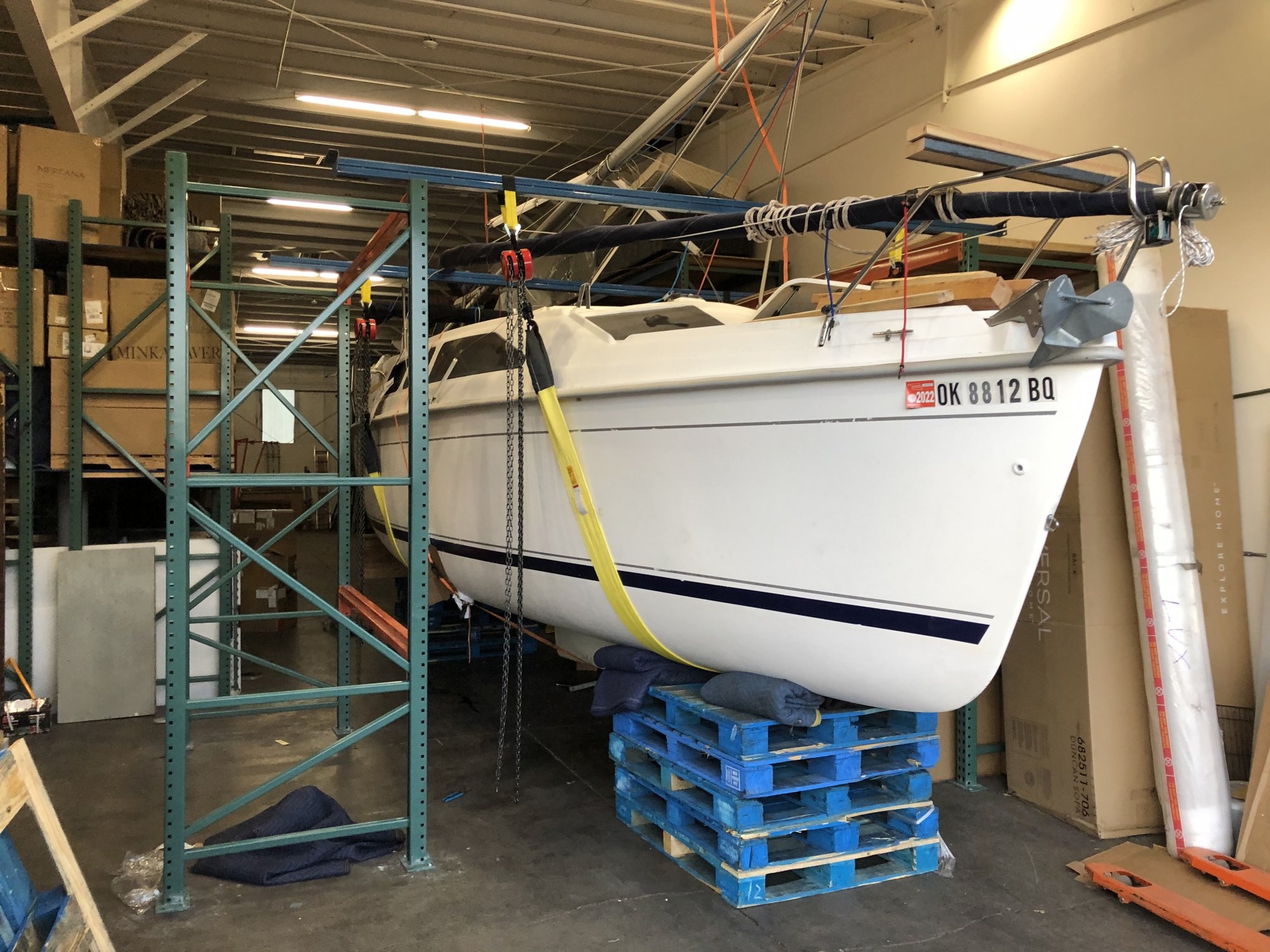

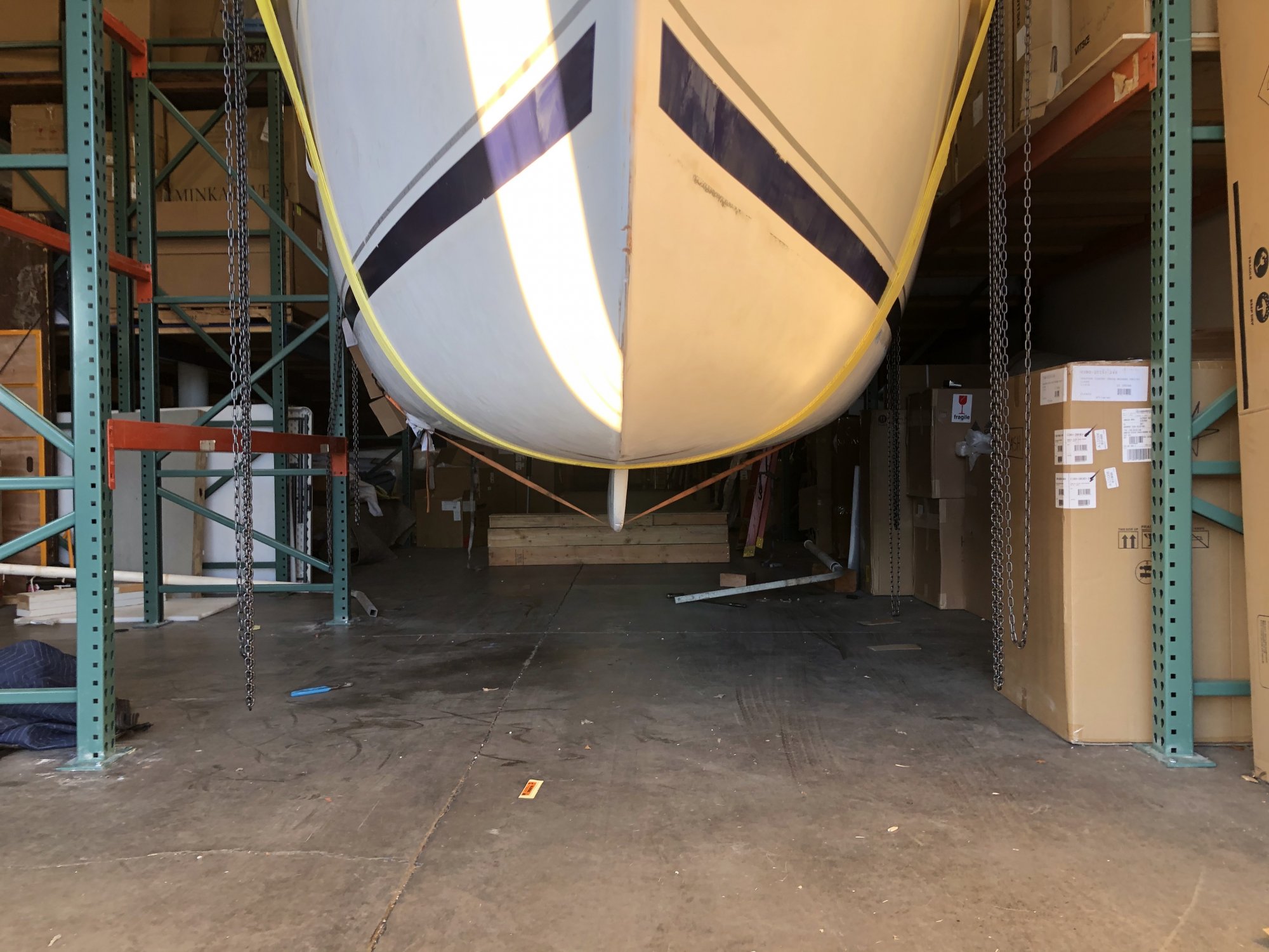

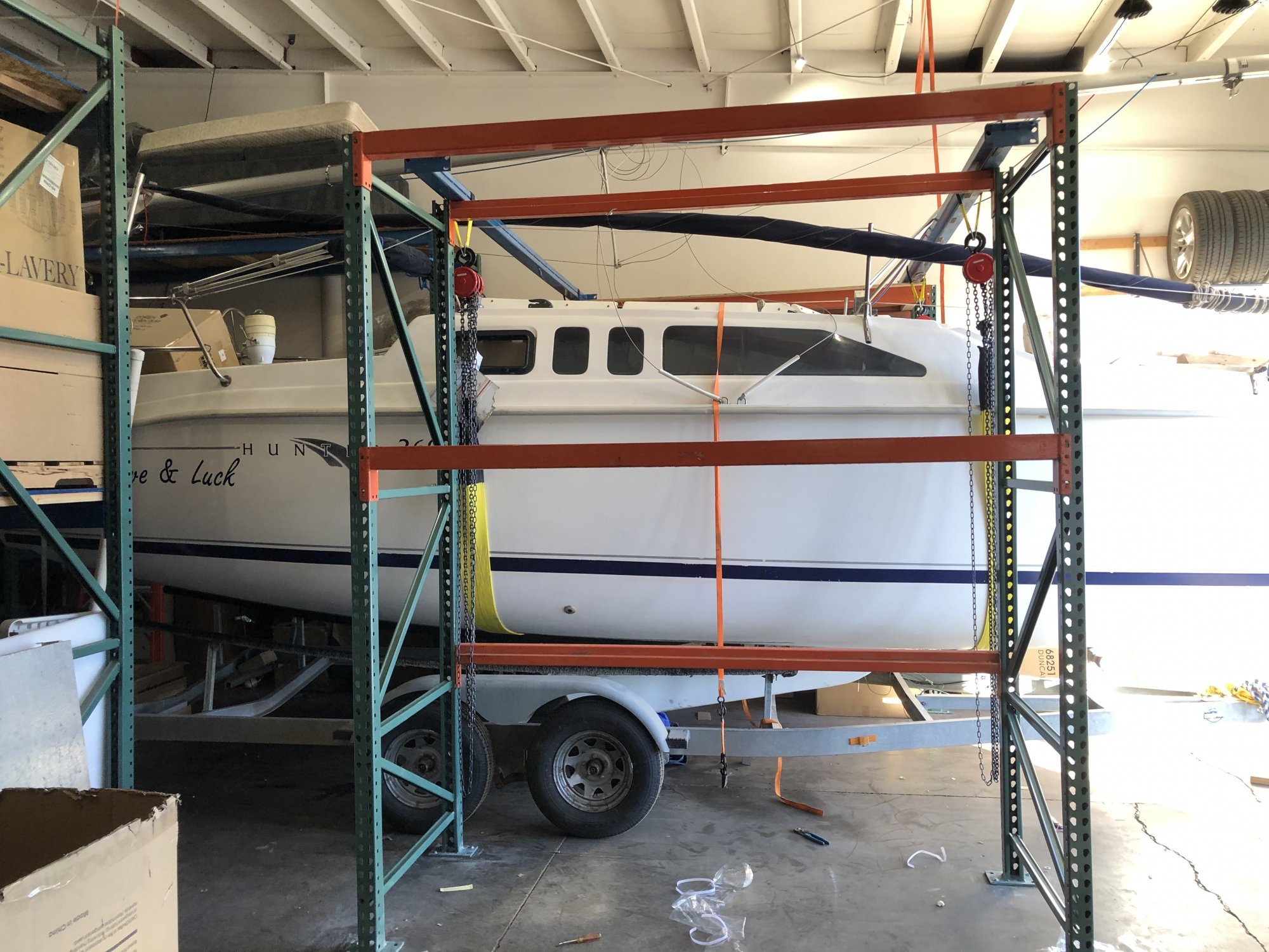

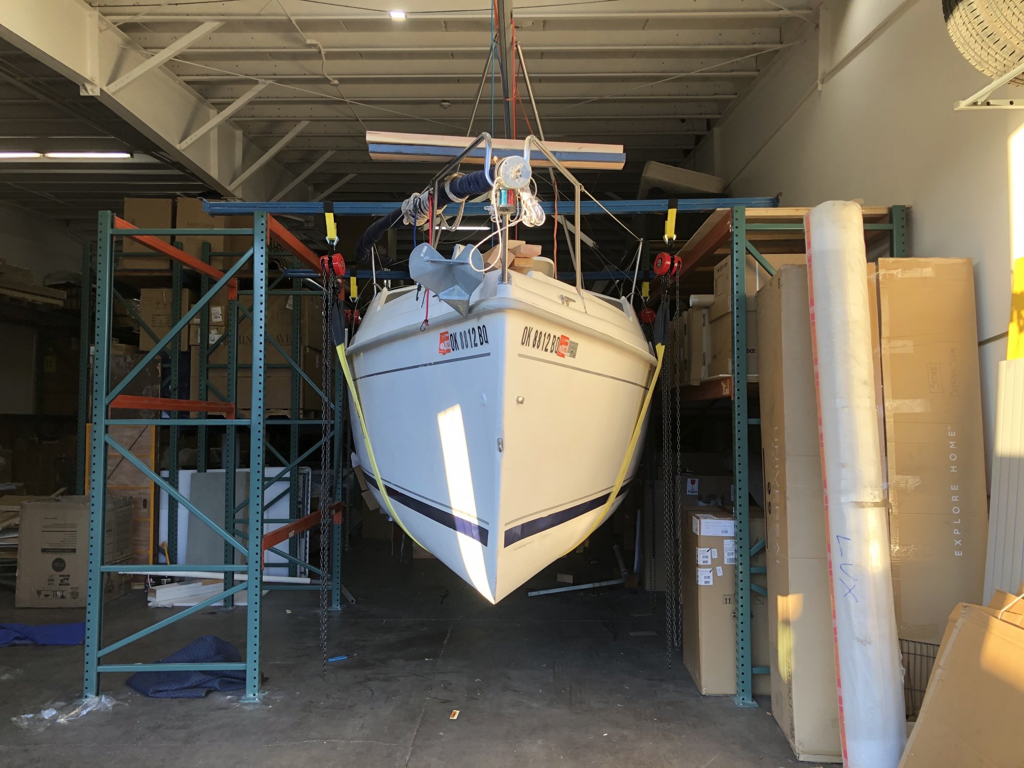

Just wanted to give an update on lifting the H260 off the trailer. . Here in Tahoe the marinas don't seem interested in lifting without charging an arm and three legs so I needed a way to do it safely so I could spend some time on the hull.. I lifted this off myself today. After thinking about the best way to do it I used pallet racks spread 9ft apart along with 2 X 6 inch, 14ft long flat lifting slings and 4 X 4000lbs chain blocks. (probably could have gotten away with 1/2 this size chainblock.)
The first step was positioning the 10ft high pallet racks and securing them to the concrete using concrete anchors. After that, setting up the rigging under the two lifting locations (defined with stickers on the hull) which are about 8ft apart. Lifting up the stern with a car jack was necessary in order to get the flat sling between the bunks on the trailer and the hull. I used 12ft steel spreader beams (pallet rack beams) between the two racks so I could get a vertical lift but I am not sure that is necessary provided that the racks are anchored to the concrete and positioned close to the boat. A small 12 inch sling wrapped around the beam then connected to the chain blocks at the top.
The chain blocks very easily lifted the boat nicely. I could tell that the stern is far heavier than the bow as there was slightly more resistance on the stern chain blocks. Once lifted, I could then remove the trailer from under the boat. After doing so, I placed some heavy duty pallets fore and aft of the slings and placed moving blankets on the pallets to lower the hull onto. I then lowered about 40% of the weight onto the pallets leaving the rigging/ pallet racks supporting the remainder. Total expense was about $600 in rigging gear. Took about 2hrs on my own from start to finish. Today I will remove the centerboard and replace the hoisting line. Can now also work on the trailer easily.
