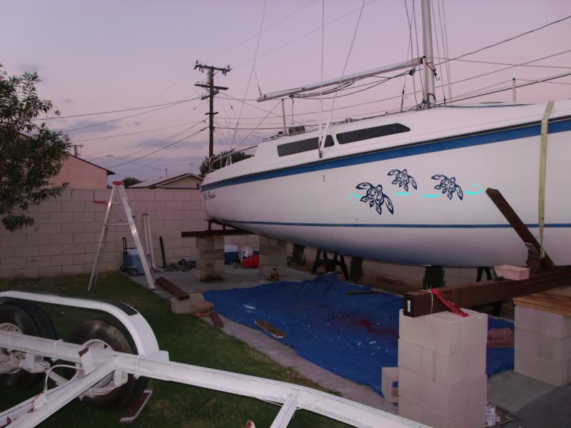

Not only did I need to paint the boat bottom but I needed to do a lot of work on the trailer so I removed the boat from the trailer entirely. I welded up some C-channel in a V support to match the bow and stern as seen in the photos. I then proceeded, like Doc said, by lowering the trailer jack as far as it would go. Then I stacked cinder blocks in off-set sets of two to make a 16" square tower at each side. (Make sure the hollow part is vertical for strength and never use just a single stack.) I then placed the V-support on top of the cinder block and padded both the boat and the cinder blocks with wood. THen I raised the jack as far as it would go and did the same under the bow. This raised the boat above the trailer far enough to paint the bottom. I continued raising and lowering the jack and adding 2x6 spacers above the bunks until the boat was high enough to remove the trailer.

Jul 29, 2010
1,392
Macgregor 76 V-25 #928 Lake Mead, Nevada
Did you set the concrete block wide enough to roll the trailer out, or did you jack step it? Did this years ago. Time to do it again. Thanks for the pics.

Sep 25, 2008
961
Macgregor & Island Packet VENTURE 25 & IP-38 NORTH EAST, MD
Yes, blocks were just wide enough to clear widest part of trailer. I built an A-frame across the bow, put a wide piece of webbing under the boat and used a come-along to lift the boat high enough to slide the trailer out.

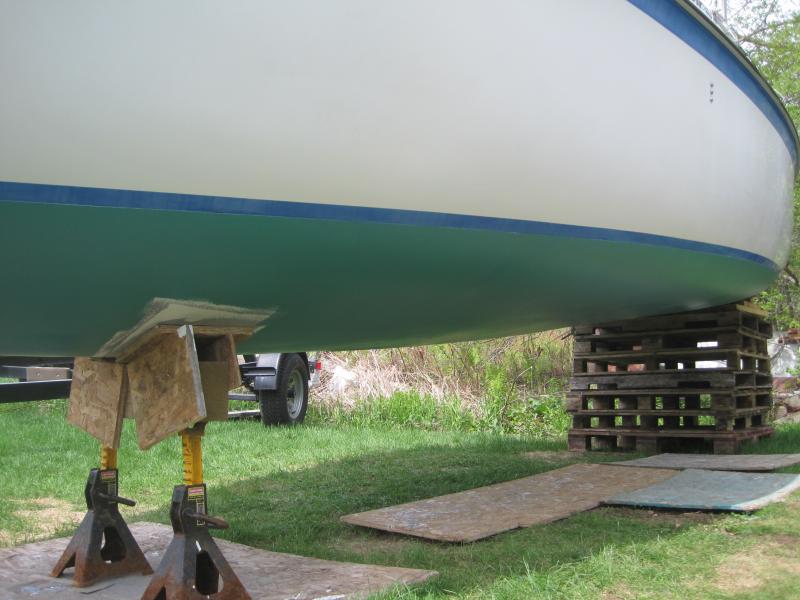

I did pretty much the same thing everyone else did, couple of weeks ago to drop the keel and replace the trailer bunkers.

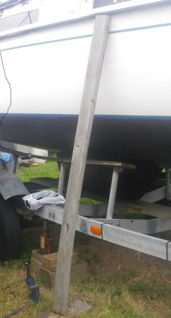

I know this is an old post but maybe some one else can use the info.
I have not tried this my self but have seen it done.
Just jack the boat trailer up about mid ship boat and all. Cut 2 2x4's to prop under the rub rail at a slight angel away from the boat. then lower the jack as needed to get a gap big enough to get your paint roller in where you need it. ( NOT YOUR HAND) just in case. trick from my old friend charlieJ!! his picture too.
Jun 10, 2013
101
macgregor 22 Grand Lake, Oklahoma
Man I don't know what kind of rub rail he has but I sure would not even want to think about something like that on my 22....that's crazy!
