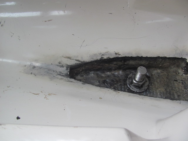

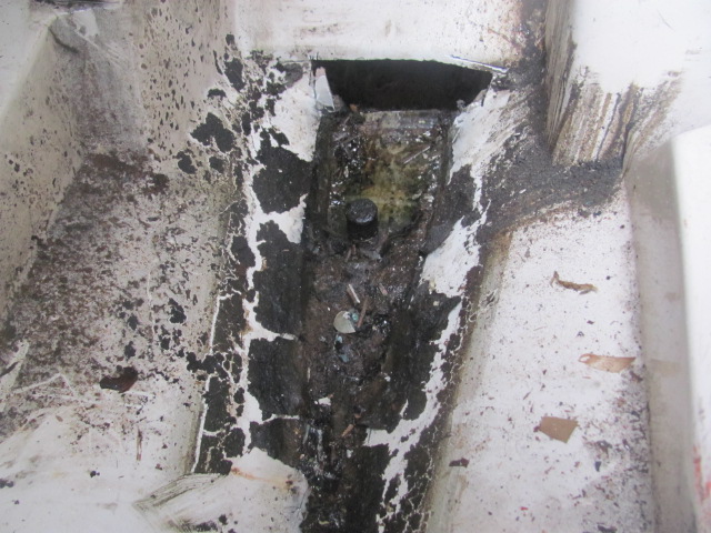

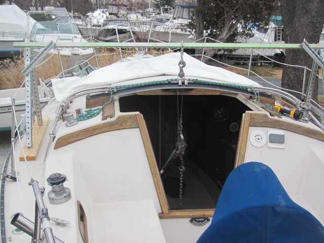

I am in the process of removing the plywood in the bilge floor and the last keel bolt is under the engine. I read about Ron Hill's lift to change his motor mounts, but he's got a Catalina 34 and, he used his boom. My mast is down.

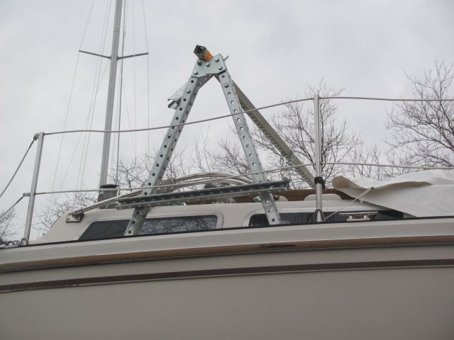

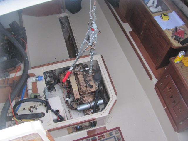

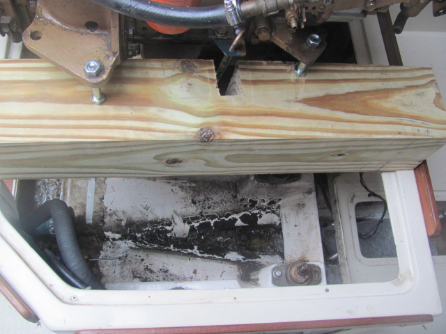

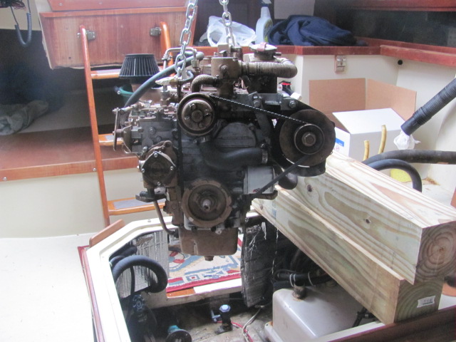

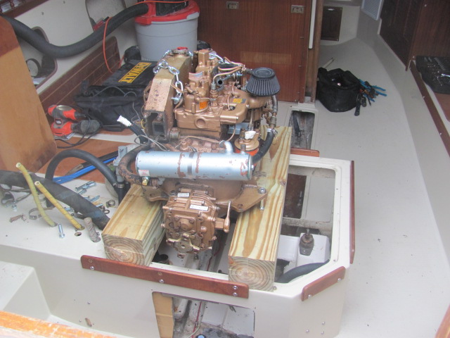

Anybody here done a M-25 on the 30? I'm actually going to lift it and then set it on a wood frame spanning where the sink cabinet would be, over the engine compartment. This will give me clearance in the area and the time to do the bilge work.

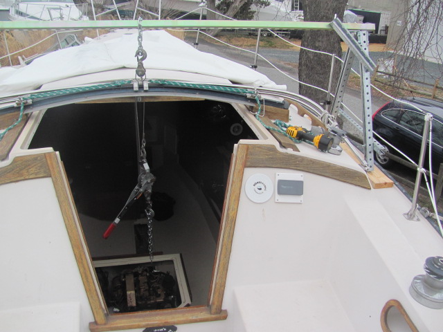

I've read about people laying a 4x4 over the companionway, but I think I want to spread it further out to the toe rail where there is more boat structure. My concept is a gantry so the beam clears above the handrails and winches, but I don't want to overthink it if somebody else has done it before, in a simpler way.
