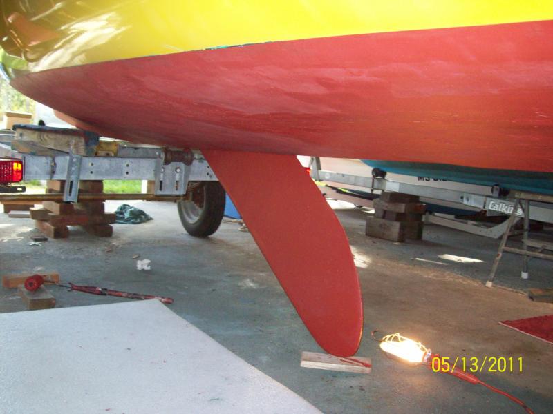

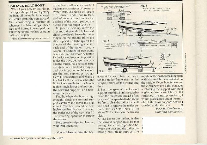

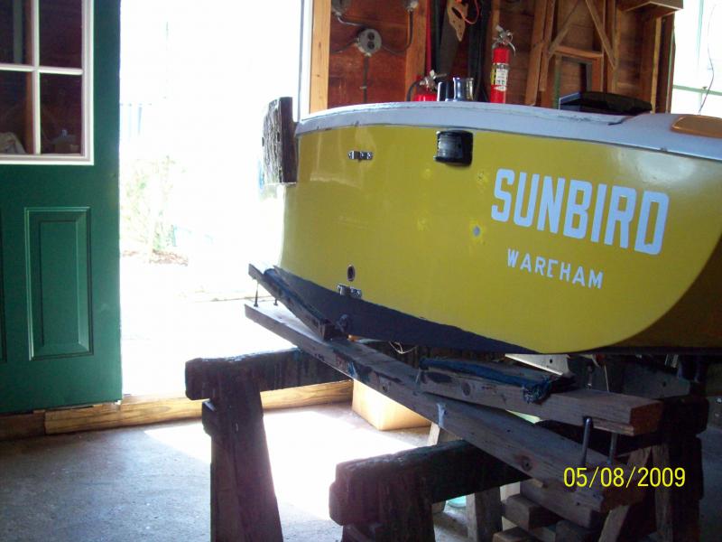

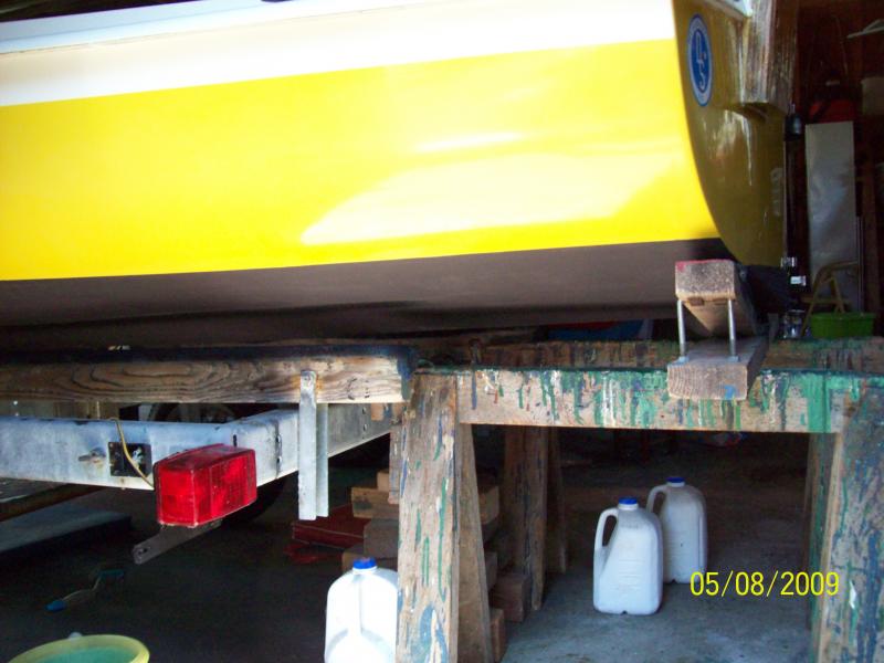

I have added a scan of an old Small Boat Journal article showing the basics of how I move my boat partway off the trailer. Also some pics of how this looks. I use the tongue jack on the trailer to do most of the jacking up.
