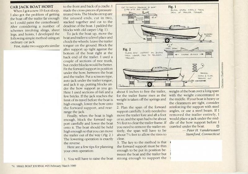

Here is basically how I lift my DS II off the trailer for painting the bottom, would seem to work to switch trailers as well.
