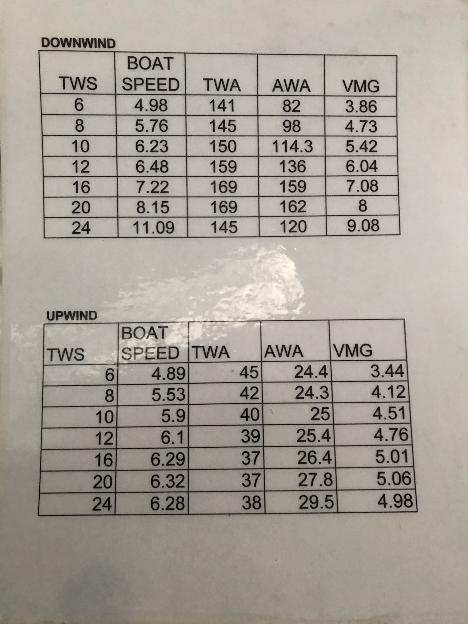

My boat in 8 knots with A1.5. 8knots true is where we are competitive on w/ls. At 10 knots the symmetrical boats are 10-20 degrees lower and we have troubles. A 323 doing 6 knots VMG downwind in 8 knots?? Does it foil? Check the target speeds on the attached sheet for a J/92. Very close to real world speeds except at 18 knots and above where boats speeds are in the teens.

J/88 - ok! I mistakenly posted targets for class 105% job and 80 sq mtr spinn. I race with a 155% jib in 6knots and have 5.7-6kts boat speed at 25-29 degrees apparent. Downwind the spinn trimmer drives the boat. It is all about maintaining pressure so apparent wind angle fluctuates a lot.
